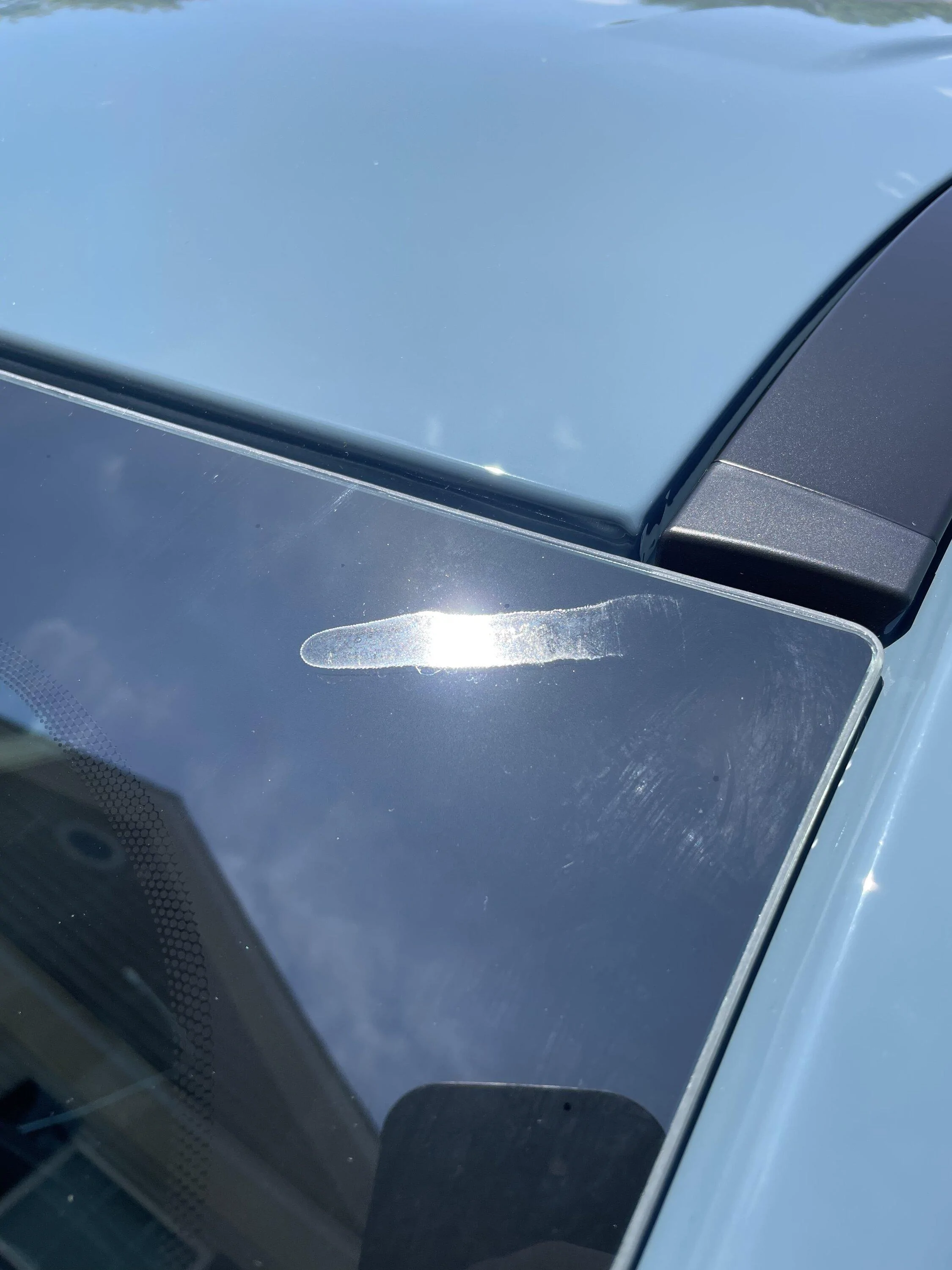

Picked up my Maverick a few weeks ago. Just noticed this under my windshield. Thought it was dirt at first but it won’t wipe off. What does this look like and I’m assuming it’s under warranty?

Looks like it is de-laminating between the black layer and the glass. I can't imagine it would NOT be covered under warranty.

If you can't clean it off on the outside nor on the inside, and there are no obvious signs of impact damage (cracks, etc.), use your warranty.

Agreed ASAP before you get a chip!!!

However, Beware the mysteries of proper windshield replacement. Assure they know what they are doing.
