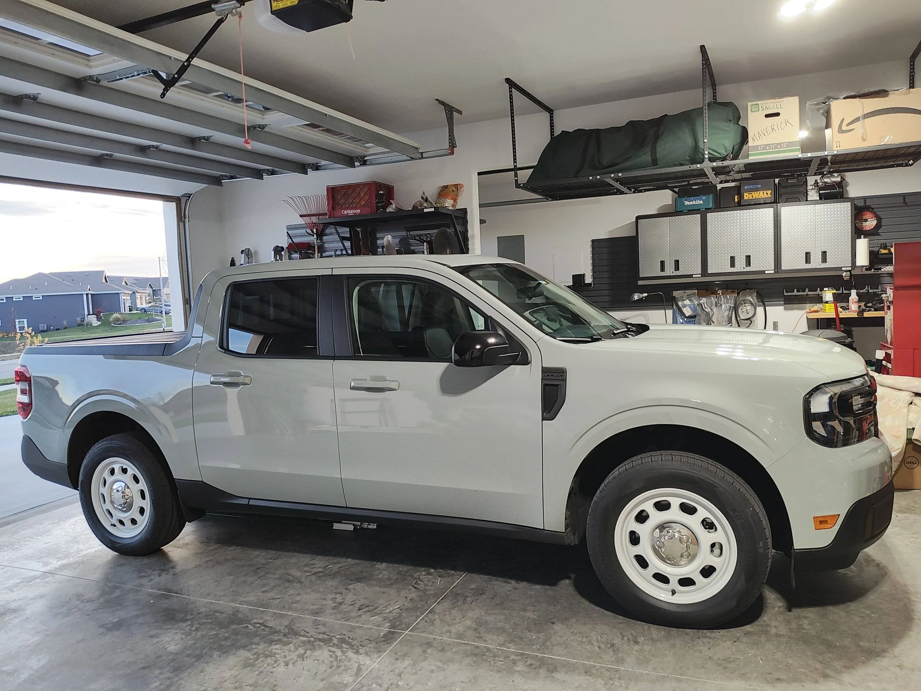

I got rid of the Lariat BAP wheels and went with these. . .
Ford Maverick Bronco Sport Wheels with Interceptor Dog Dish Hubcaps Bronco Sport + Dogdish

WOW Super sharp...

Like the look of these. Maybe look into these for mine but maybe a different color. Thanks for the share.

Yeah, I was going to have the wheels powder coated gunmetal gray, but my local powder coating shop doesn't do wheels anymore. I'm okay with the white for that 60's-70's F-100 vibe. . .

Looks nice! How is the fit with the hubcaps? Did you have to modify them?

The hubcaps are the stainless steel version that have five "fingers" that clamp against the lug nuts, I needed to bend the fingers in a bit for the smaller diameter Maverick bolt circle and roll the tips.
I also dabbed pea-sized blobs of RTV onto each finger before popping on a hubcap as extra security.
I bought new interceptor caps since I had no luck finding clean used versions and at $50 a pop, I'd prefer not to lose one right away.
I'm going to replace the craptastic two-piece OEM lug nuts sometime soon and will go with longer lug nuts for better cap finger grip, but so far, no issues, and I've kinda been trying to purposely sling a cap.
