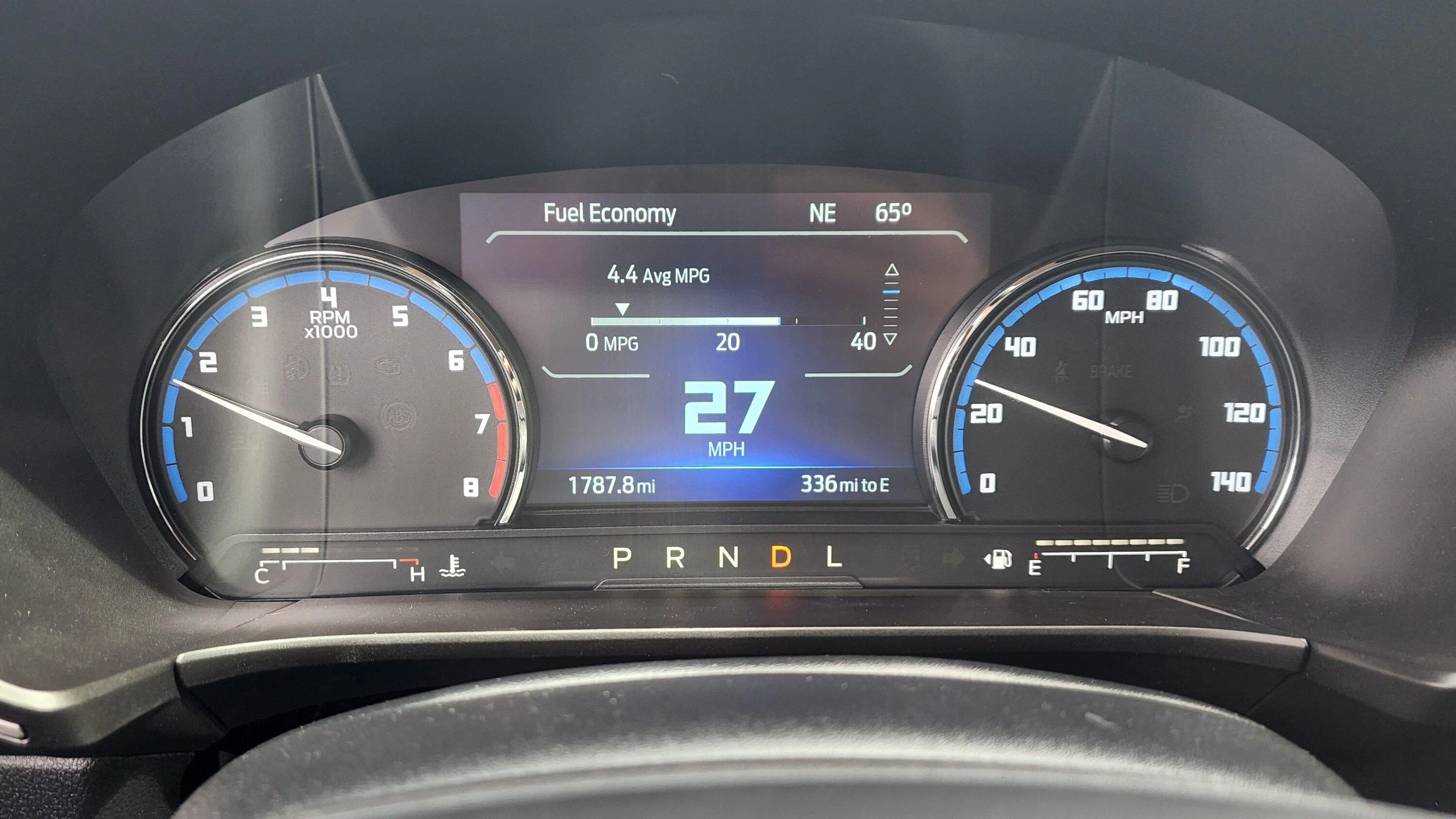

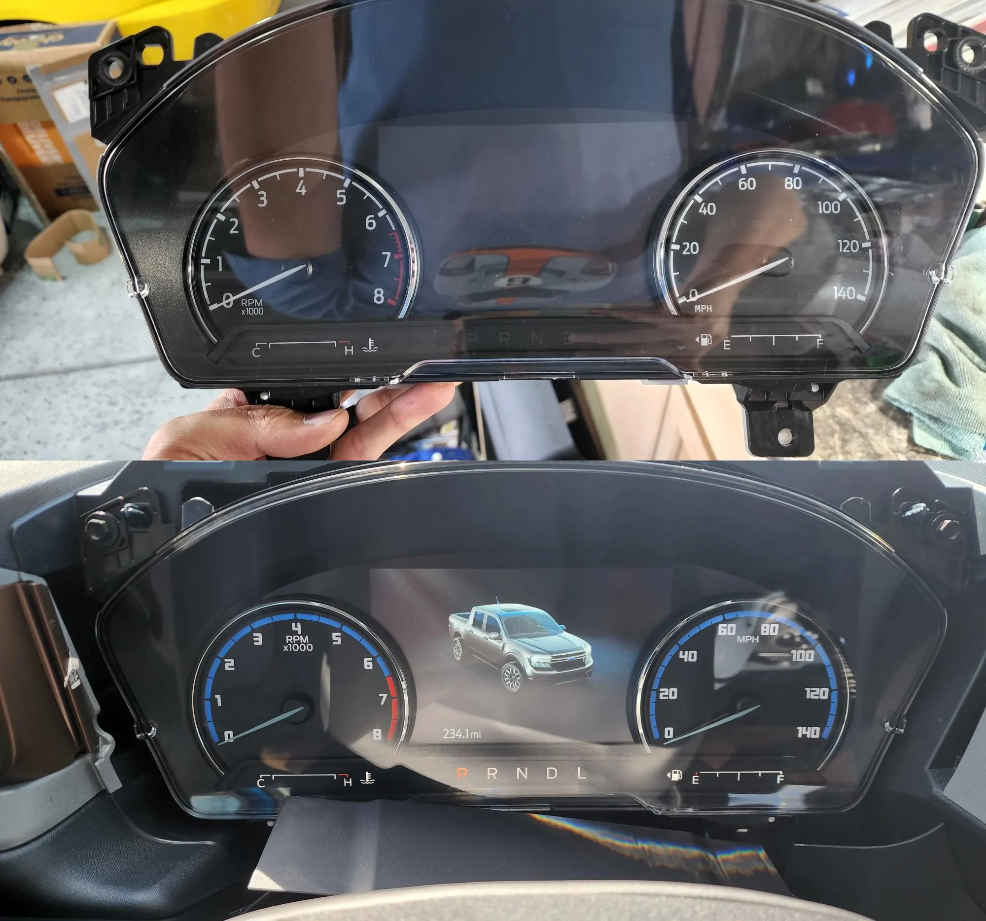

Hey guys,
I took apart a Bronco Sport instrument cluster from an Outer Banks (mid-tier cluster) and swapped the gauge faces into my Maverick. I love the way they look!
Here's a few photos and an install video on how I did it.
Before/After

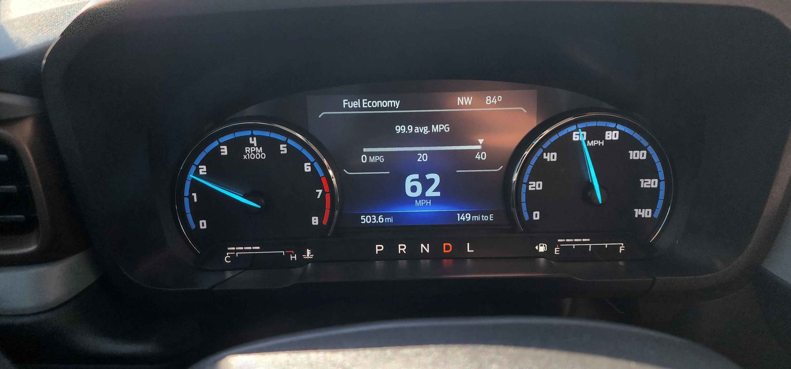

I liked it too, I had the full Bronco Sport instrument cluster in my Escape and I miss the blocky lettering on the screen.
Ford Maverick Bronco Sport Gauge Face Swap 20220409_133009

Sorry if I missed this answer, but that bronco cluster wont just fit into the maverick? Is that why you took them apart?
It will fit, but there's a few reasons I just swapped the face.
1.) you can't adjust mileage down, you can only adjust it up, and the Bronco cluster had 30k miles on it. My truck was brand-new at the time.
2.) the Bronco Sport had all the Bronco images on it during start-up and while driving, and I wanted to keep the Maverick programming with all of the Maverick images.

There are some other operational differences, the pinout is not the same on the BS cluster so not all functions will operate the same.
If anyone is looking for a relatively inexpensive BS cluster as seen in OP's video to make the face swap I have a spare I can part with.
