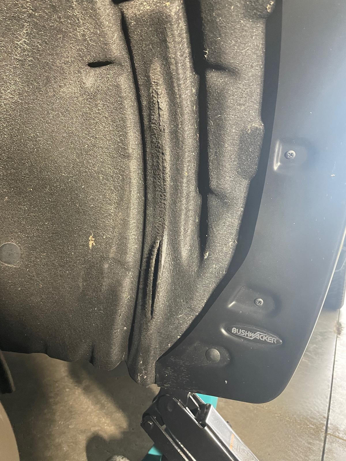

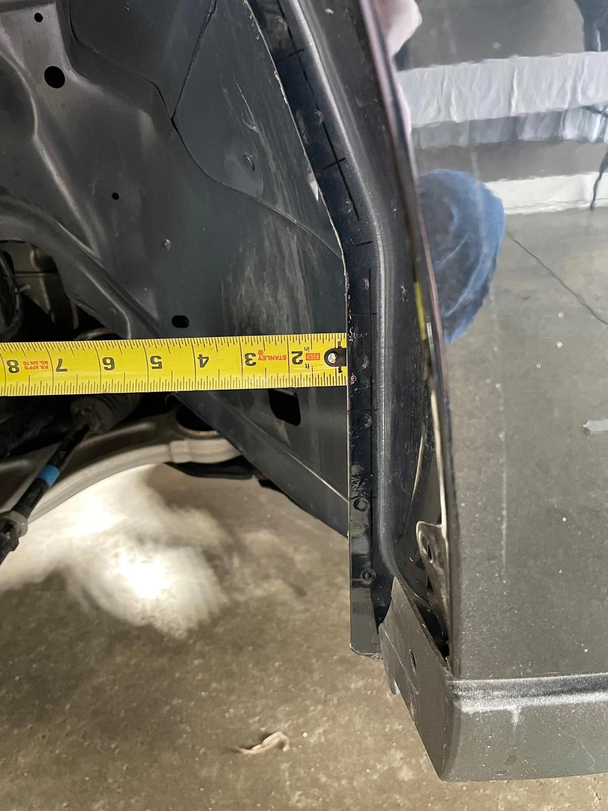

With 21x9's and spacers ... any rubbing anywhere or any needed trimming?
The original setup I had there wasn’t any rubbing (the used tires were pretty worn down). With the new Michelins I am getting rubbing now, when wheels turn about 85%, but it’s all part of the journey of the build, wouldn’t be fun without some challenge. I’m committed to figuring it out, and can update with how I sort it out

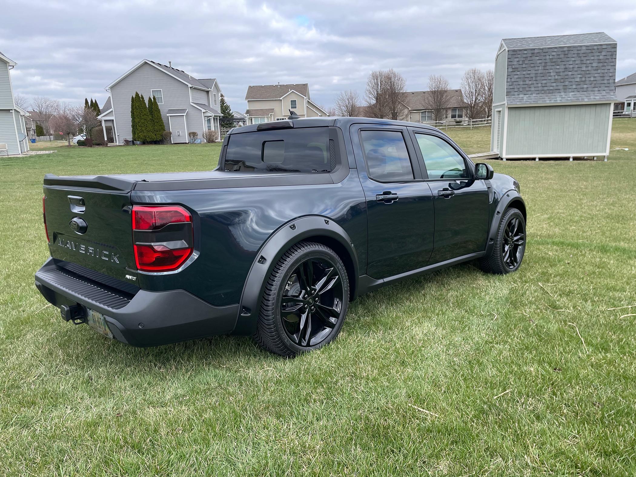

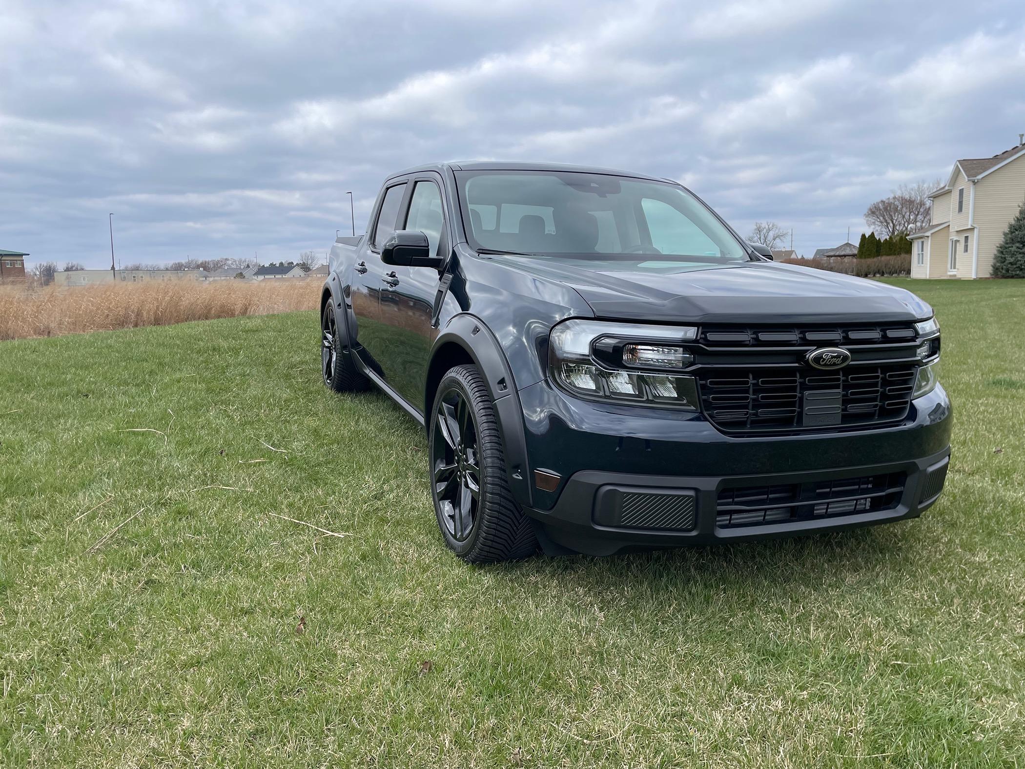

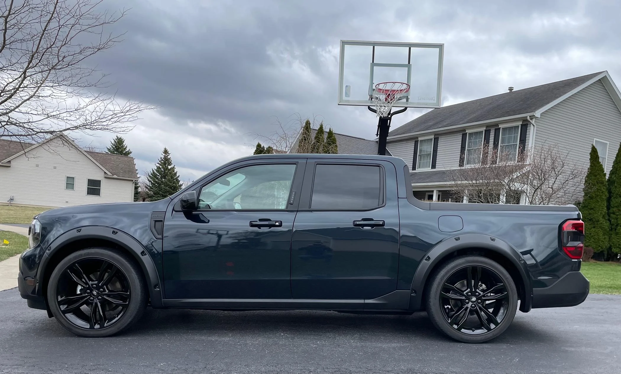

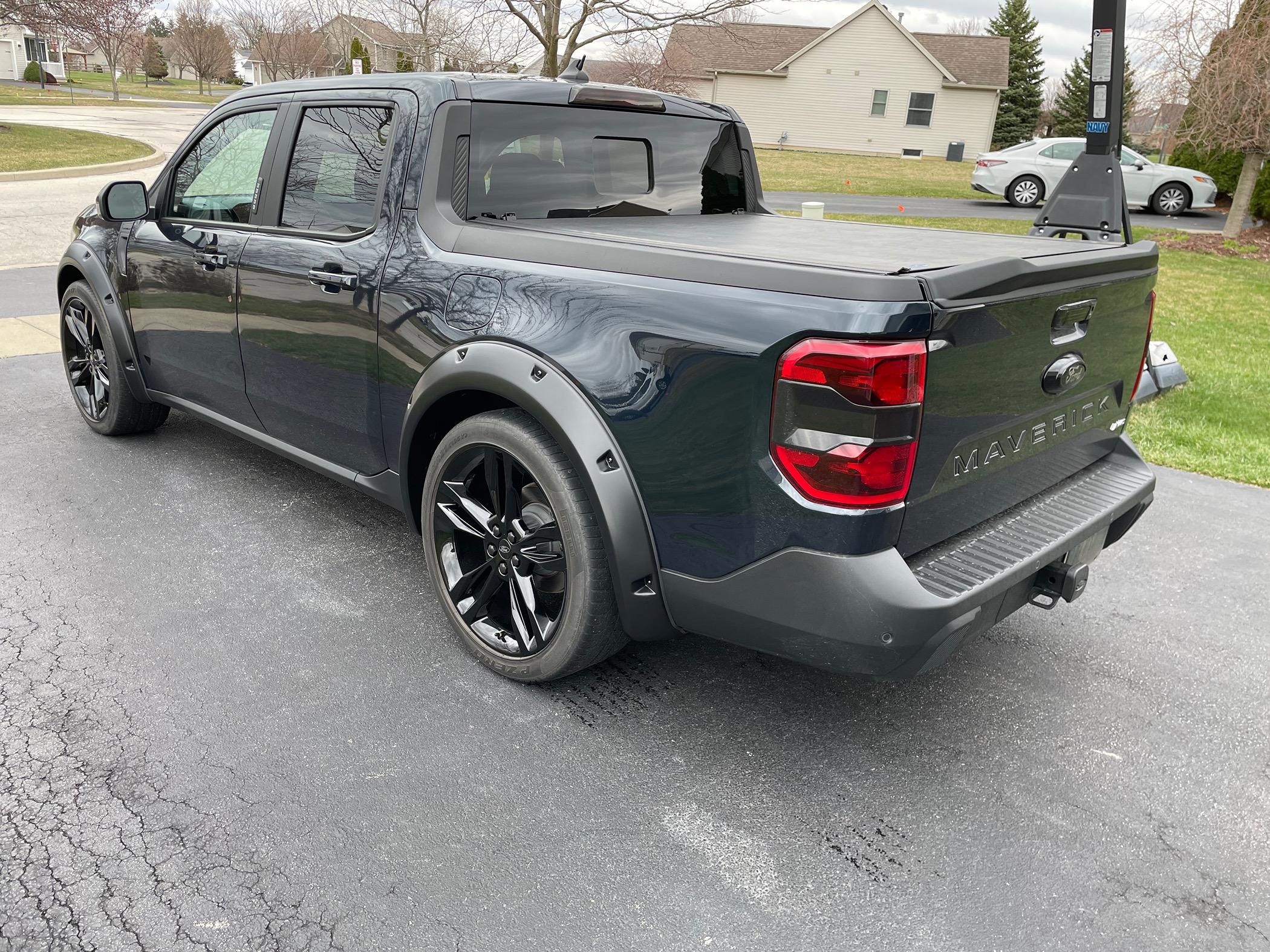

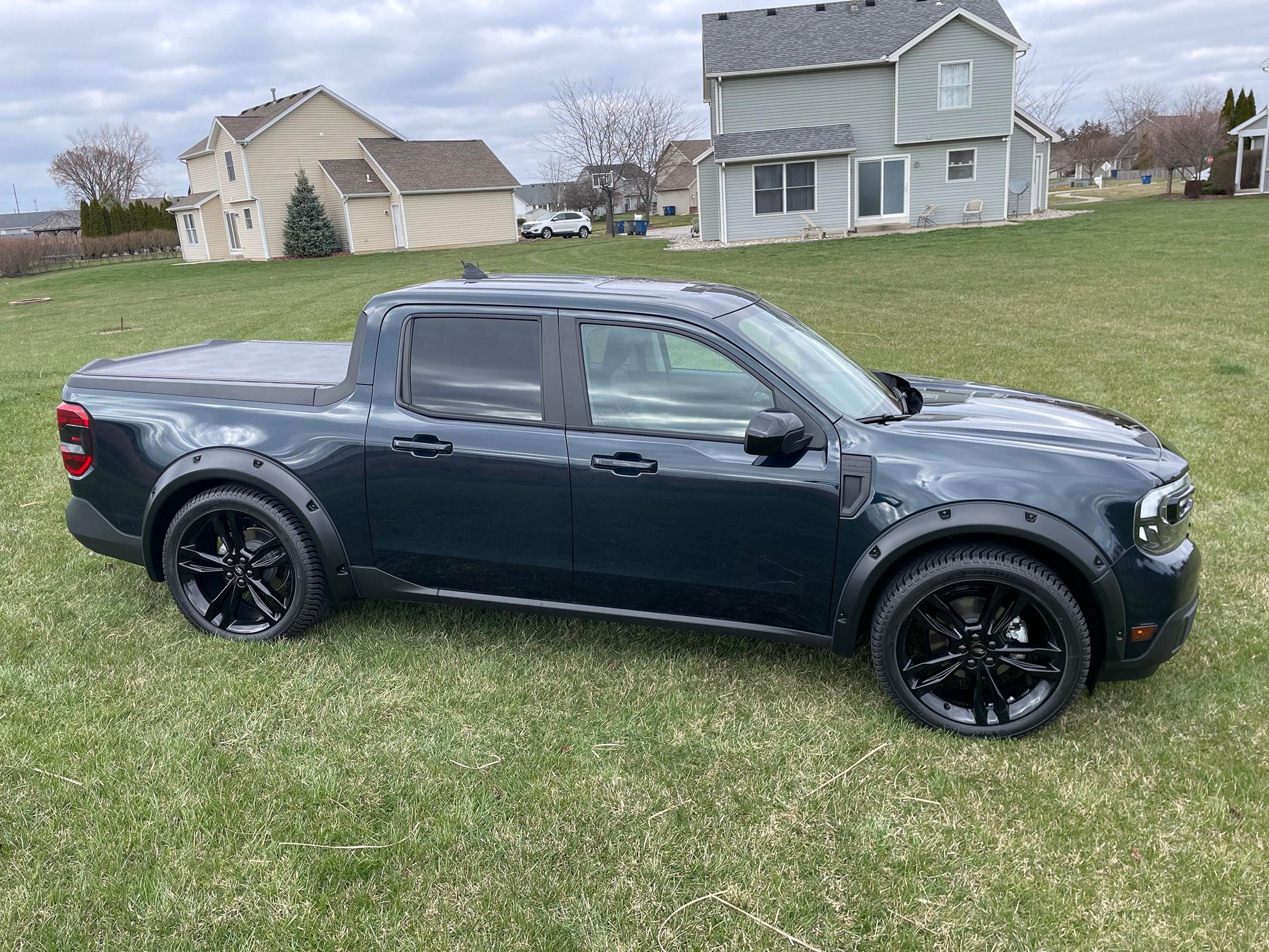

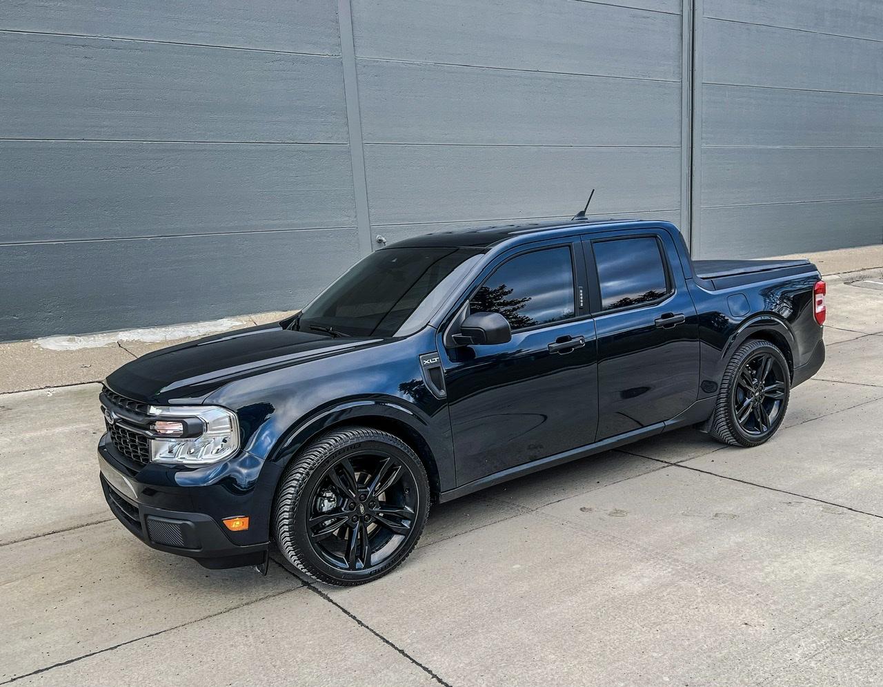

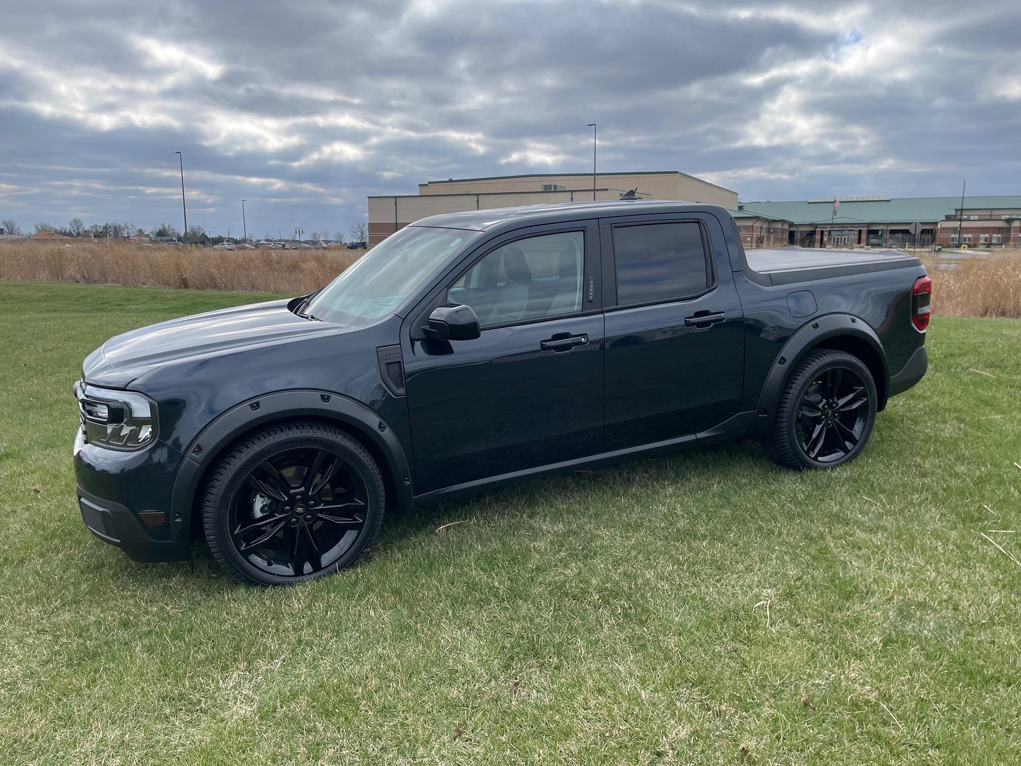

Just finished lowering and widening Bluto. Fresh tires coming soon, but very pleased with the look of the wheels and stance…
New tires and bath. It’s been a fun past few days working in my garage, but now time for a break. This is the first vehicle that I’ve invested my own on time, tools, and hard earned money into transforming beyond the stock trim. Not sure what it is about these funny little trucks, but it all started with our other Maverick we got our son his senior year before going off to the Navy. “Nuke” is just an 2022 Iconic Silver XL AWD EB, but it hooked me (DIY’d OEM cruise control) and I knew I had to get one and build it the way I wanted it so I ordered a 2023 Alto Blue Lariat EB AWD 4K fully loaded.
Bluto Completed Build Installations:
Ford Accessories Front Bug Shield
Ford Accessories Hard Roll Up Tonneau (BAK revolver X2)
Ford Accessories Drop in Bedliner
Ford Accessories Air Design Tailgate Spoiler
Bushwhacker Fender Flares (Smooth, not textured like Ford Accessories, I might paint them still)
Wheel Spacers (1.5” front, 2” rear)
Goodwin Progress Lowering Springs
Ford Edge ST Mag Wheels 21 X 9
Michelin Tires 265/40/R21 CrossClimate2
Tint Covers Taillights/Third Brake/Markers
Piano Black Rear Oval/Tailgate Handle
Bluto Build Installations Planned:
S&B Cold Air Intake
Linvernois Tune
Air Design Front Air Dam
Air Design Cab Spoiler

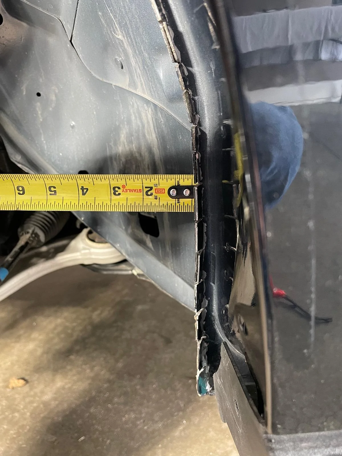

Wanted to update that due to running these wheels with -2” lowering springs and 1.5” spacers in the front, I was getting rubbing. Went the way of the pinch weld mod (cut and bend) to gain an -5/16” clearance where needed. For those considering a similar setup, plan on this step to avoid the hassle and replacement wheel well liners
