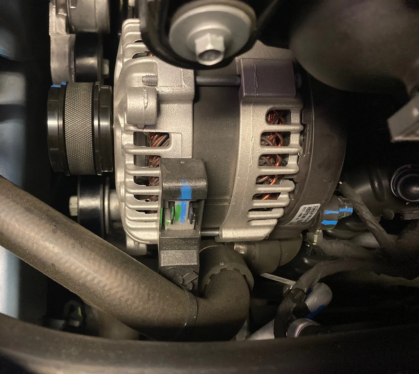

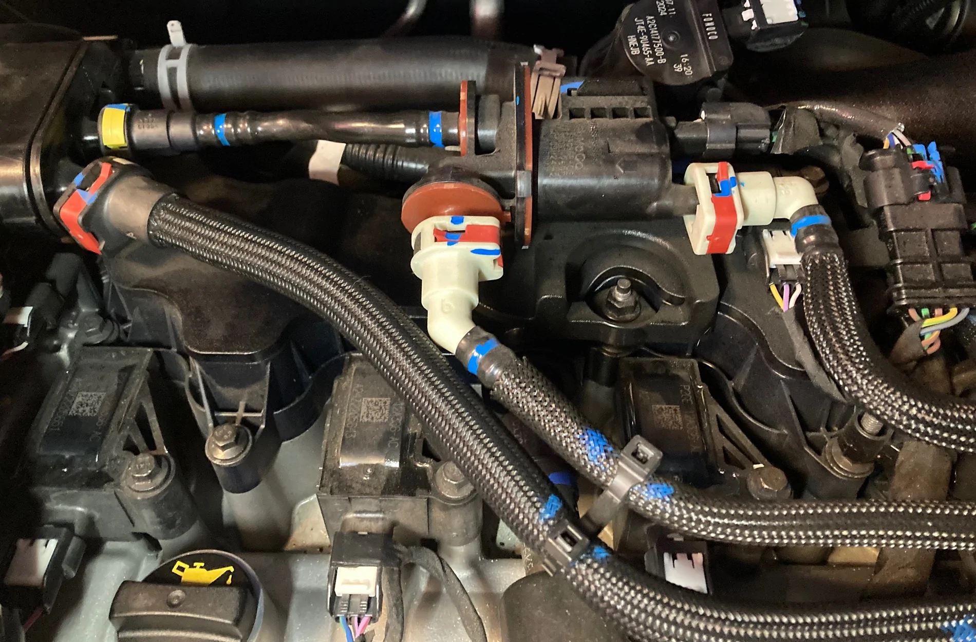

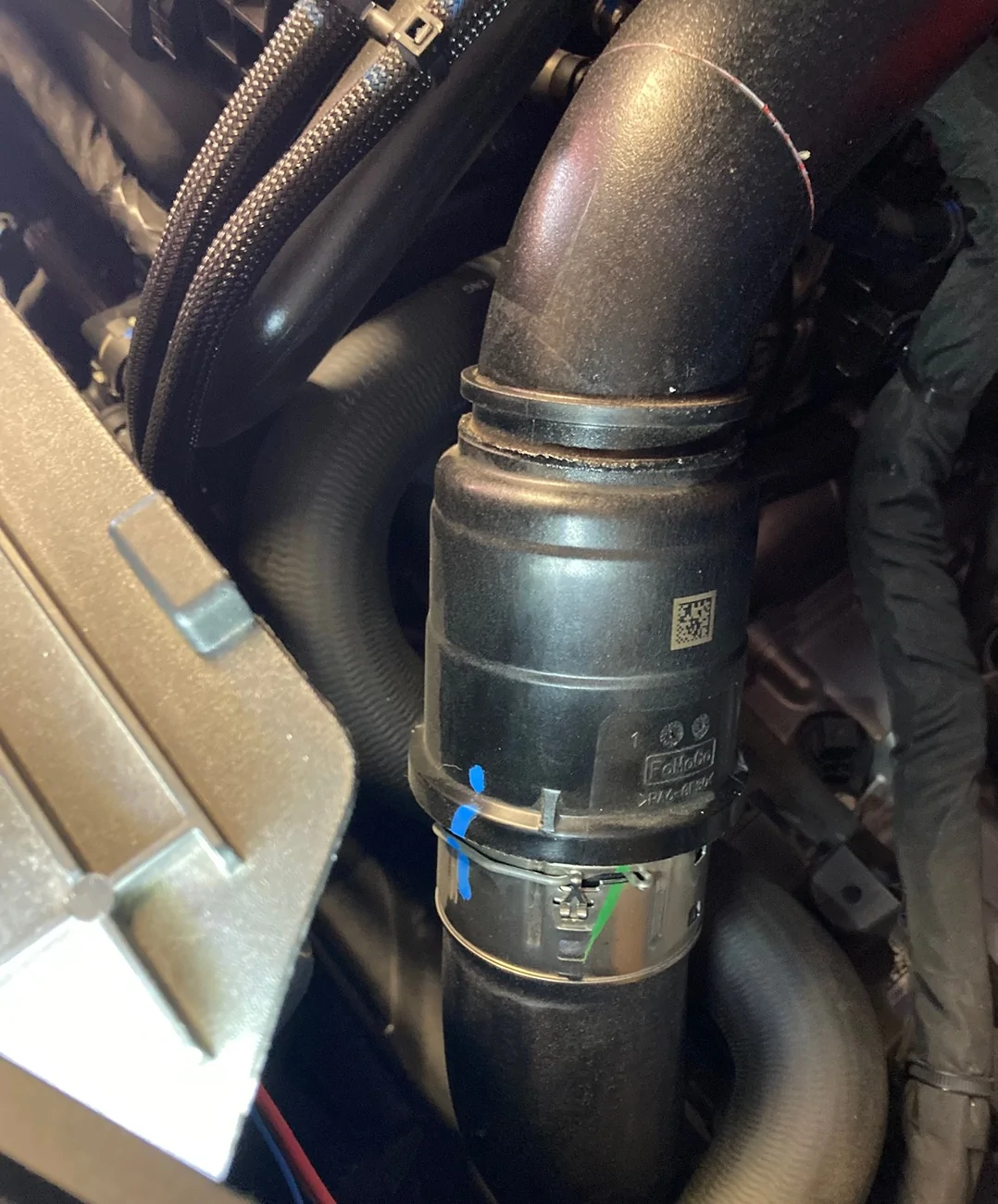

Am I correct in assuming the assorted blue markings on parts is a QC check mark? Some bolts have them also. Checking they are torqued properly?
Ford Maverick Blue Marks on Parts? IMG_0949
Turbo Pipe
Ford Maverick Blue Marks on Parts? IMG_0950
Ford Maverick Blue Marks on Parts? IMG_0948

Witness marks applied when torqued/assembled to quickly visually signify they were properly tightened/assembled/aligned.
Very common.
