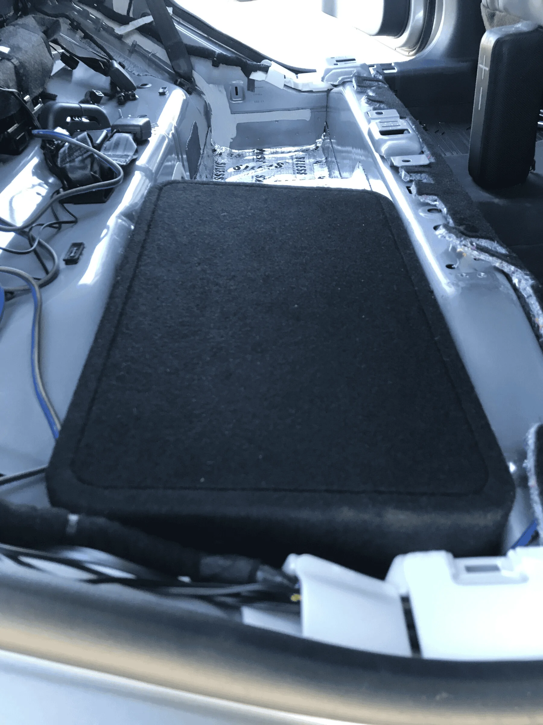

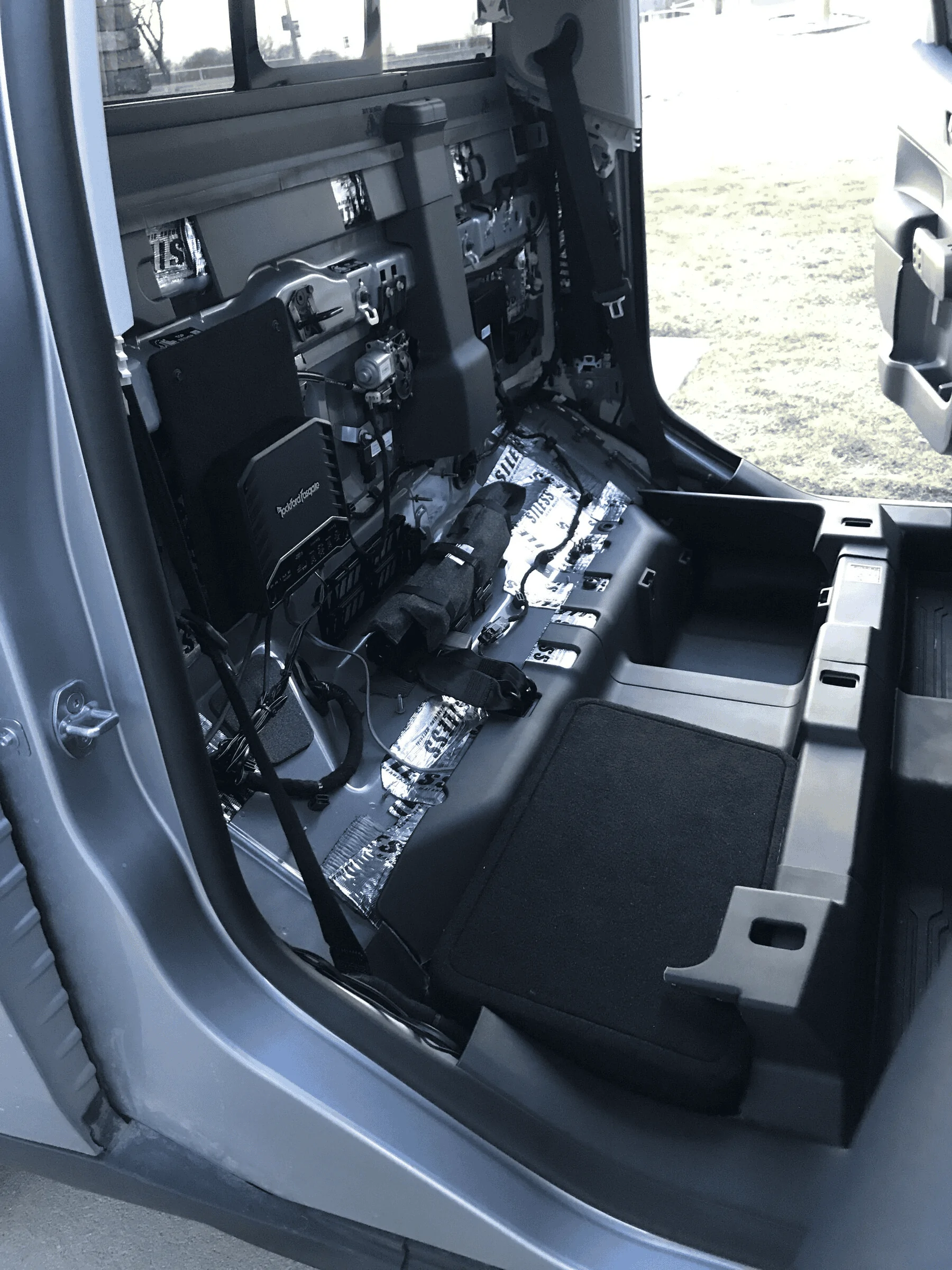

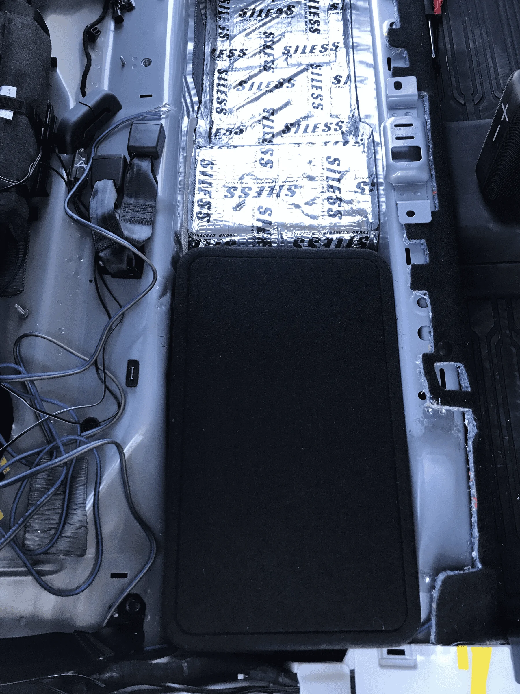

Also unfortunately these RF primes don’t seem to hold up, but I’m sure it’ll fit…. The kicker 48tcwrt102 would work (with the amp bracket taken off) if it didn’t have the passive radiator
these are the dimensions I came up with for my custom box (after trying a few other test fits)for what I’m hoping with be my final solution (will run across left side of rear wall) but the sub face will have to be offset towards the passenger side (because of that damn support rod/bar that slightly protrudes out the back about 17-18 inches from the passenger side plastic trim edge)
Ford Maverick Behind Bench Backseat Space/Sizing? C16A969A-9B94-45FC-B500-2BA0C110284A
