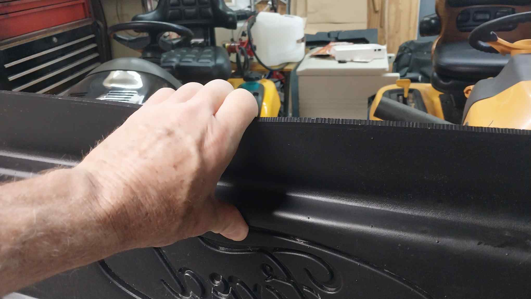

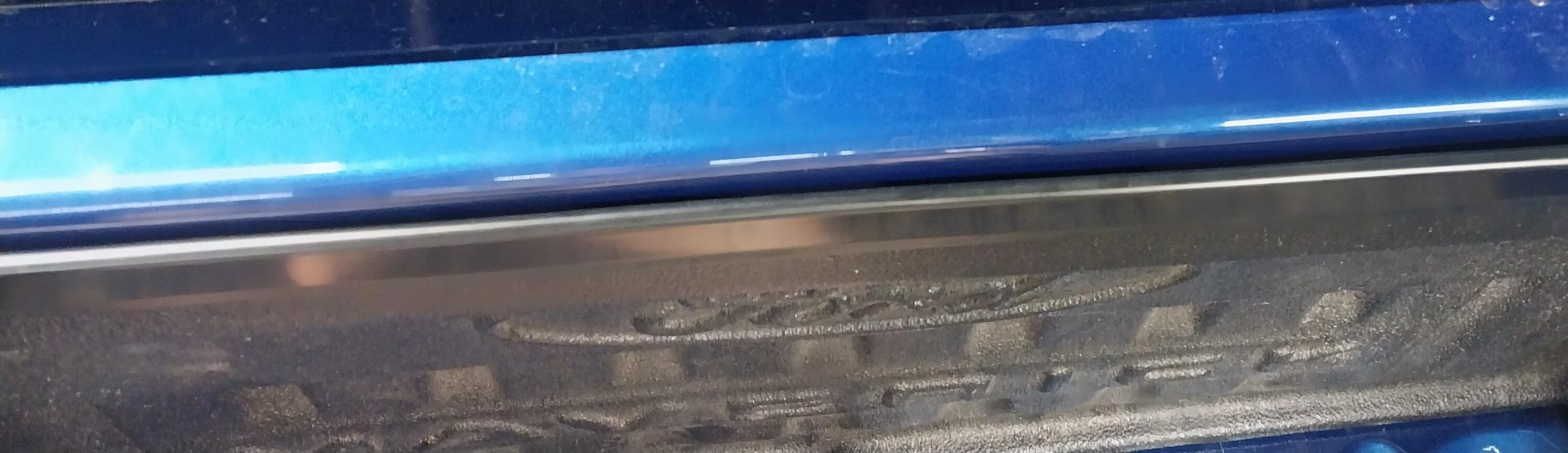

When I was ready to stick it I realized there was going to be a problem because there was a lot of bowing out at the top of the cab.
Ford Maverick Bedliner Pulling Loose Comprehensive Fix c1_20230625_18361025
I didn't want to tear it back apart, crossed my fingers and pulled the tape, pressed the heck out of it but really knowing it was gonna come off later.
It started lifting in a couple weeks and then completely came loose from the top trim piece--not the body which I had cleaned with alcohol.

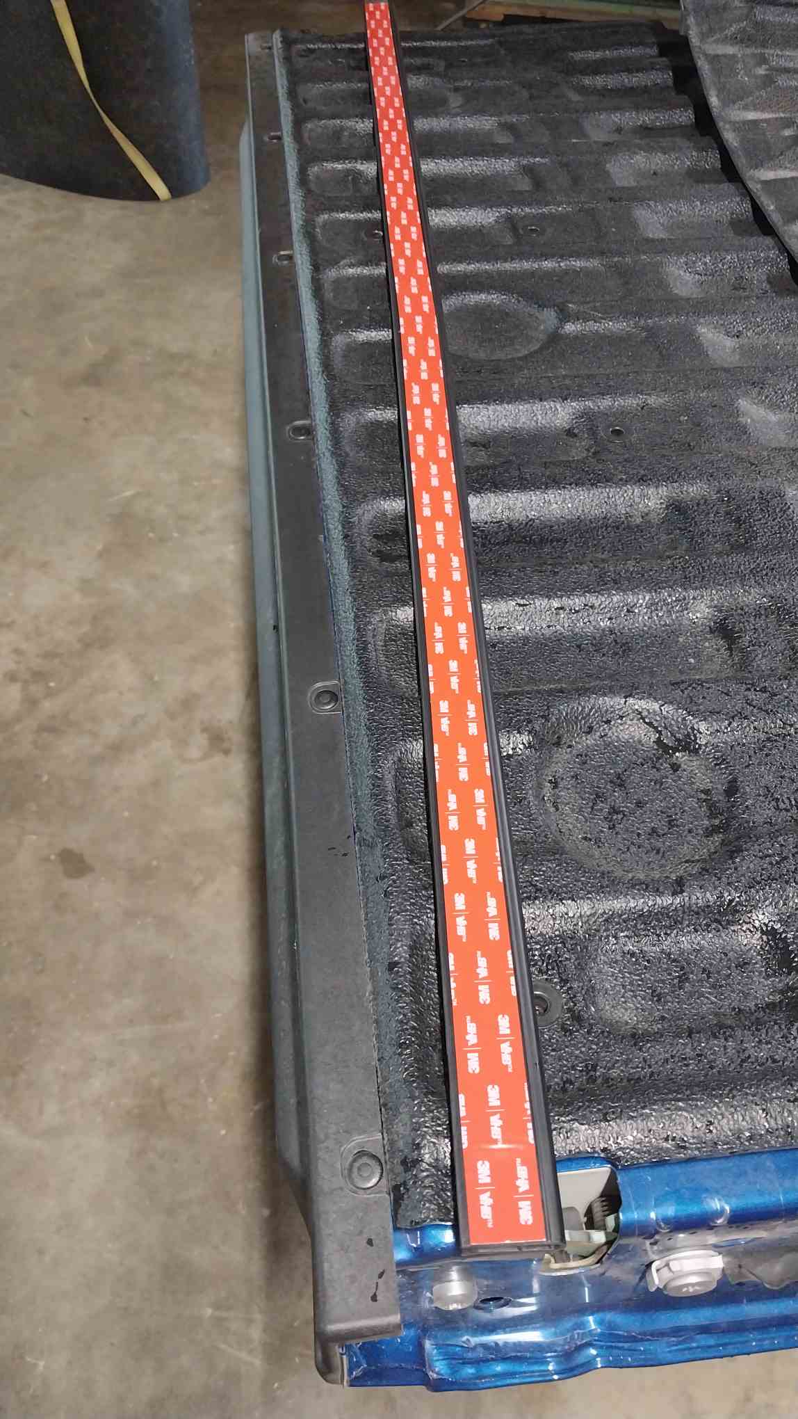

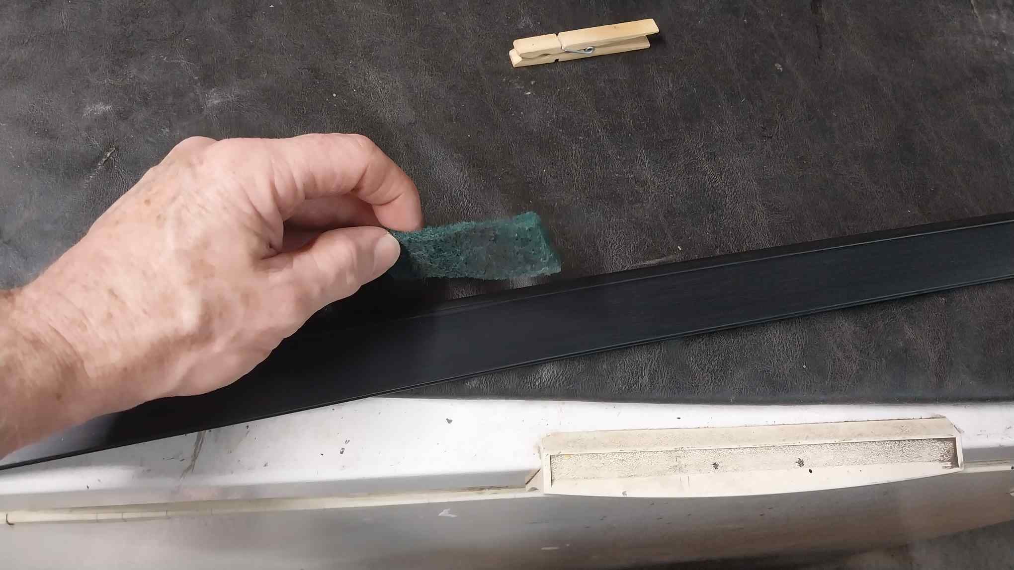

I then roughed the back of it since it was where the tape turned loose, cleaned it with Naptha, and stuck 3M VHB 5952 tape on it.
Ford Maverick Bedliner Pulling Loose Comprehensive Fix c1_20230625_18334597
Ford Maverick Bedliner Pulling Loose Comprehensive Fix c1_20230625_18340749
Ford Maverick Bedliner Pulling Loose Comprehensive Fix c1_20230625_18341695

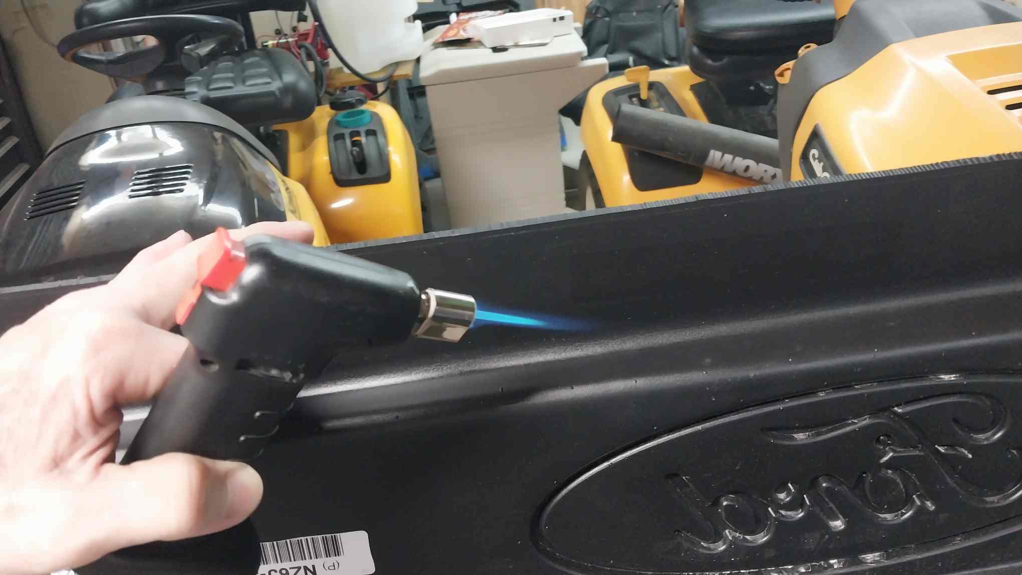

I took the bowed out cab side liner and heated it with my butane torch frequently feeling of the plastic to test the temp.
Ford Maverick Bedliner Pulling Loose Comprehensive Fix c1_20230625_18331590
When it felt too hot to touch I would bend it inward towards the way it would contact the cab.

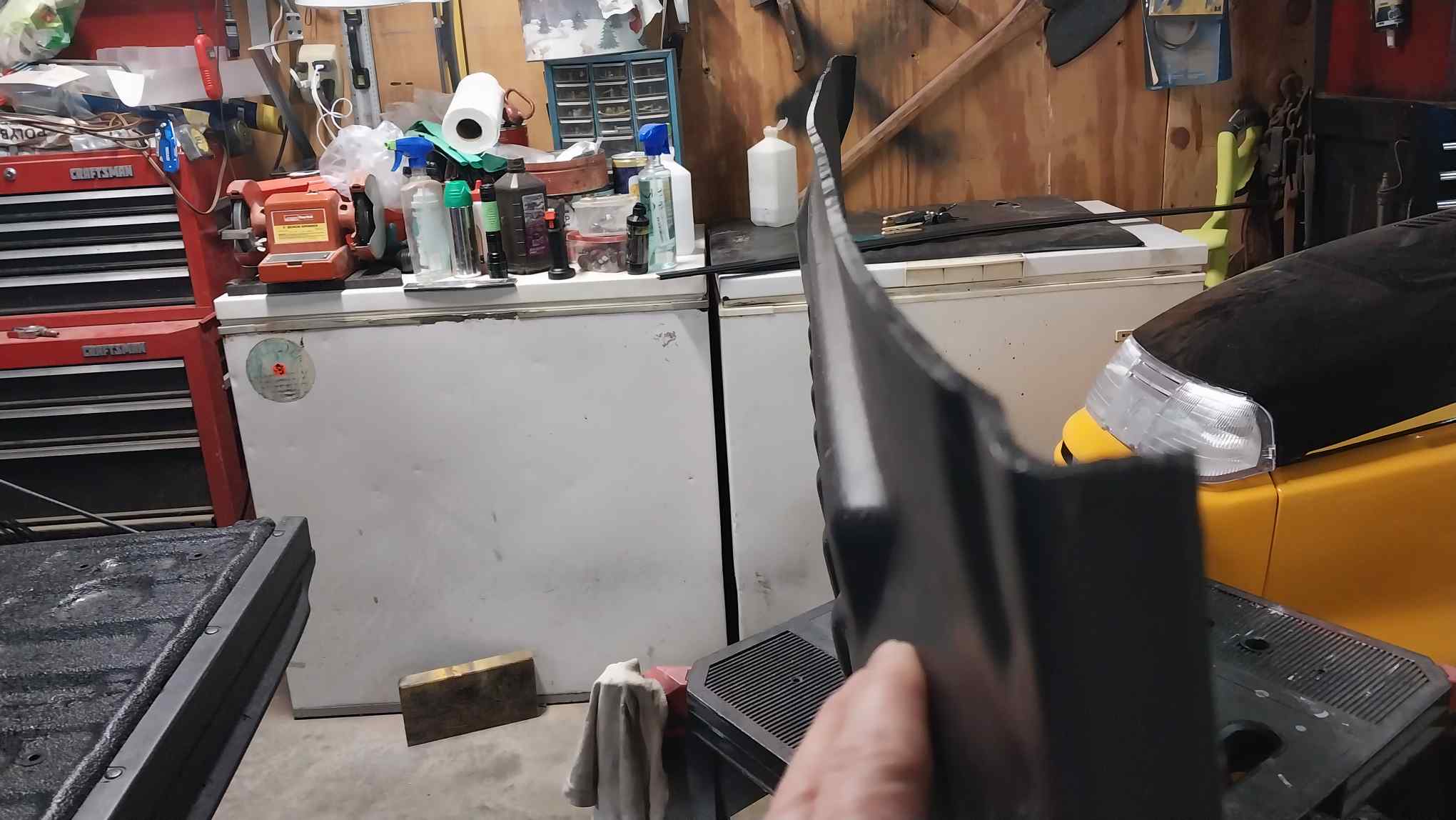

I worked it until it had a nice bow inward so it would press towards the cab instead of bowing away from it.
Ford Maverick Bedliner Pulling Loose Comprehensive Fix c1_20230625_18333657

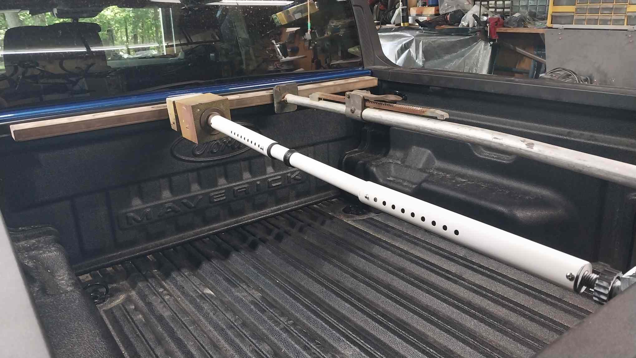

I test fitted and reheated and bent it several times before I was satisfied it was sitting tight against the cab.
Ford Maverick Bedliner Pulling Loose Comprehensive Fix 20230625_090939

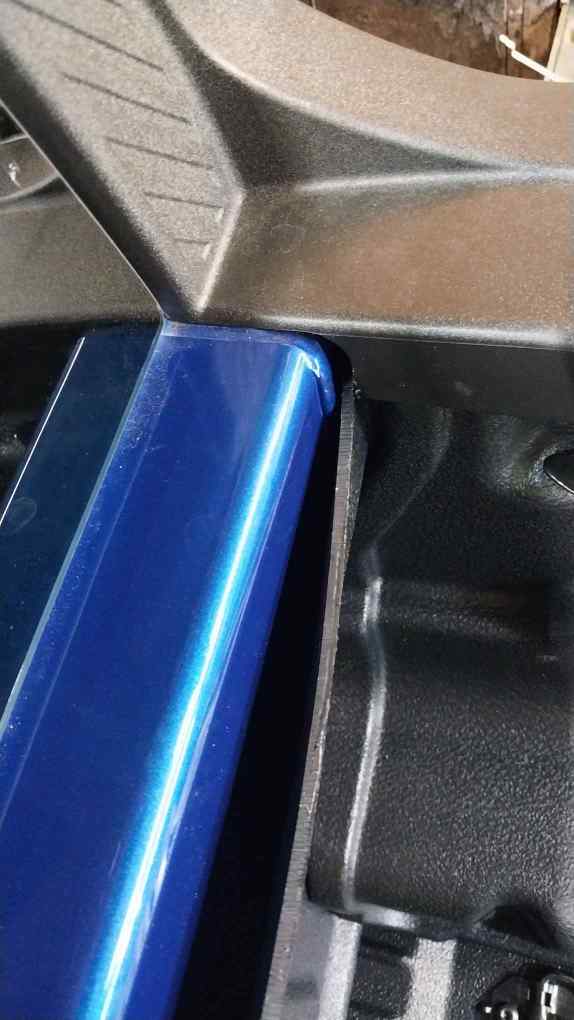

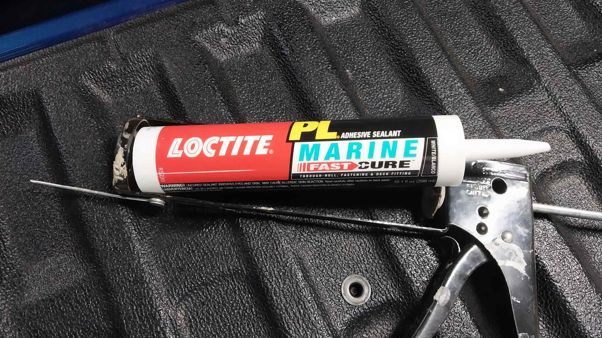

I finally put it back together and put a bead of polyurethane adhesive on the cab below where the 3M tape contacts it before pressing it. May be overkill but I plan on leaving this liner in for the truck's life.
Ford Maverick Bedliner Pulling Loose Comprehensive Fix c1_20230625_18344814
