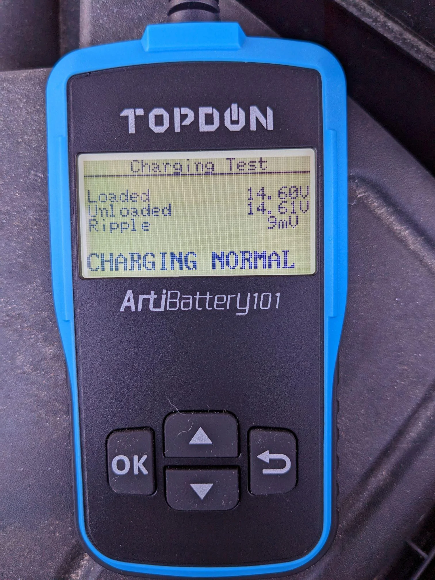

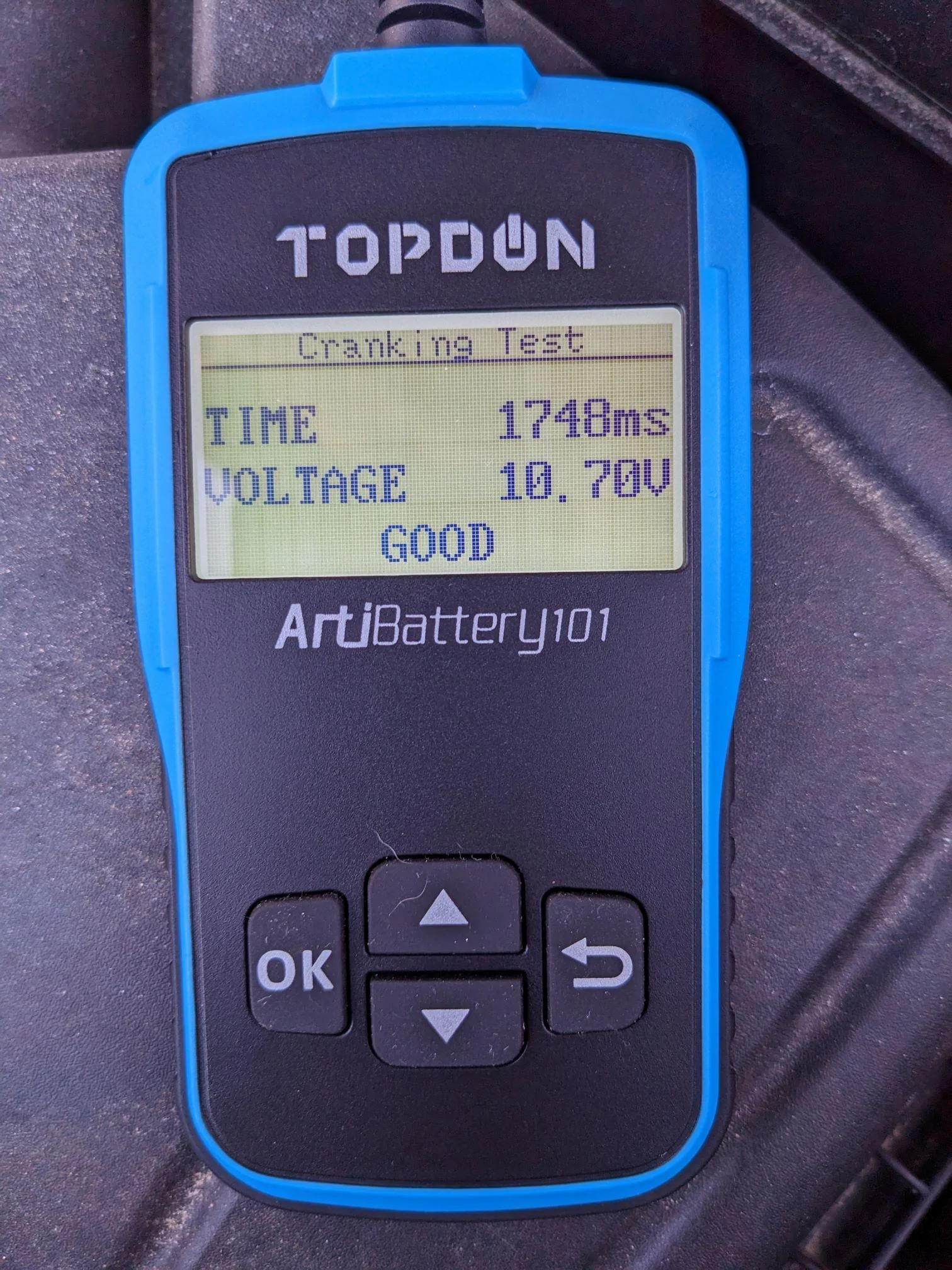

I like some others have been have trouble with my Maverick being in constant deep sleep mode. I have a 22 Maverick Lariat FX4 with co-pilot. I had a Thinkware front and rear dash cam sold and installed by Ford. I was using the Ford Pass app and the ATT wifi. After reading some posts I disabled Ford PASS on Mav in settings and deleted the app. I also turned off the wifi. I then recharged the battery and most features like the touch auto door locks to open doors, interior lights, remote start, have started to work again. I also did a battery reset. The only thing that still will not work is the auto stop start. Even if the auto start stop is activated it does not work., and on the dash i get the (A- smybol) with the line thru it.
I ran a battery test and took some pics. If someone could help me decipher the numbers i would appreciate it!

Does anyone have help on the battery test numbers? Should I have Dealer look at battery?
