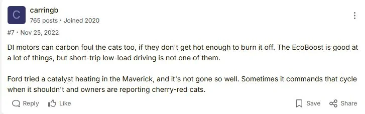

Through my investigation over the web trying to help the mechanics to figure it out, I found that:
Ford Maverick AWD Fault, rear differential needing to be replaced 1734058994476-xk
https://www.fordtransitusaforum.com...-2018-ford-transit-350-with-twin-turbo.92651/
I think that it is possible that the injection system detect the catalytic converter begins to be dirty and initiate a cleaning cycle by modifying the air / fuel ratio to heat up the catalytic converter in order to clean it.
I didn't note the frequency of that burning rubber smell but it's around every 300miles and as you said mostly in cold weather, where the catalytic converter might have tendency to stay cooler and / or have more tendency to clog.
Do you think it's possible?
