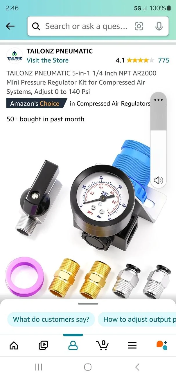

Do you jasper to have the part number for the air pressure regulator?
AndyMark am-4218a is the Pressure Regulator and Guage.
AndyMark am-4220a is the Pressure regulator without guage
Both are adjustable and have 1/4 inch press-in tube fittings.

I installed pressure regulator as well. When I adjust pressure to 25psi the deco unit makes a noise. Is this normal?

No noise unless the breakaway is pulled or the inertia switch is adjusted wrong.
