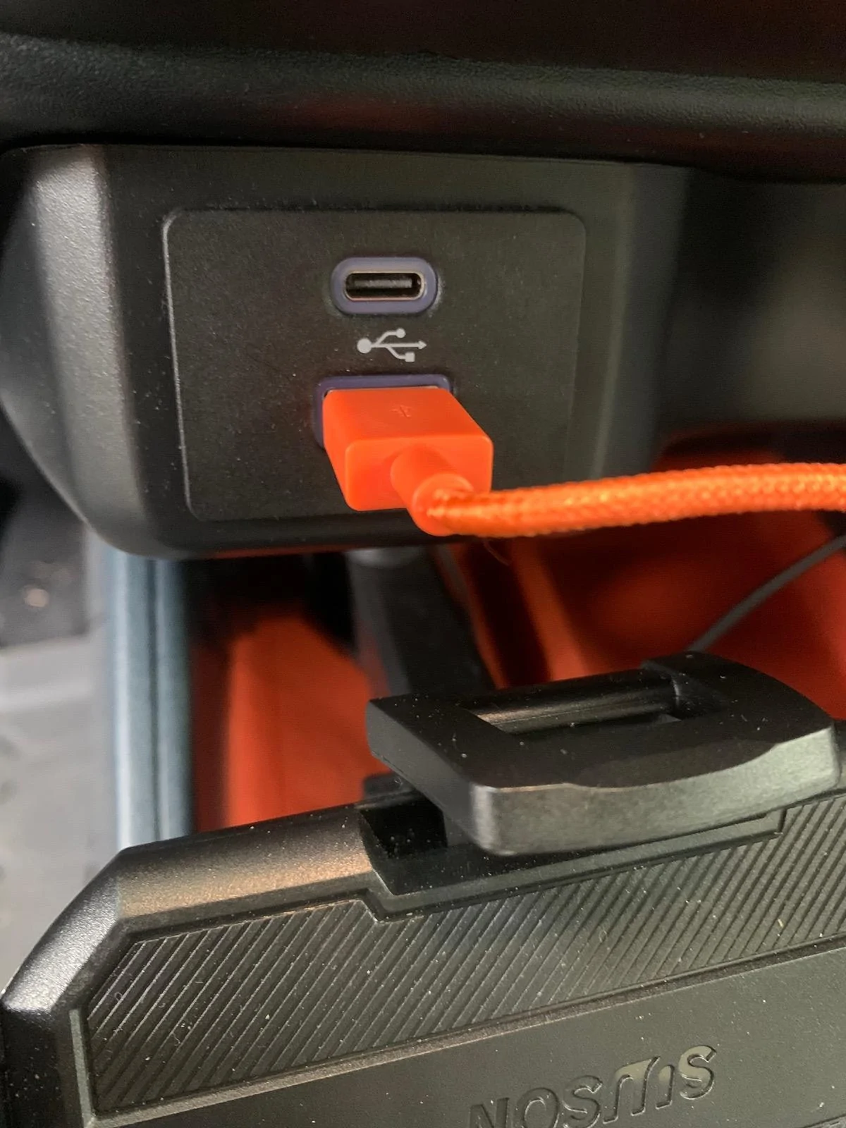

I'm having this issue where if I use the USB adapter to plug in my iPhone; the clarity, volume, and EQ settings are so much worse than if I use Bluetooth. Is there a setting somewhere in the phone or Mav that can make the USB sound as good as the Bluetooth? It seems like the USB should sound better? If you want to use maps or another app.....why does the music have to suffer? It would be such a pain if I wanted to listen to music via Youtube and have to unplug the usb and go to Bluetooth, then plug another charger into the non usb jack?!?!?!?!
When plugged into this port, it sounds half as good as Bluetooth

Have you tried using the top USB port (USB-c)? That's the port I use for my Pixel phone. The sound volume and quality are fine.

I have the same issue with Android Auto. Connecting to both the USB-A and USB-C ports of the truck do not compare to the volume and sound quality over bluetooth. I even bought a better USB cable that stated it had a 10gbps data rate and specifically for Android Auto thinking it would be better. It wasn't.

I have run into some reddit posts and Apple forum posts that this an actual issue. Not with just Ford products either.
The below is actuall from 3 years ago
CarPlay pro tip if your audio sounds muffled / loses its bass & volume
I've been struggling with Spotify audio via CarPlay ever since I upgraded by 2017 GT almost a year ago. Finally realized that Siri is the problem.
If your audio sounds like its playing in the background of another audio stream (no bass, poor highs, very quiet)...there's a simple fix -> press the Siri button (Audio assistant button on the left side of the steering wheel) and then press it again for Siri to go away. After Siri is dismissed, audio returns to its normal levels.
3.1.24 UPDATE: I think I finally figured it out the actual fix
  • There are two places you need to change the settings, Google Maps AND Apple Maps (even if you only use Google Maps)
  • Apple Maps
    • Even if you use Google Maps, the settings in Apple Maps impact Car Play
    • Open Apple Maps Settings (via Settings)
    • Go To Spoken Directions
    • Turn OFF Directions Pause Spoken Audio
  • Google Maps
    • Go to Settings >> Navigation
    • Turn OFF Play Voice over BlueTooth
  • Problem Solved!!!
12.6.23 UPDATE: 3 years later this is still a problem.
The two workable solutions that have been found are
  1. Uninstall Google Maps and Waze, then reinstall Google Maps but do NOT grant it microphone permissions. It seems like it's a Google Assistant / Apple Carplay / Siri collision.
  2. Switch the location services of the Alexa app from “always use” to “only while using the app”. This fixed it for u/holodoctor1
