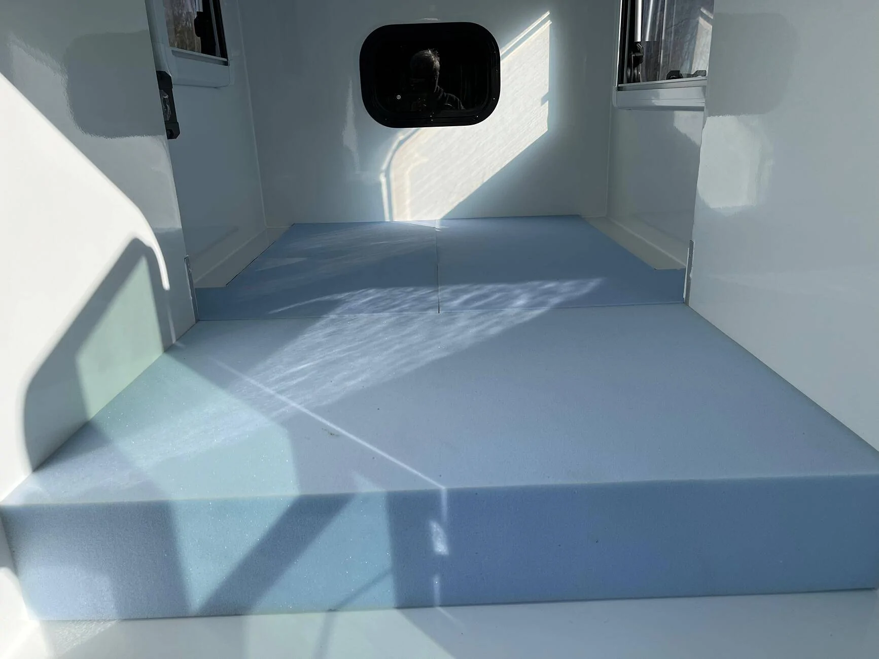

For some reason I only have the picture with the foam covered by the comforter. I will be putting the foam back in tomorrow for some more trimming so I will post some pics tomorrow. Thanks for the reply.

294 lbs all in. Weigh better than I hoped for!
Just weighed it on the scale at the dump. Last week I weighed the truck with a full tank of gas at 1830 KG. Today I weighed the truck with the camper on with a full tank and it came in at 1960 KG. A bit of subtraction and that is 130 KG or 286 lbs. Inside the camper was the 100 watt solar panel, all the bed cushions, shore power installed and the 750 watt inverter, two ceiling lights, and battery charger and solar controller.Also in the truck was the piece of composite material that goes in between the slideout and the tailgate to spread the load and keep the slide level. The battery I am waiting for will add 8 lbs with the heavy gauge cables so max weight will be 294 lbs.
