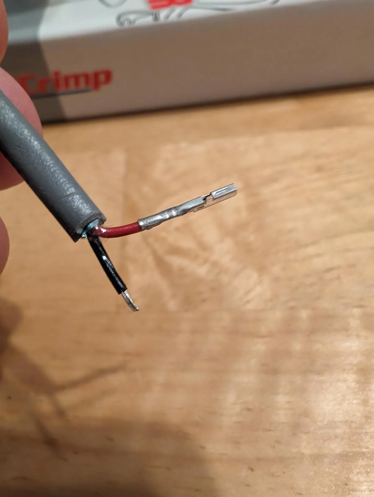

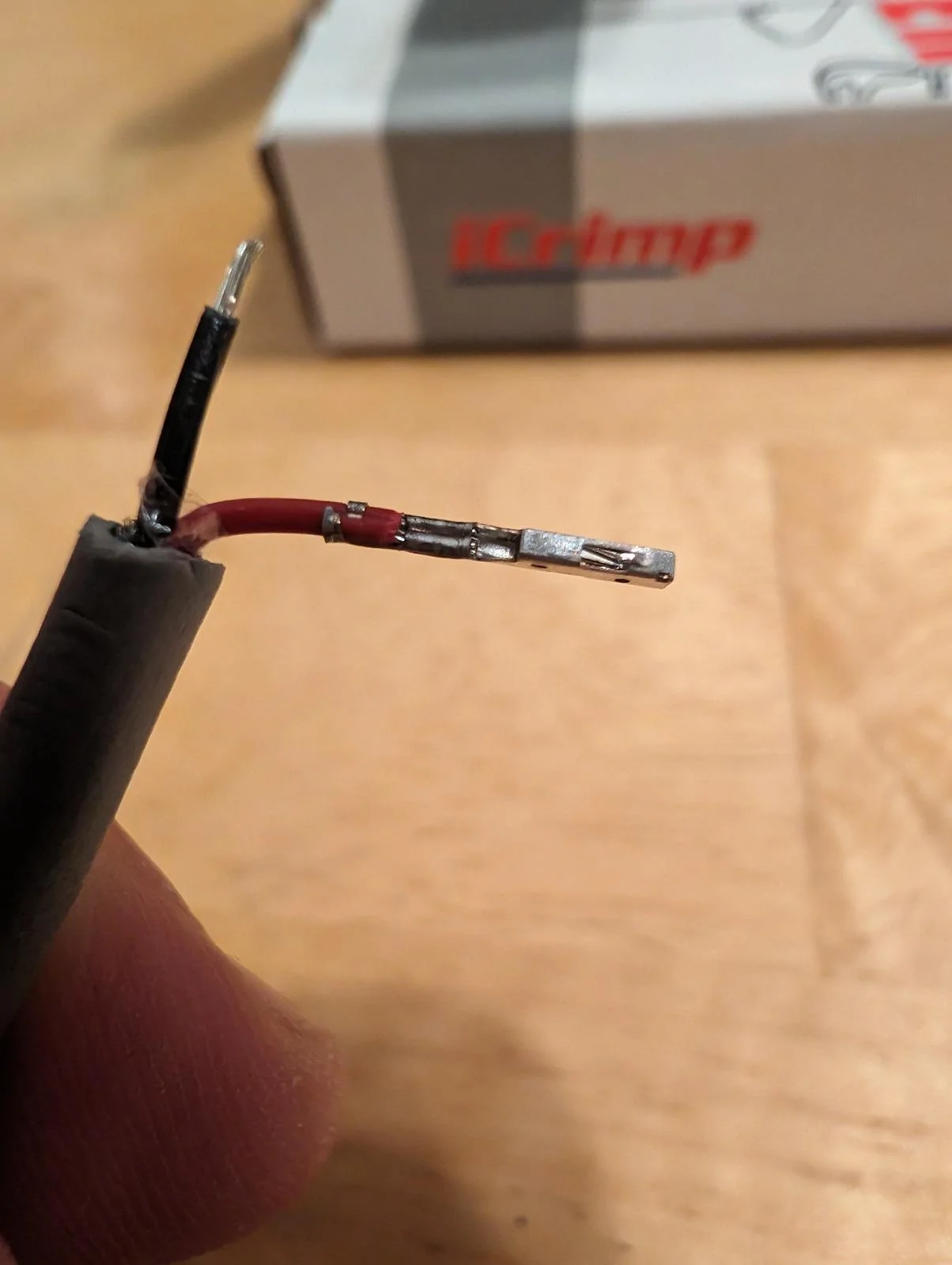

Item 3, Qty: 2 Contact socket (female pins) for connector: crimp style: 560023-0444 (2 required for kit: I suggest ordering 6, as they are tiny and easy to damage if you don't have a crimping tool and are using needle-nose pliers) Current price: 2 cents each
[I had a crimp-on ring terminal and a spool of wire already on hand: hardware stores typically have bulk wire in a variety of gauges]Item 4, Qty: 1 48" two wire solid insulated cable, 24 AWG (to crimp onto contact sockets)

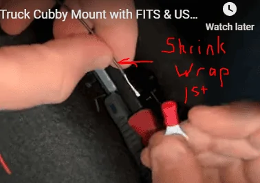

Link to AkroHD's video on how to install and wire the cubby insert and USB module:
