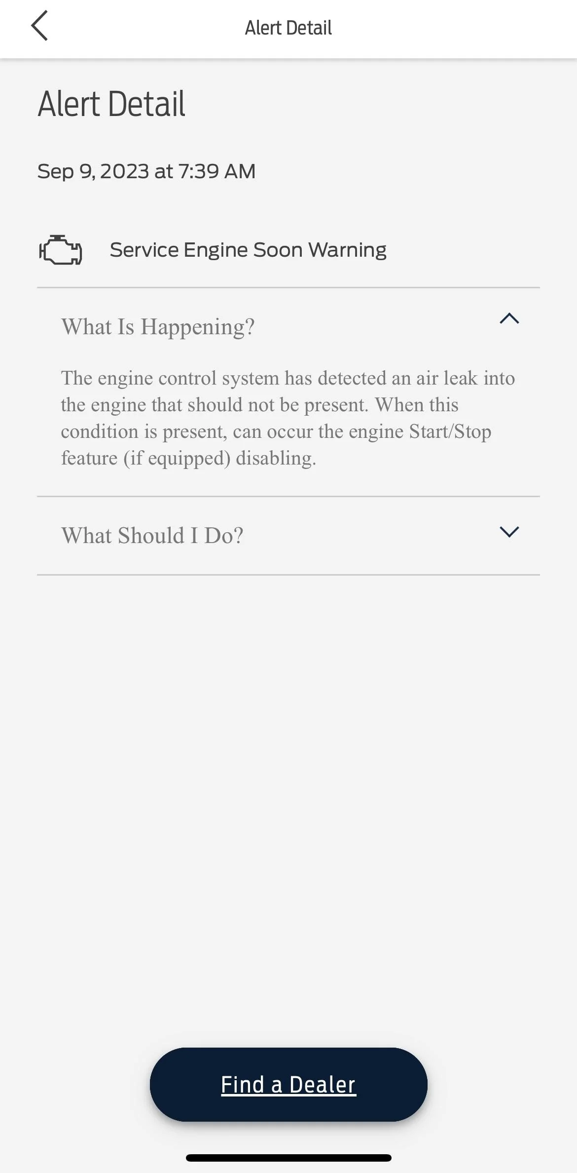

Anyone get this recently? I have 2500 miles on my 23 hybrid xlt and I got my maverick just over 2 months ago

Assuming your check engine light (CEL) came on? I had a code of 2282 show up. First visit, mechanic said he couldn’t find anything. Meanwhile another owner had the same code. His mechanic found a faulty o-ring between the throttle body and intake manifold. The second time my CEL came on with the same code I suggested to my mechanic that he examine the o-ring. When he removed the throttle body, he said the o-ring was fine but that the base plate of the throttle body was deeply scored. He installed a new throttle body and so far, so good, although I haven’t put the engine under any kind of strain since the repair.

CEL is on, it just appeared today so I haven’t been able to see what codes it’s throwing, I’ll get back when I can get hands on a reader.

Threw the exact same code for me as well, I’m bringing it in on Tuesday so I have a way to direct them a bit, thanks!
