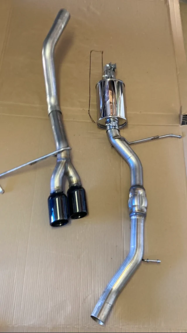

Is the X-Type too loud?
Not only too loud - but painfully droney in the cab. It was not tuned properly for the Sport & Lobo modes especially!
I added an $100 resonator/muffler and it sounds great both in & out of truck now.
Cold start is still very loud though. I open my garage just a foot when I start up - open fully once high idle is complete:)

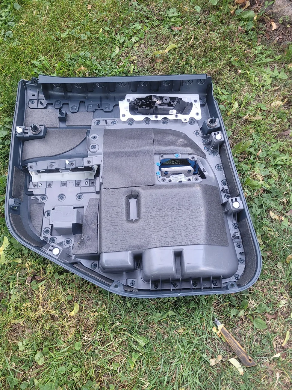

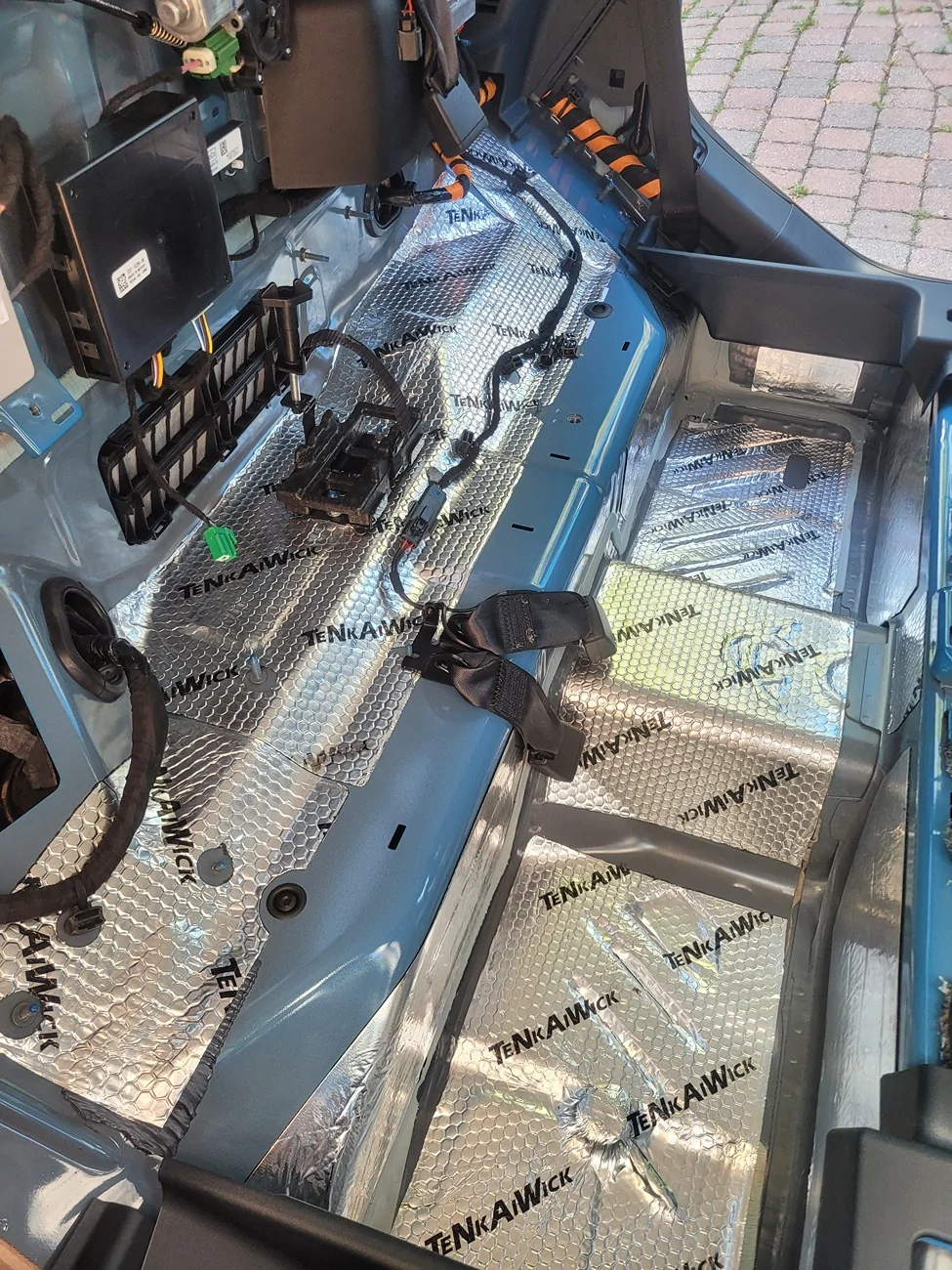

I have added aluminum buty sound deadener to nearly every panel of my Maverick.
I have coverd the inside of the fenders, top half of the tailgate, in the doors, under the rear seat, under the carpet, the roof and the back wall.
I added 4mm foam deadener to back side of the door panels.
I also added the fome over the aluminum butyl under the rear seat and the roof.
The result is better than I expected.
The truck is almost limousine quite.
And the stereo sounds better!

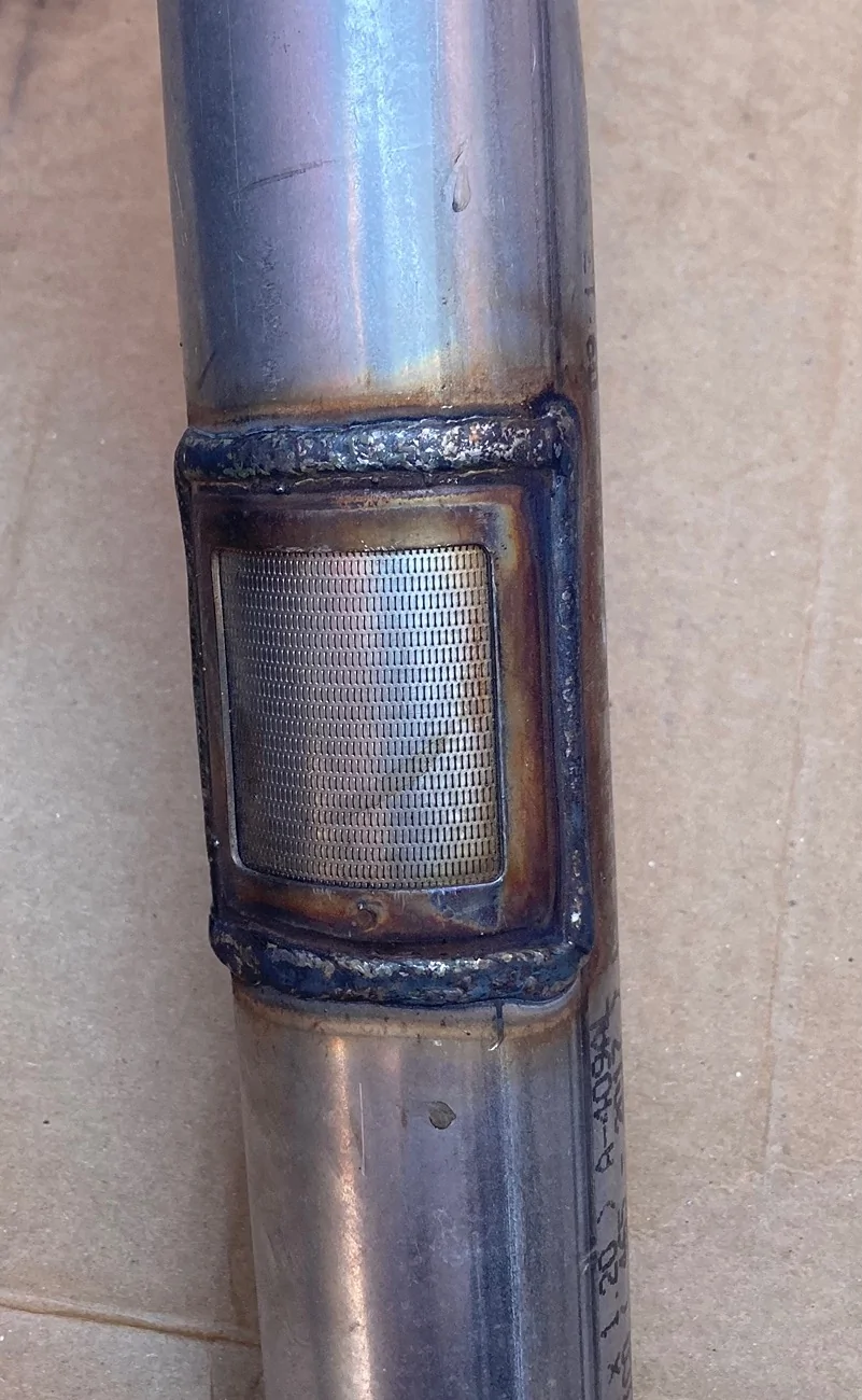

An aftermarket exhaust would ruin your beautiful & skillful work!
I’m impressed with the OEM exhaust now in my garage. I’m thinking of reusing the minimalist resonator “patch” near the tailpipe:

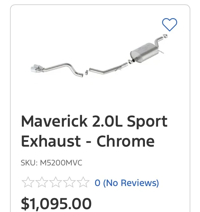

What borla sport part number? Tons of options on the net tho
I was wondering what the screen was for. Never crossed my mind that it was a resonator.
