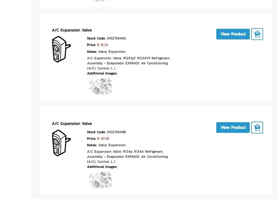

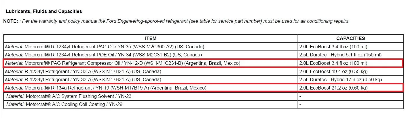

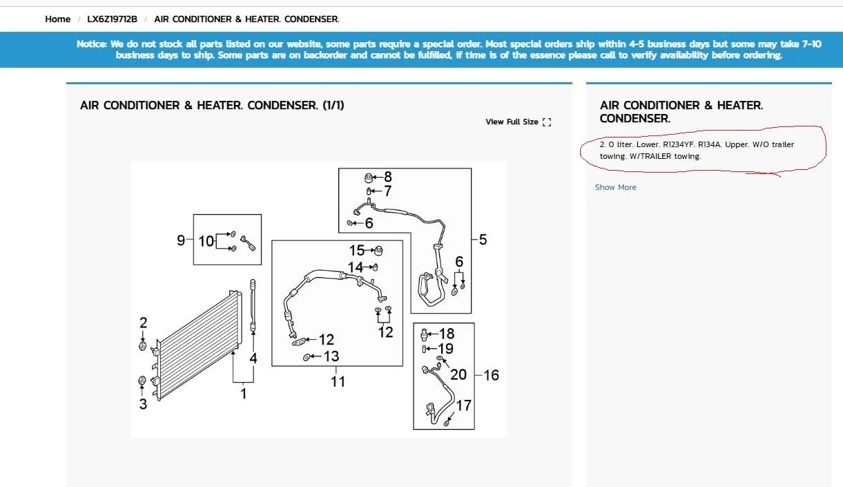

After the wreck of my Maverick #2 - I was looking thru the parts for the AC system and it lists 2 different expansion valves one for 134A and one for R1234Y .
And looking at the condenser it lists 134A and R1234Y Both in the diagram .....
It would lead me to believe that changing out to 134A would be as simple as replacing the expansion valve ( if that is even necessary ) after flushing the system. Still - Im curious why all the 134A parts listed and available in the parts catalog.
