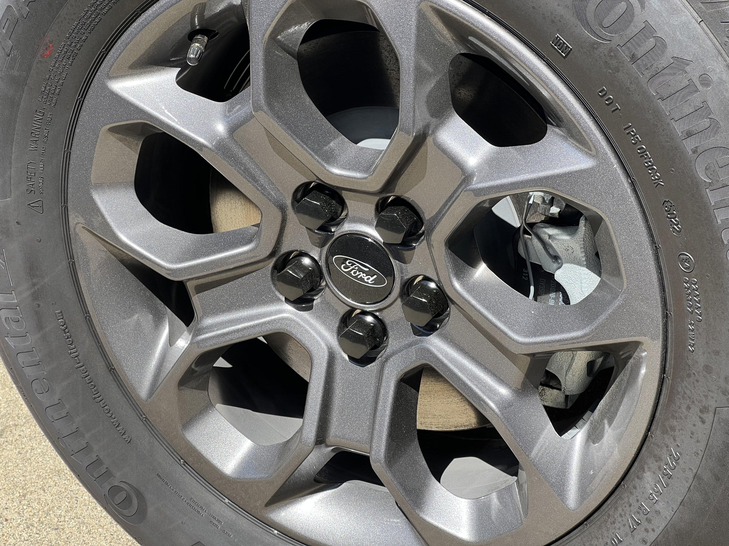

McGard 84538 Black (M12 x 1.5 Thread Size) Bulge Style Cone Seat Wheel Installation Kit for 5-Lug Wheels https://a.co/d/2Vsf555
I have these showing up tomorrow. Eventually I will get black wheels but for now I'm sure these will look fine on xlt wheels. I bought them at $70, next day they skyrocketed to $100
Those won't fit your Mav, the lugs are M14x1.5.

I went thru a looooong saga of finding black lug nuts that I was confident in for my aftermarket steel wheels. I'll see if I can find that thread and link it here. But for now, I know these are the ones I ended up using.
Wheel Accessories Parts 20 Pcs 14mm 1.50 14x1.50 Thread 611-204 ACPZ-1012-D ACPZ-1012-M | 1.66" Long OEM Style Lug Nuts Chrome 13/16" Hex Fits 2015+ Ford Mustang 2020+ Explorer 2015+ Edge | Maverick https://a.co/d/09umuNJ
And here was my thread about it.
https://www.mavericktruckclub.com/forum/threads/acorn-lugnuts-not-going-into-the-rim-very-far.22123/
