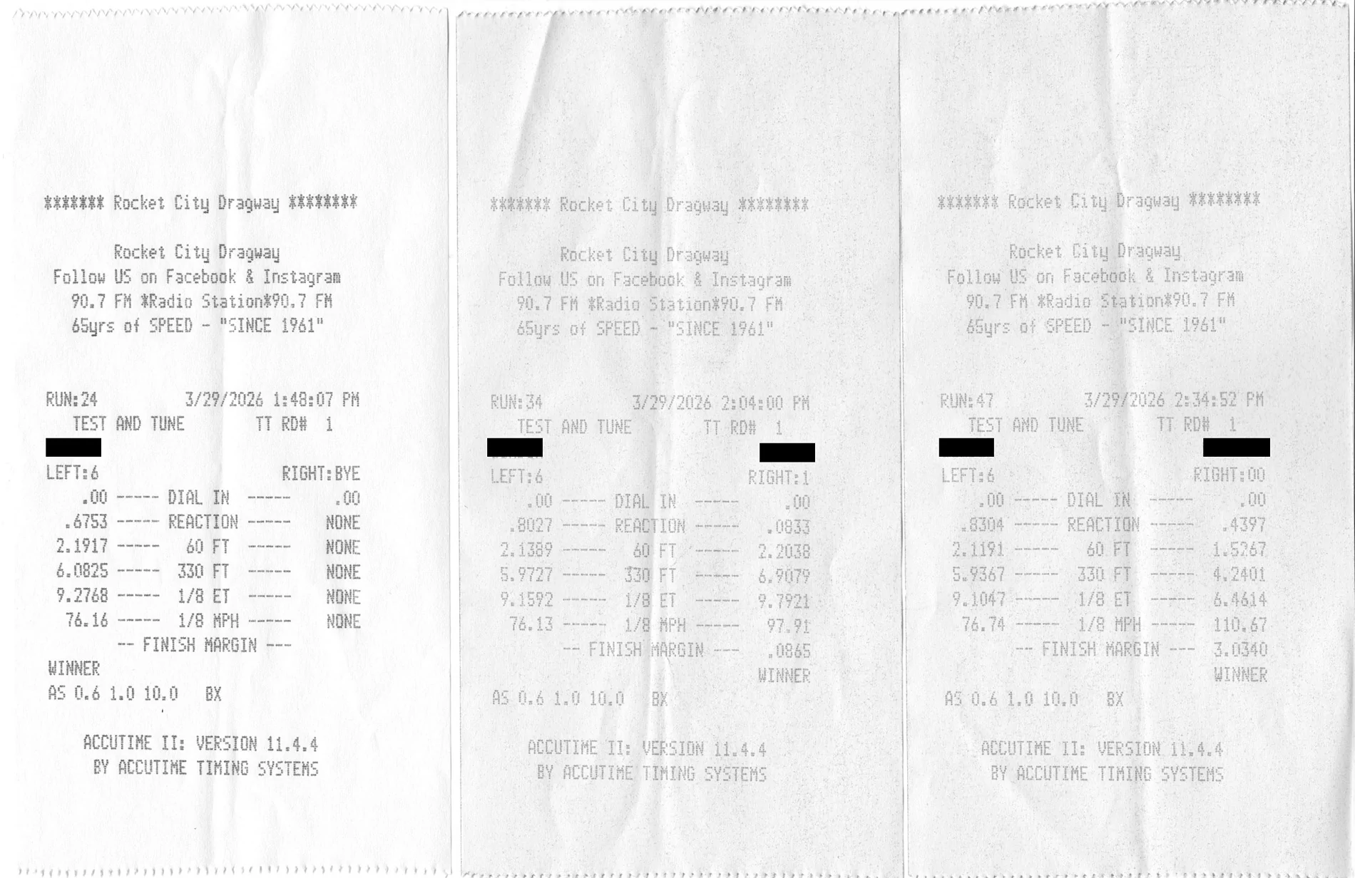

Took my Maverick to Rocket City Dragway for opening day Test and Tune to see what my Phase 1 results would look like. See pics. I'm #6 in the left lane.
Best 1/8 run: 9.1047s @ 76,74 mph.
2022 Ford Maverick 2.0 AWD, FX4, 4KT
Phase 1 setup: Lincoln Corsair turbo upgrade, CVF intercooler, CVF 3.0 catted downpipe, S&B CAI, Borla S-Type exhaust. , 93 Octane HP Tuners conservative tune putting out 310 whp, 318 wtq. Ford performance rear sway bar. Still running OEM 17" Black wheels with original Scorpion ATR tires.
Current set up is tire and traction control limited. I need to find a way to turn the traction control all the way off to get the best numbers. Driver has crappy reaction skills that need improvement.

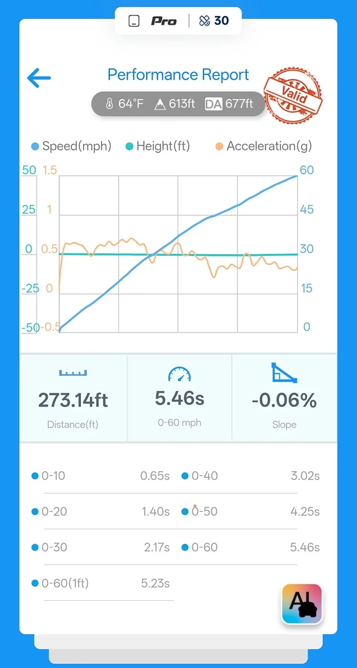

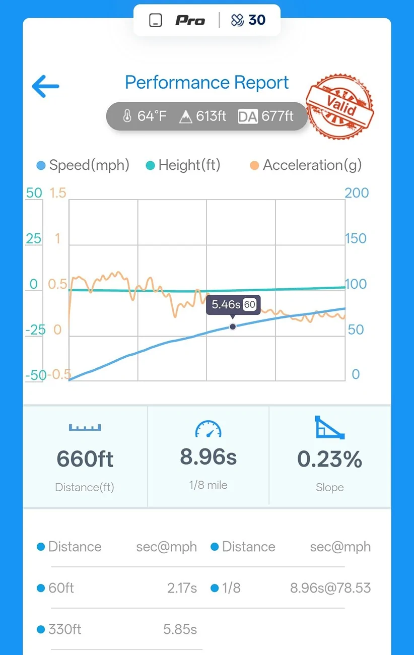

More data from the 5.46s 0-60 run: Under 9s 1/8.

Were You brake boost launching it?
Lightly, only around 2k rpm. I seem to be consistent on the 60ft at 2.11 to 2.19 or so. Once my phase 2 suspension and wheels are put on, I plan to try some new techniques. Sand mode and a more deliberate throttle application. Goal is sub 2s 60 ft.

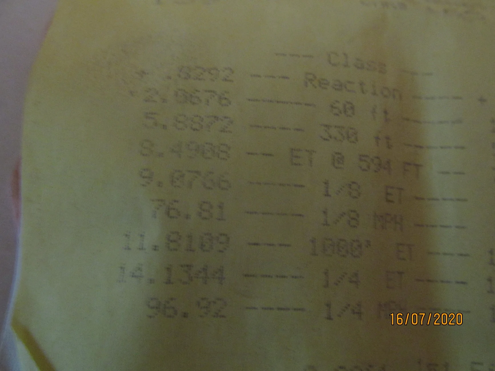

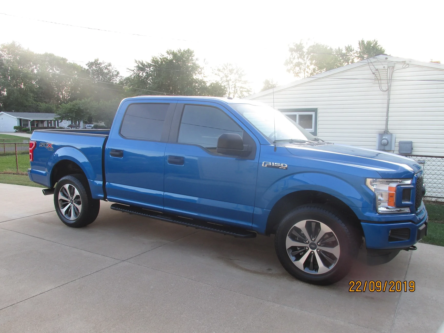

My bone stock with only 93 octane 2019 Crew Cab 4X4 F-150 with the 3.5 Eco Boost ran almost the same times as Your Maverick but My 60 ft time and 1/8 mile time was just a little bit better than yours.
