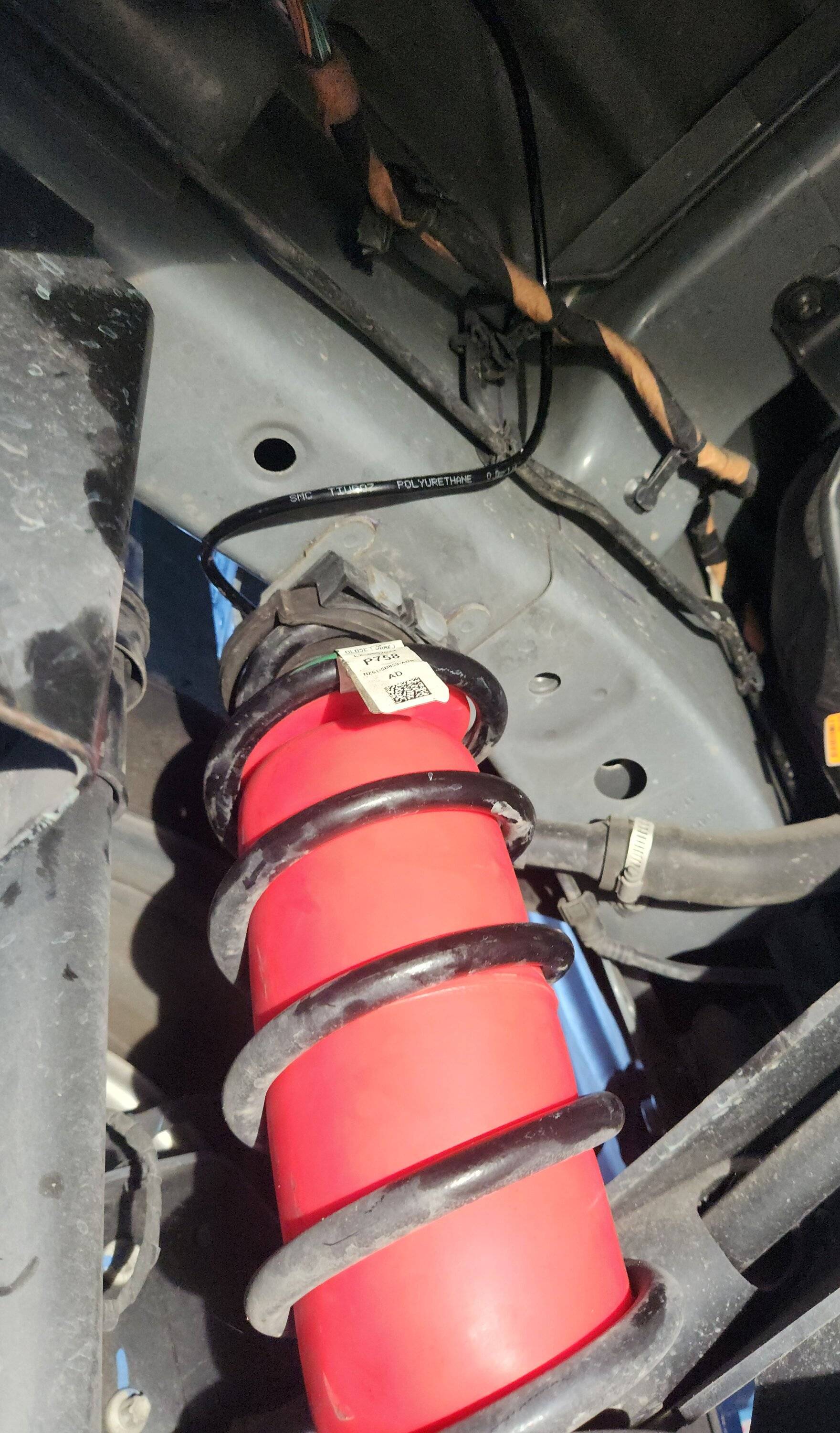

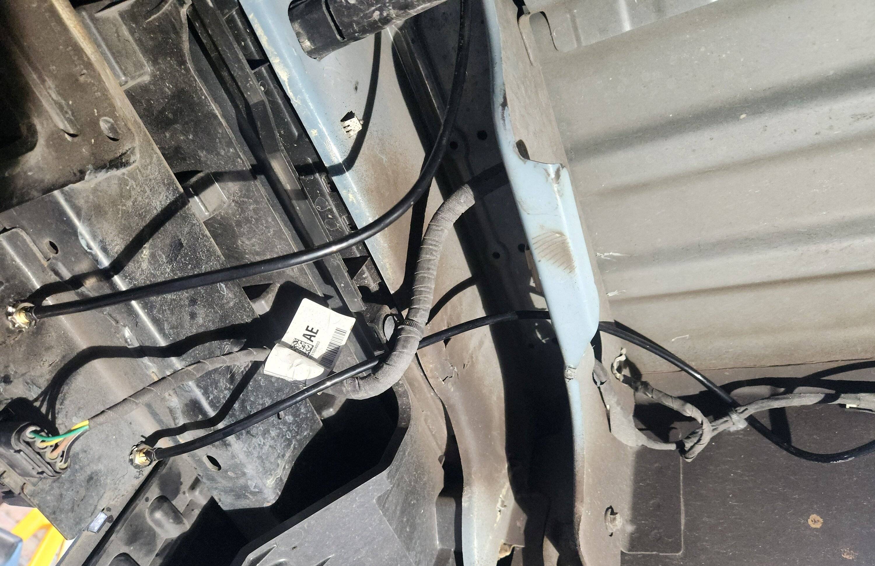

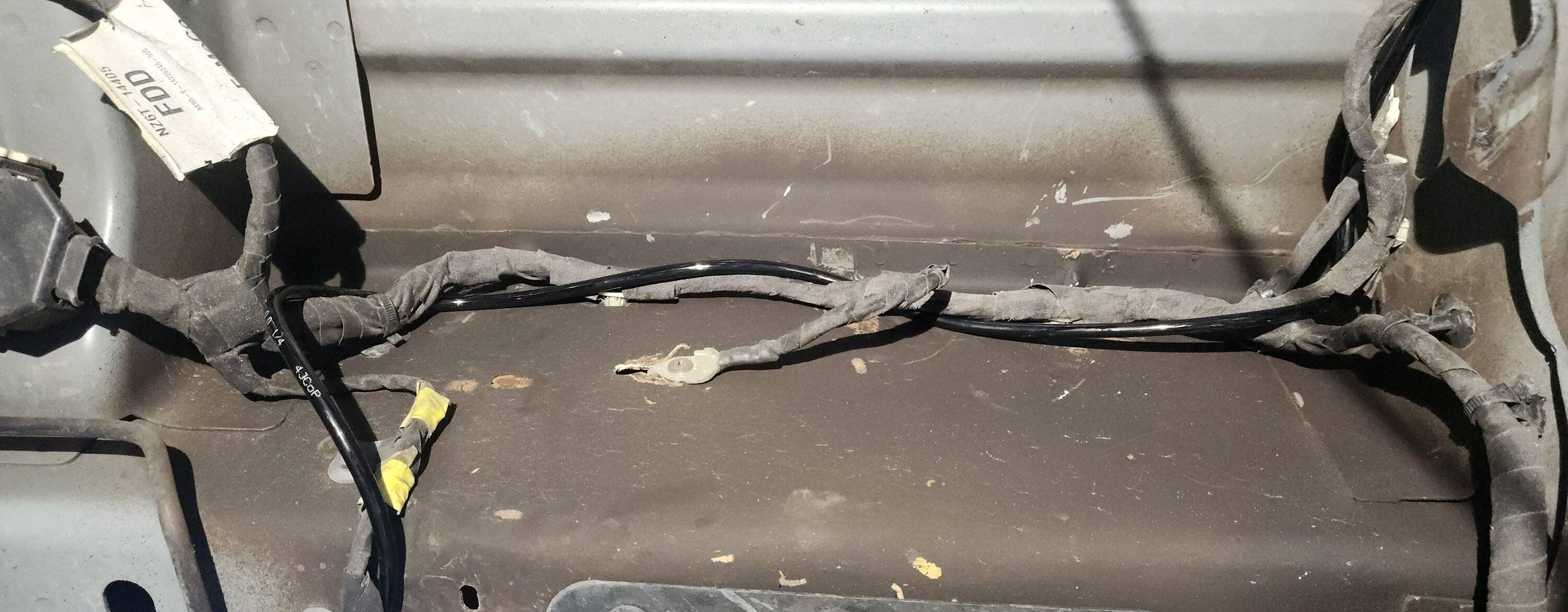

Here's the passenger side going toward the rear, tires still up in the air
Ford Maverick Air Lift 1000 Air Bag Spring Kit install (2022 Hybrid XL) P1
Ford Maverick Air Lift 1000 Air Bag Spring Kit install (2022 Hybrid XL) P2
Ford Maverick Air Lift 1000 Air Bag Spring Kit install (2022 Hybrid XL) P3

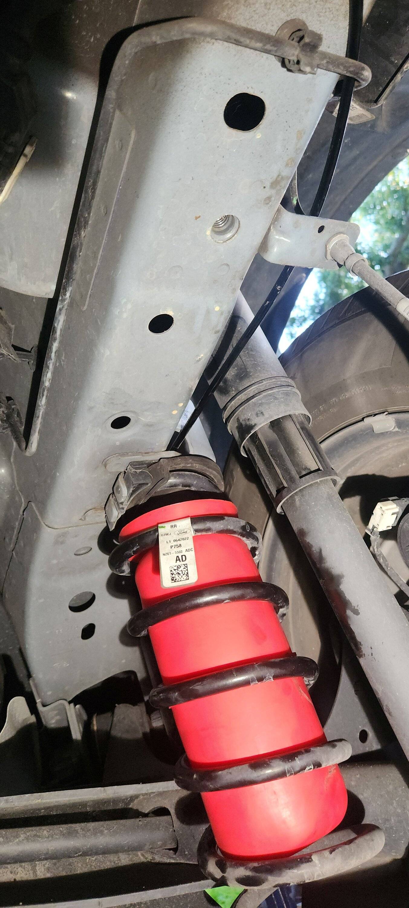

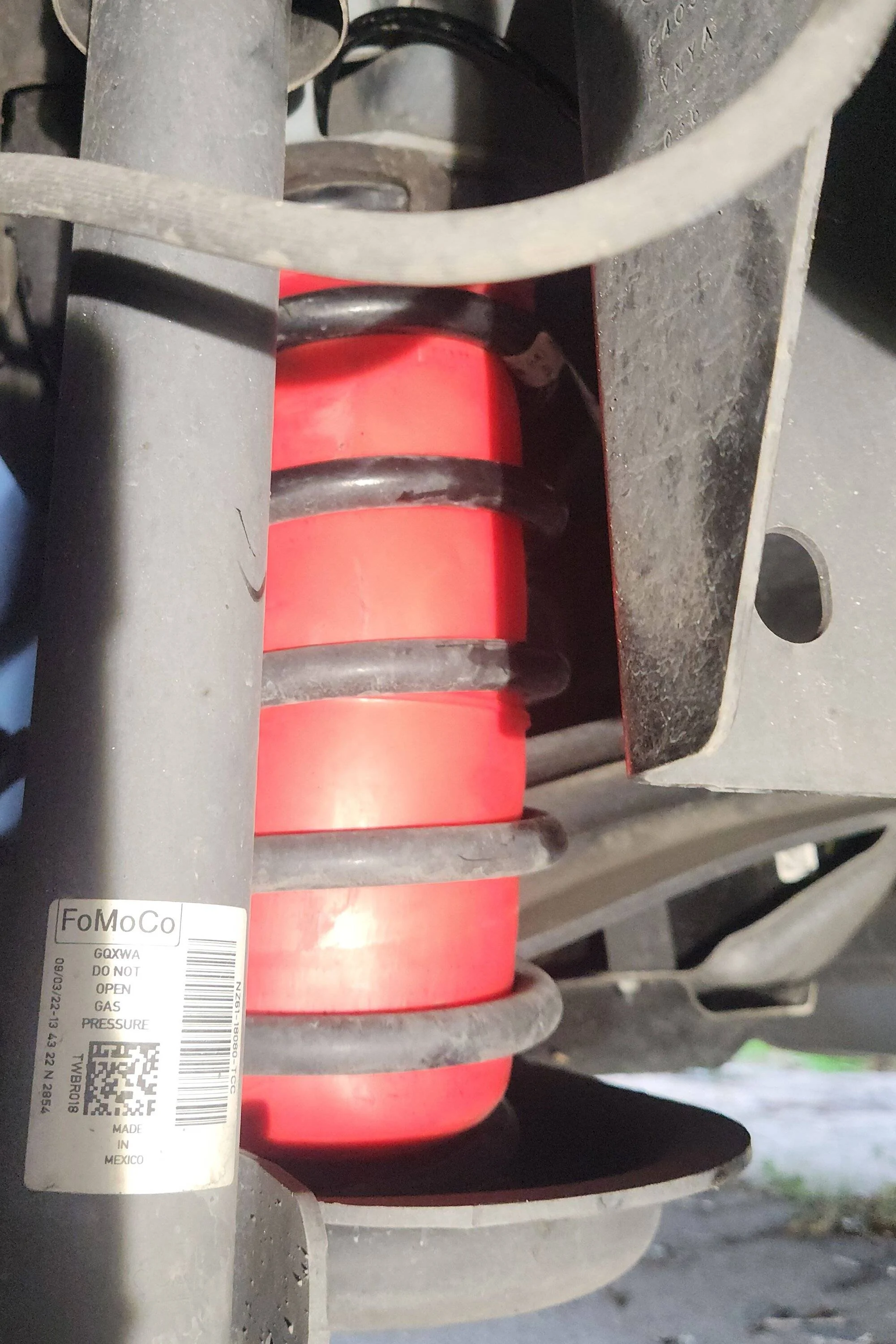

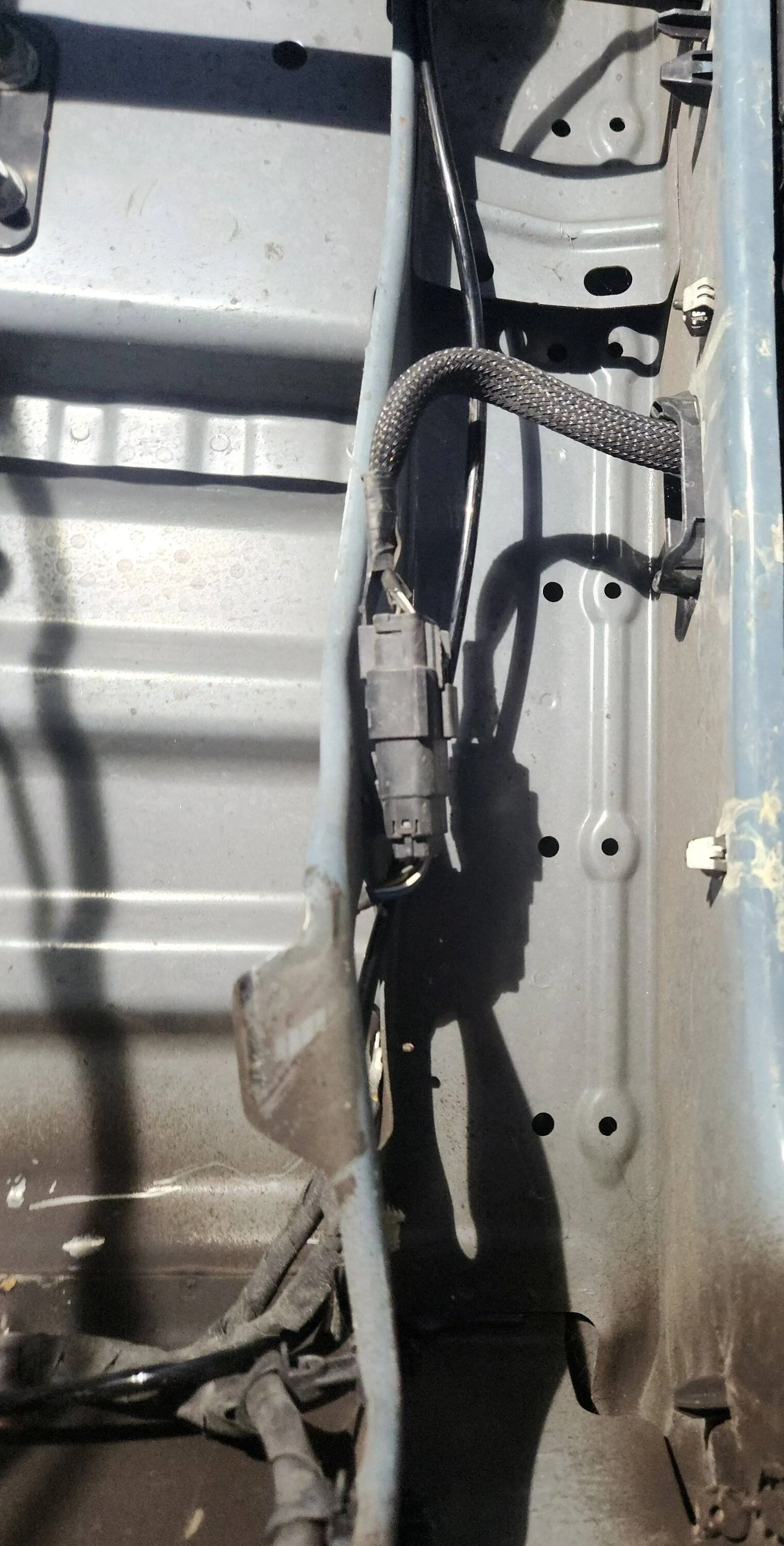

And the driver side going towards the rear
Ford Maverick Air Lift 1000 Air Bag Spring Kit install (2022 Hybrid XL) D1
Ford Maverick Air Lift 1000 Air Bag Spring Kit install (2022 Hybrid XL) D2

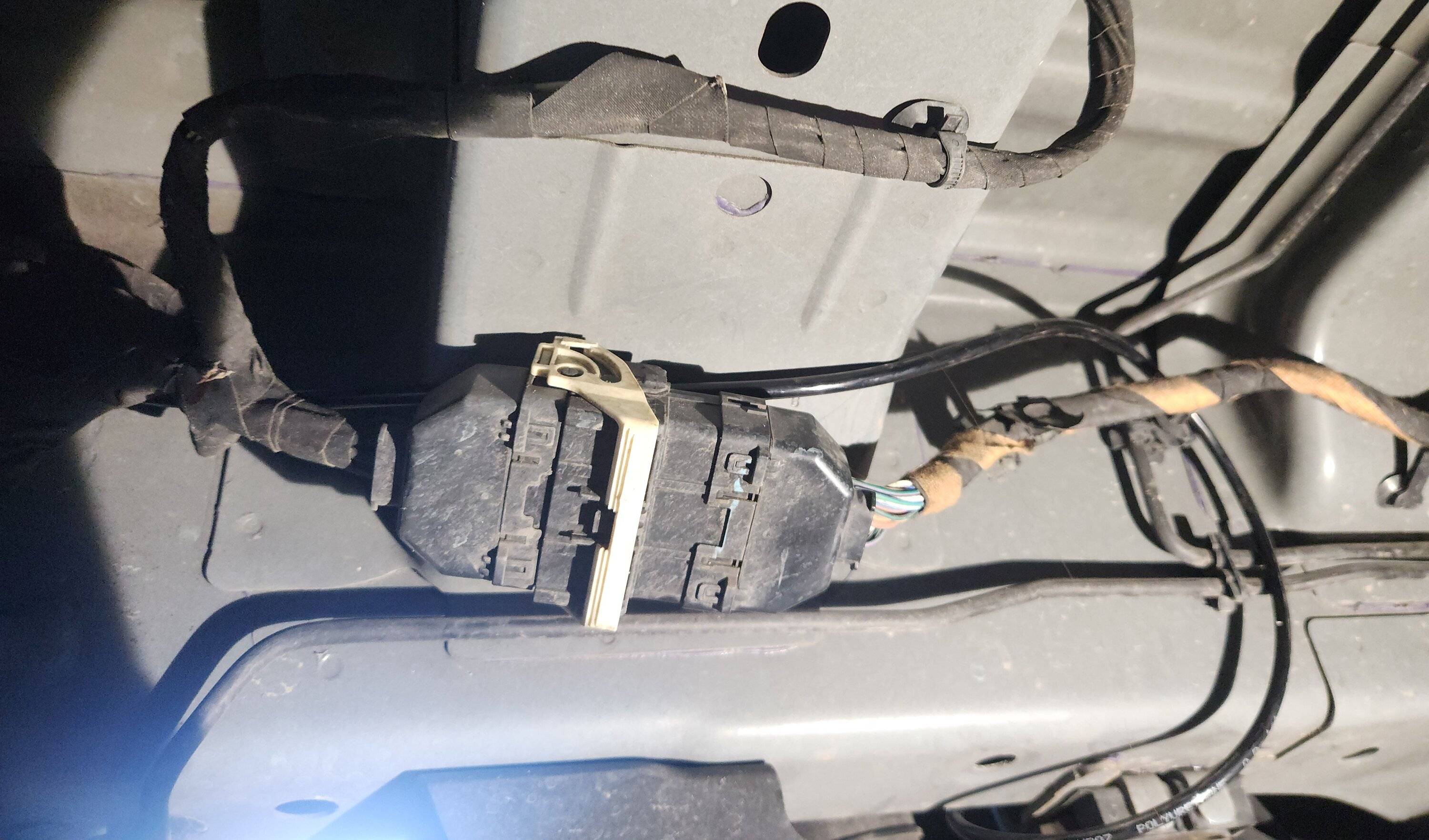

I think going behind this connector should be enough heat shielding, there is already a heat shield on the exhaust here, probably to protect the connector and wires. Again, this is a 2022 hybrid. When I add the velcro it should keep it in place.
Ford Maverick Air Lift 1000 Air Bag Spring Kit install (2022 Hybrid XL) D3

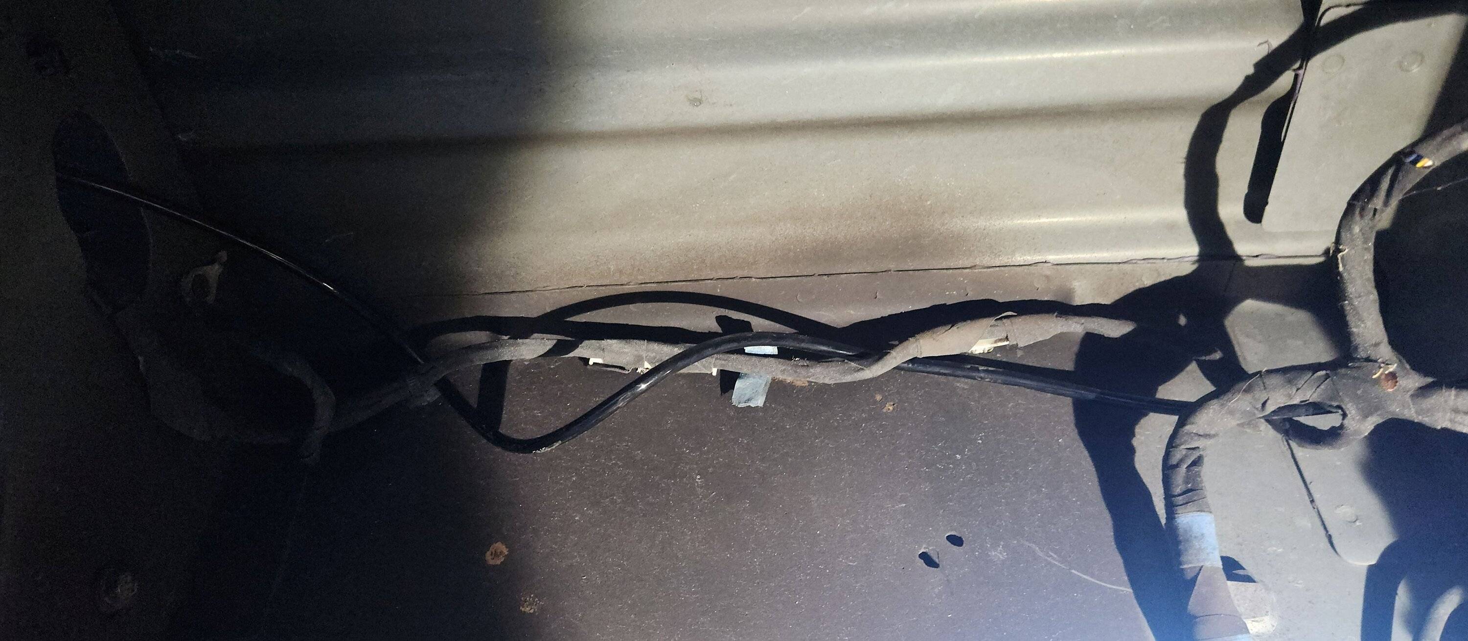

The both come together at the hitch plate
Ford Maverick Air Lift 1000 Air Bag Spring Kit install (2022 Hybrid XL) PD4

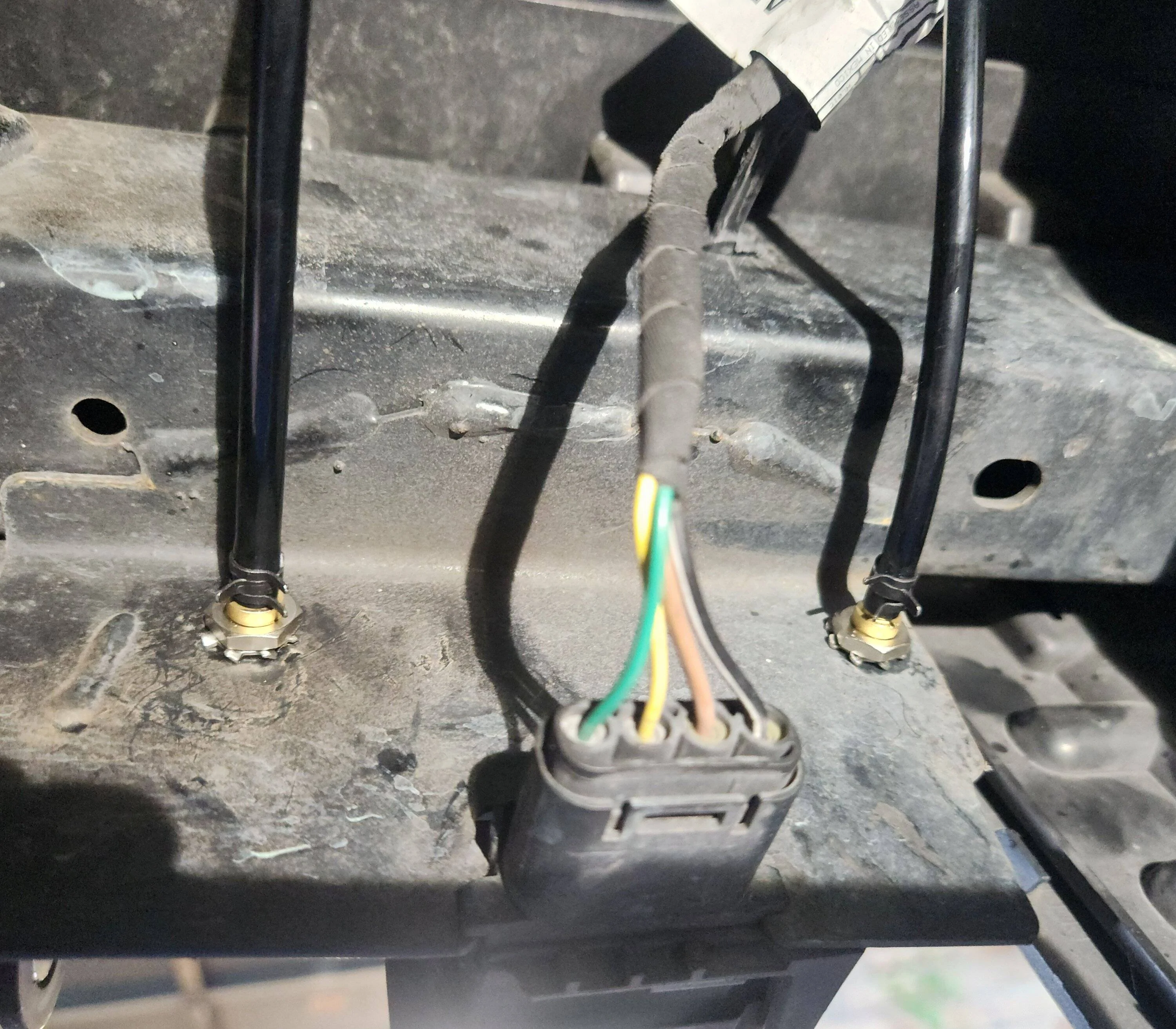

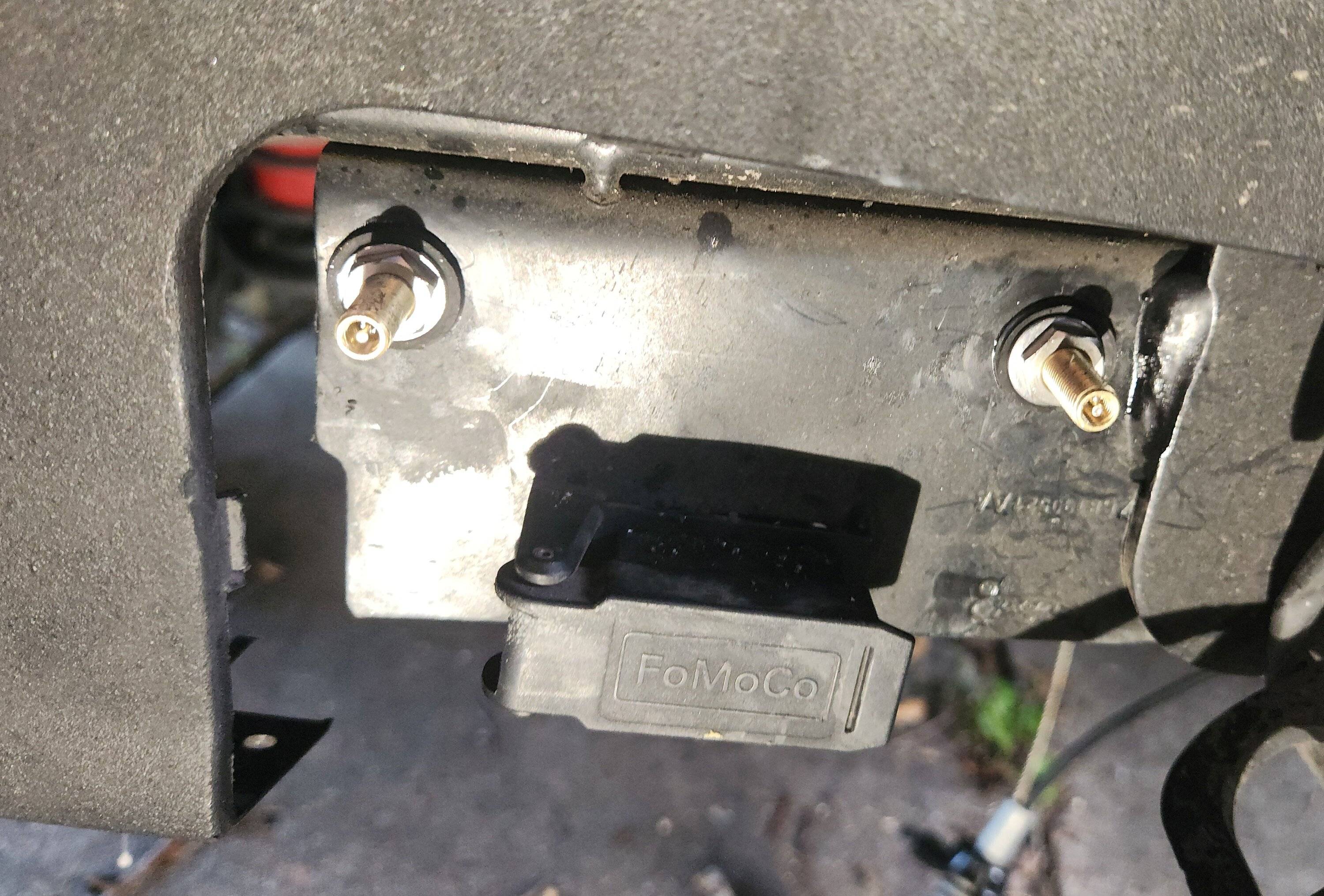

Here's the back and front of the hitch plate
Ford Maverick Air Lift 1000 Air Bag Spring Kit install (2022 Hybrid XL) HitchBack
Ford Maverick Air Lift 1000 Air Bag Spring Kit install (2022 Hybrid XL) HitchFront
This was some tough metal, if you don't have good bits you might want to do it in a plastic piece. I used my Bosch drill bits (Project Farm approved!) but had to step up one at a time. And use oil on the bits, it really does help.

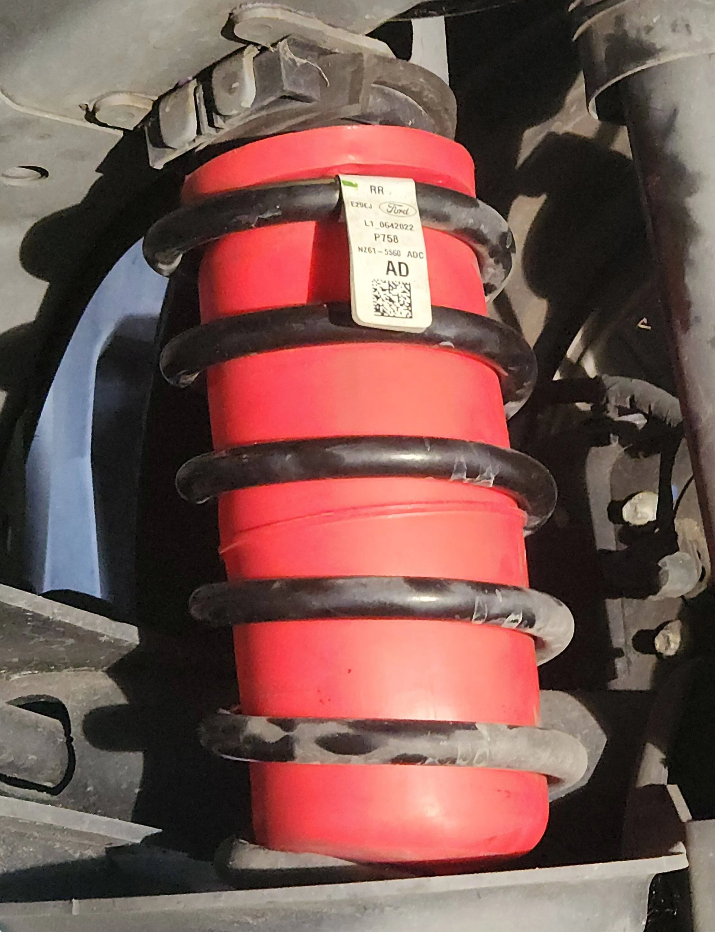

Here are pics after riding around for a couple of days, I have about 10# in there. Seems maybe slightly stiffer in the back but I do feel fine about it, doesn't seem overly stiff and handles possibly better (or placebo effect.)
Ford Maverick Air Lift 1000 Air Bag Spring Kit install (2022 Hybrid XL) D4
Ford Maverick Air Lift 1000 Air Bag Spring Kit install (2022 Hybrid XL) P4
I think this was an easy mod and worth doing. Not expensive and will help when I load it down. It took about 3 hours, but I also tried out the provided jack and tools for the first time. I didn't take the tire off but I did have to lower the spare, and at least played with the jack, but ended up using my hydraulic floor jack, because duh. Of course I used jack stands and blocked the wheels. Another tip, to lower the spare, the big end of the tube goes in to connect with the winch. :crazy:
