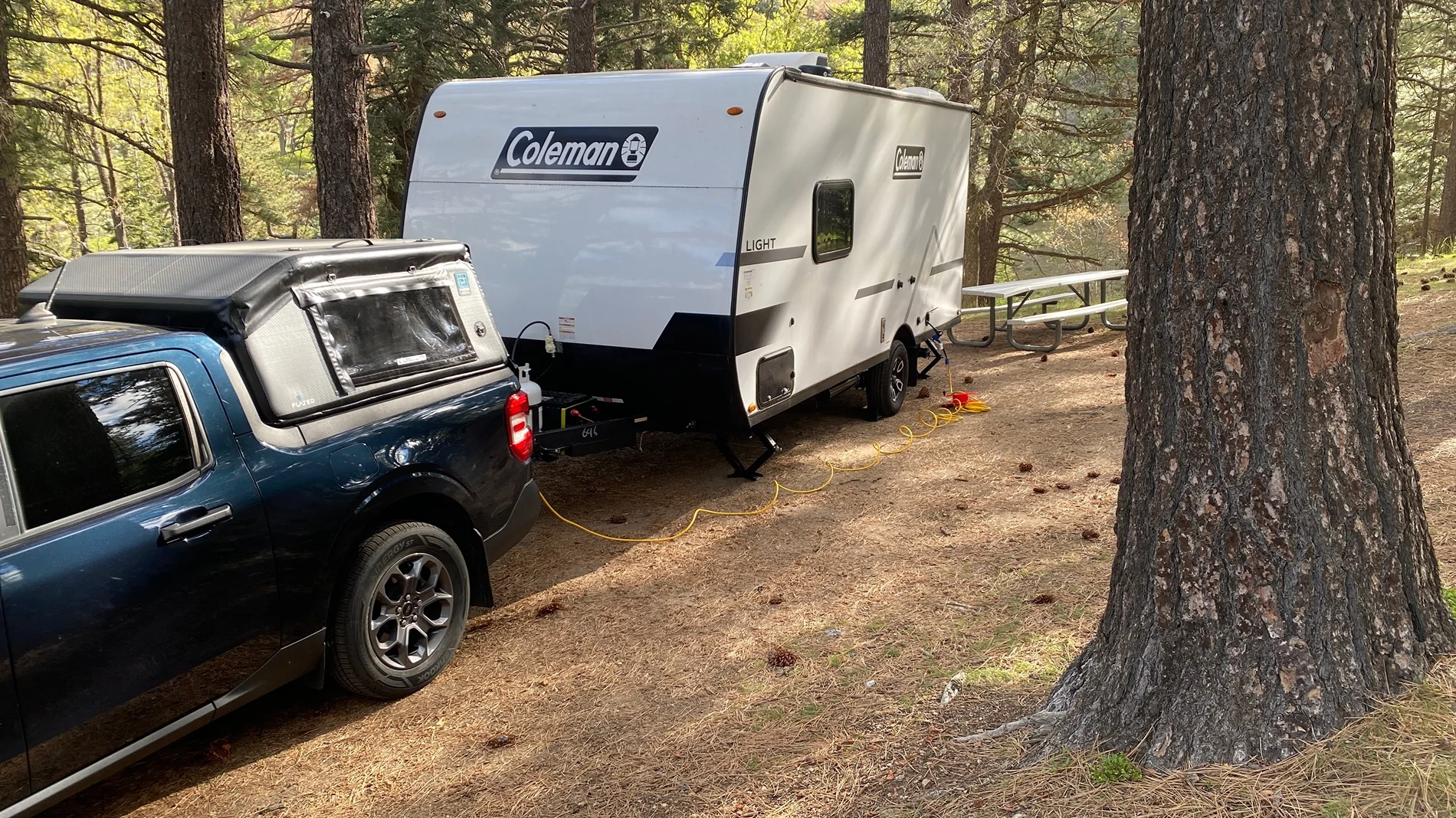

Trailer is 3200 lbs as outfitted. (2750 dry)
MPG when towing is about the same with either an EcoBoost or a Hybrid.
Ecoboost with higher horsepower will accelerate better. But cruising at a steady 60 to 65 mph the trucks would be indistinguishable.
EB could probably exceed 65 MPH without sweating. But should you?
Hybrid will go up to 65 MPH with this:
I usually set Cruise to 62-63 MPH and just sit back and relax.
Slower uphill.
Slower in wind.
Ford Maverick 6500 Mile mountain trip towing 3200lb camper IMG_7857

thank you for the details. is your trailer 7' or 8' wide? what range of mpg have you gotten towing it?

8 feet wide.
19-20 MPG at 55 MPH.
15-16 MPG at 65 MPH.
Don't hardly touch the brakes. That thing is like a drag chute.
(But I have trailer brakes and a properly set up brake controller. Need the trailer brakes at low speeds when wind drag isn't much help.)
