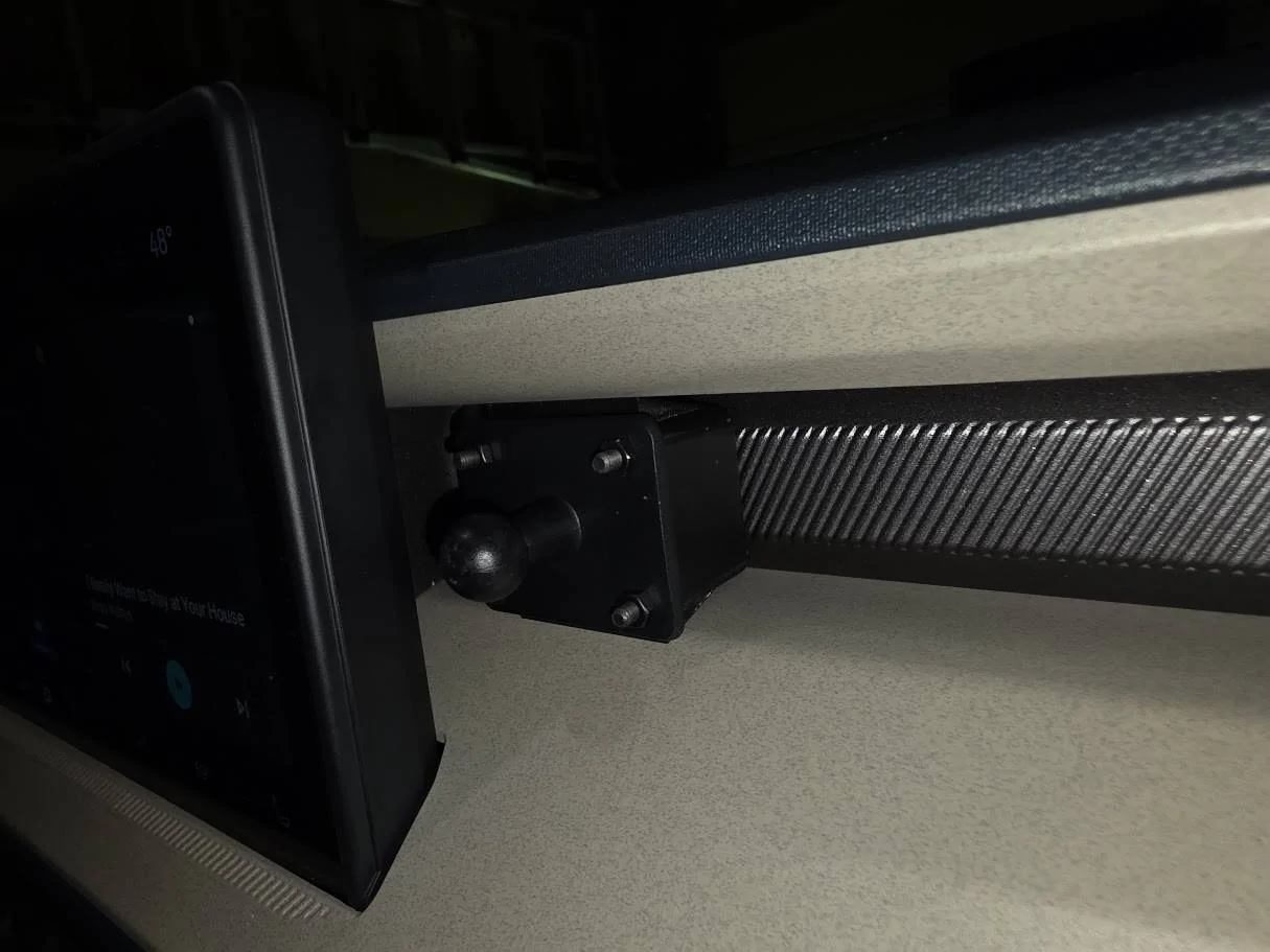

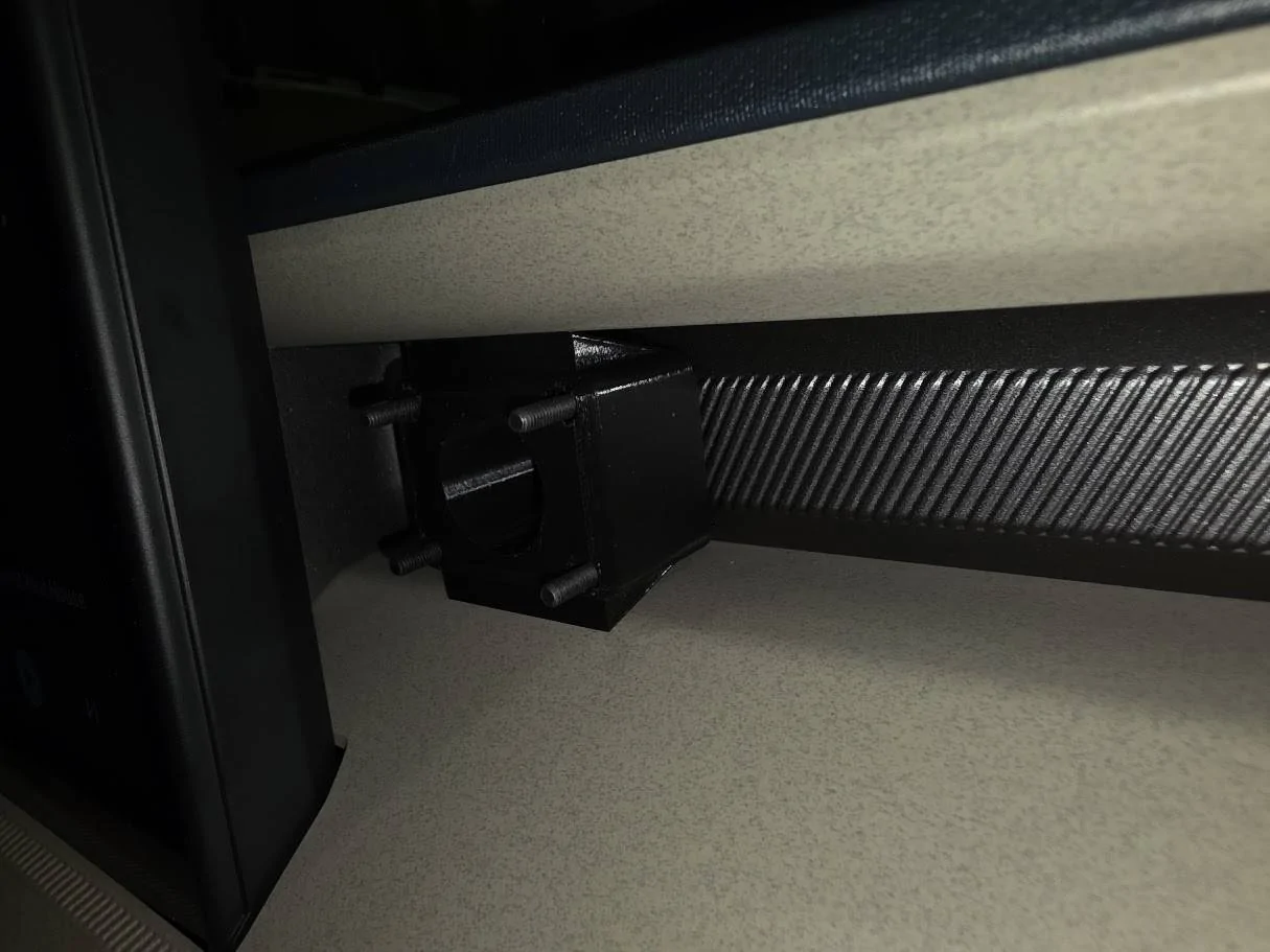

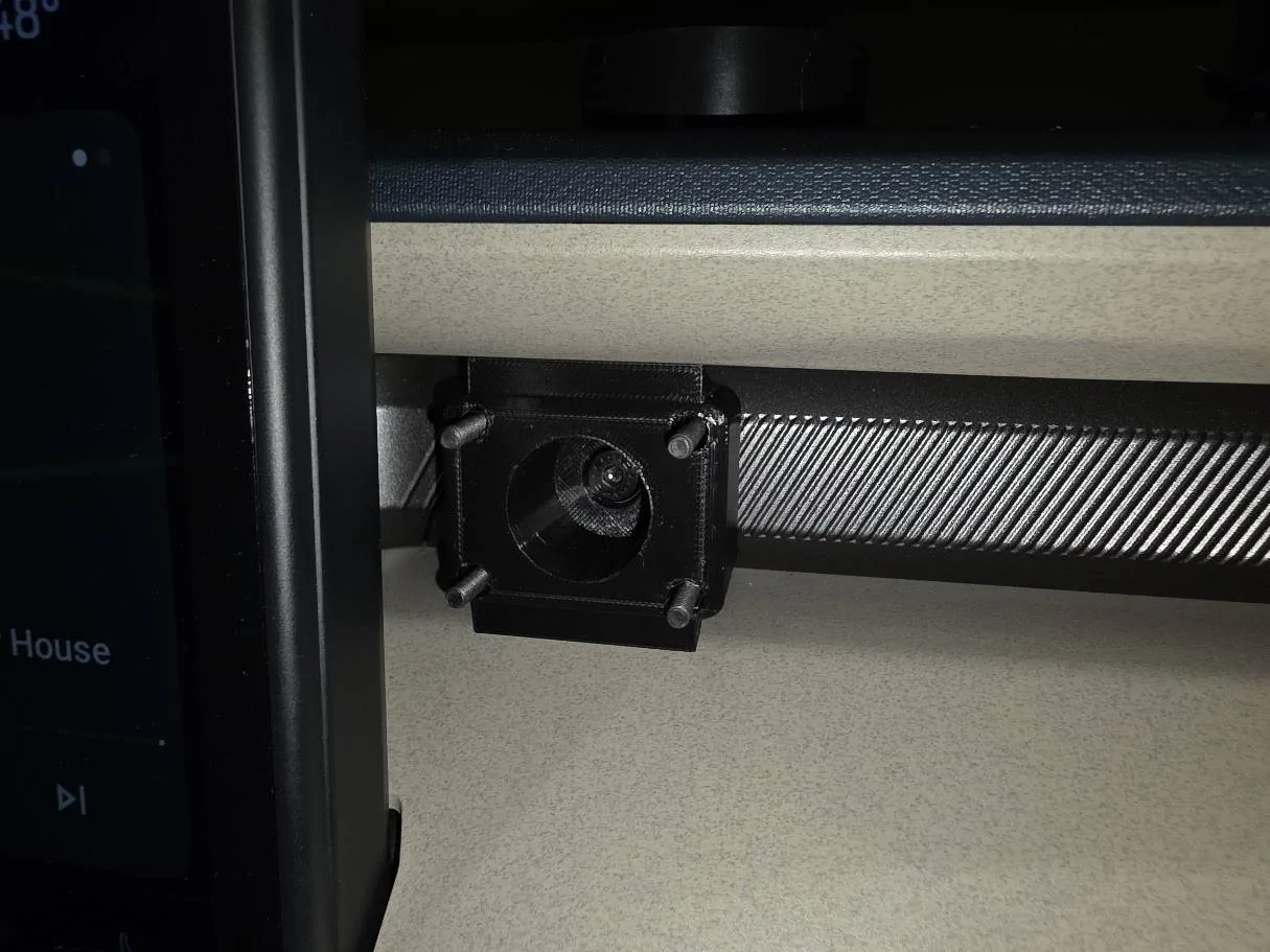

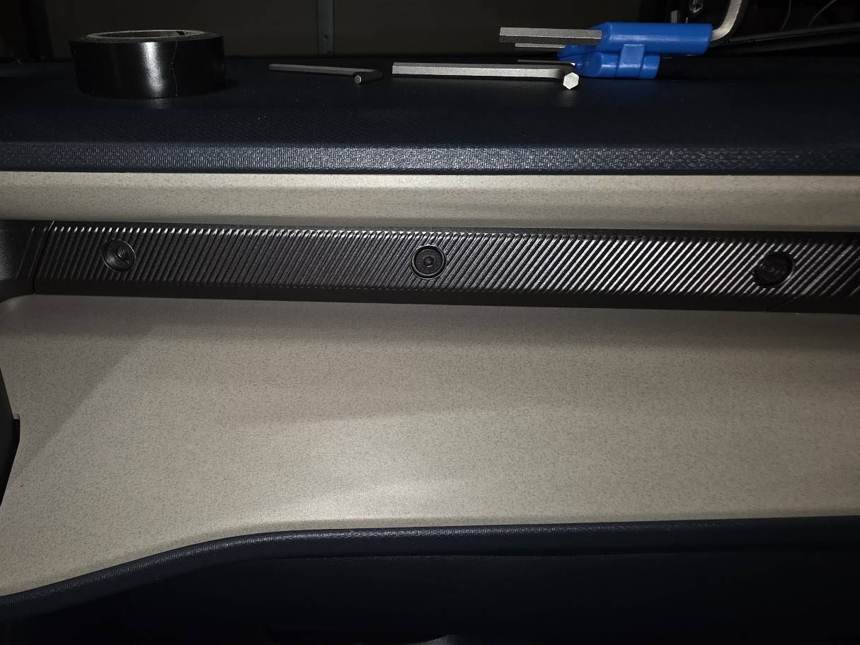

I swear every time I look at the blank space of the dashboard and see those screws there, I just see an opportunity. And so I made a quick adapter to put a phone mount to the right of the screen.
Printed in rapid PETG, still very much a WIP. I wish I could get the same Ford dashboard screws, just slightly longer... STL file linked is the version on the dashboard now, v3 is printing now and will need testing. Also recommend an extension arm so the mount is offset and not hitting the screen. Thinking of also surrounding the print in foam/rubber strip to avoid plastic-on-plastic.

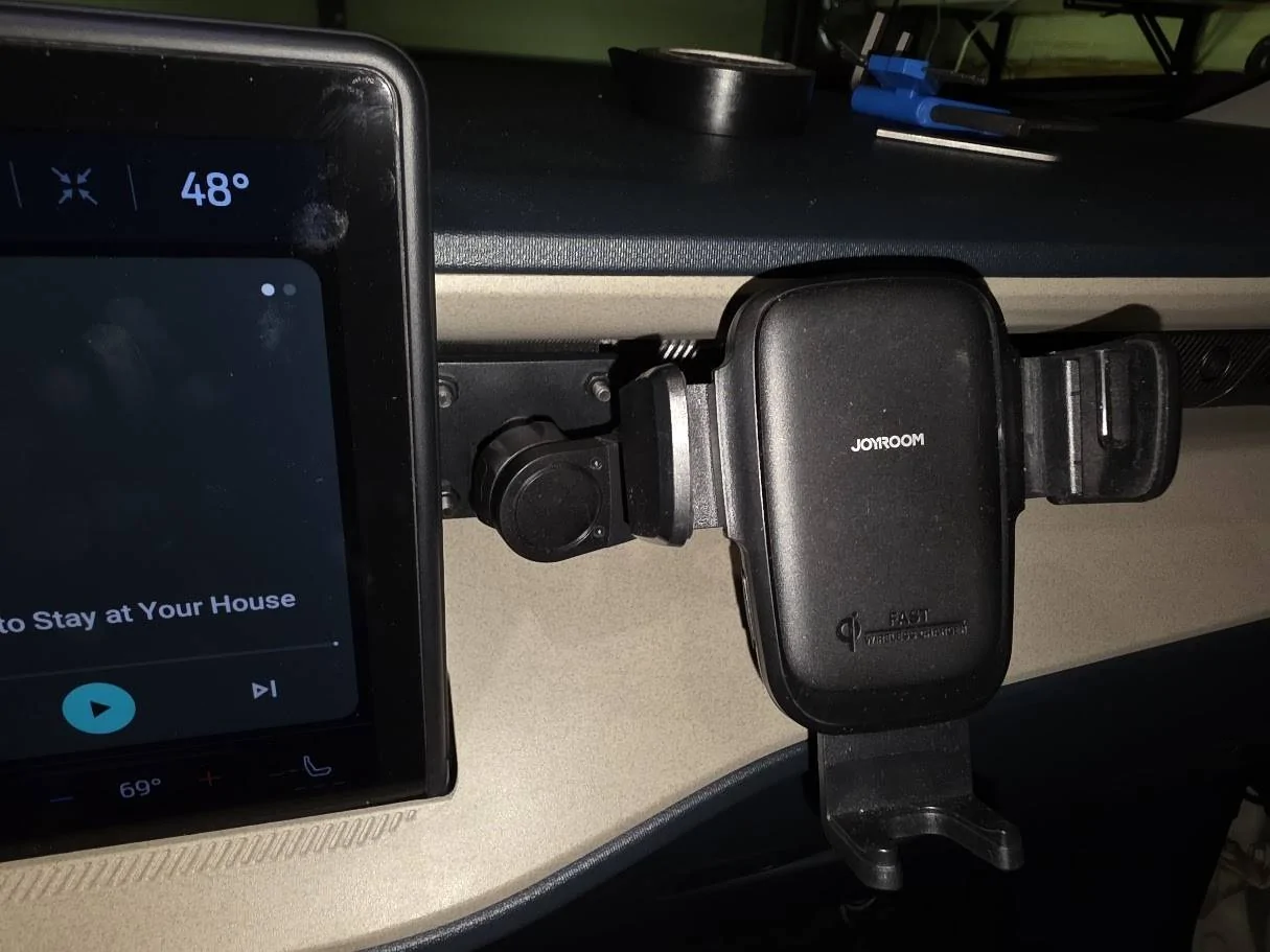

Oh, and the extension arm, and more importantly, the adapter plate I used. Both purchased some time ago and these exact ones are not available, but alternatives are around.

There is some small movement of the dashboard plastic, so it may not be a long-term solution. I think the screw may not be penetrating deep enough since it has to hold on to the part, and I don't want to risk over-torquing the stock screw, so I need to try getting a slightly longer screw to grab on fully.
I think I am going to use double-sided 3M pads to help assist holding it in place at the angled portion when I install v3 later today.

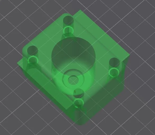

The next one I designed has places for hex nuts at the base of the print so the 4 M4 bolts don't keep spinning as you assemble it. Version 1 used smaller diameter holes that the bolts grabbed on to, but I don't want to risk print integrity.
