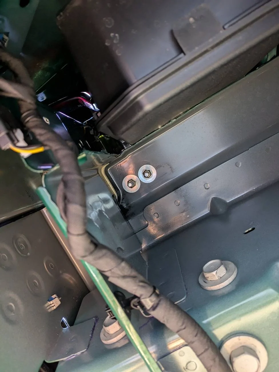

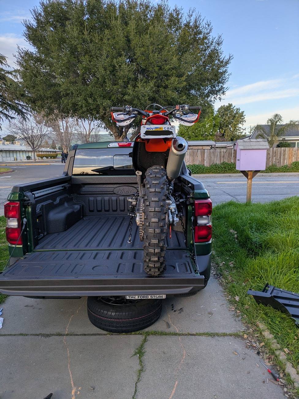

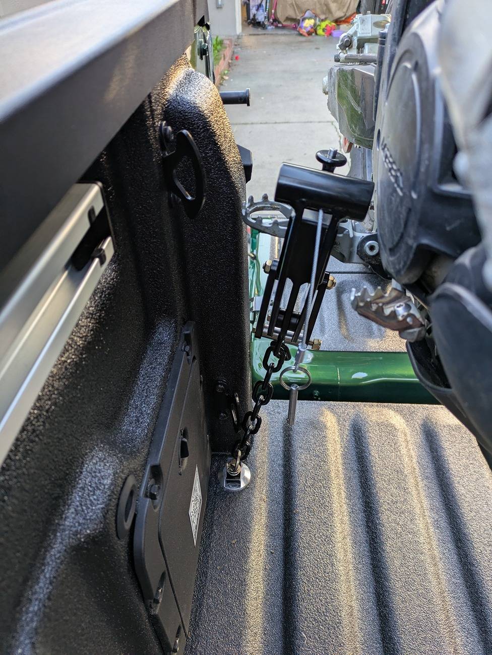

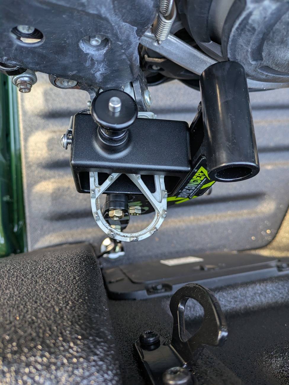

I figured I would share this in case it helps others. I installed bike binderz for hauling my dirt bike on my maverick. It appears to work and could support two bikes but it is tight. The install went fairly well. A couple of notes
  1. You do have to remove the funky plastic cover on the passenger side for the outboard plate
  2. You are most likely going to have to choose the exact spots I used. The reason for this is there is a lot of stuff and frame rails in the way of drilling holes that can be accessed from underneath the truck

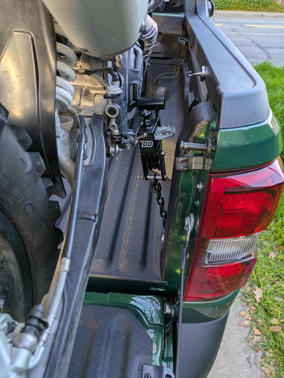

  3. The outboard binder gets really close to the vertical bed frame rail. I would just kick the rear tire over a bit to the center to prevent contact. I would not install the plate more inboard as you will not get two bikes in if you do
  4. The outboard binder has more angle than I like but moving it in board one space places it above the frame rail which makes underside access impossible
  5. I would drop the spare tire before lowering the tail gate and putting a bike in for test fit. I found this out the hard way and loaded/unloaded the bike several times

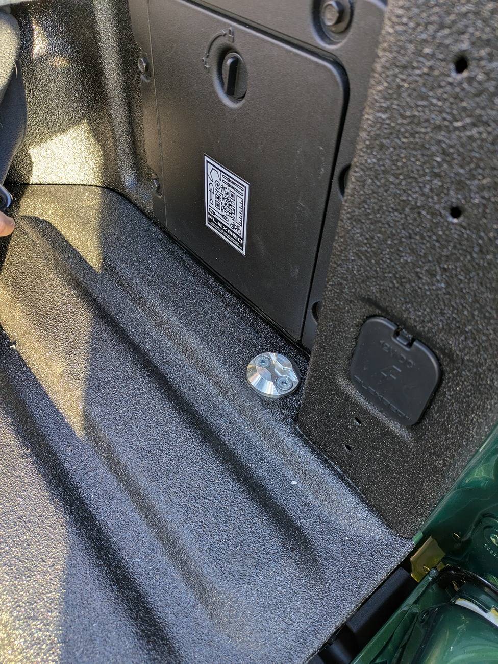

  6. I originally wanted to put the tie down points in the valleys of the corrugated bed floor so the top of the bed floor was smooth but this is not possible as the valleys are not wide enough
  7. I would recommend fabbing a backing plate for the underside of the tie downs. I wanted to use that on the outboard but there was no room
  8. I would also recommend deburring, painting, and sealing the holes with rtv during the install to prevent rust
  9. A strong magnet on the top side (where you want the mount) is useful because you can find the spot underneath by sweeping a nut across the underside until it sticks. This really helped me nail down the mounting points which where definitely not where my initial ideas or intuition was leading me -> AKA measure twice drill once
Hope this helps others. Overall I like the bike binderez a lot

I was really surprised how well a bike is held in the bed when tied down by the foot pegs. Whether you use bike binderz or not I am a convert to strapping by the foot pegs now
