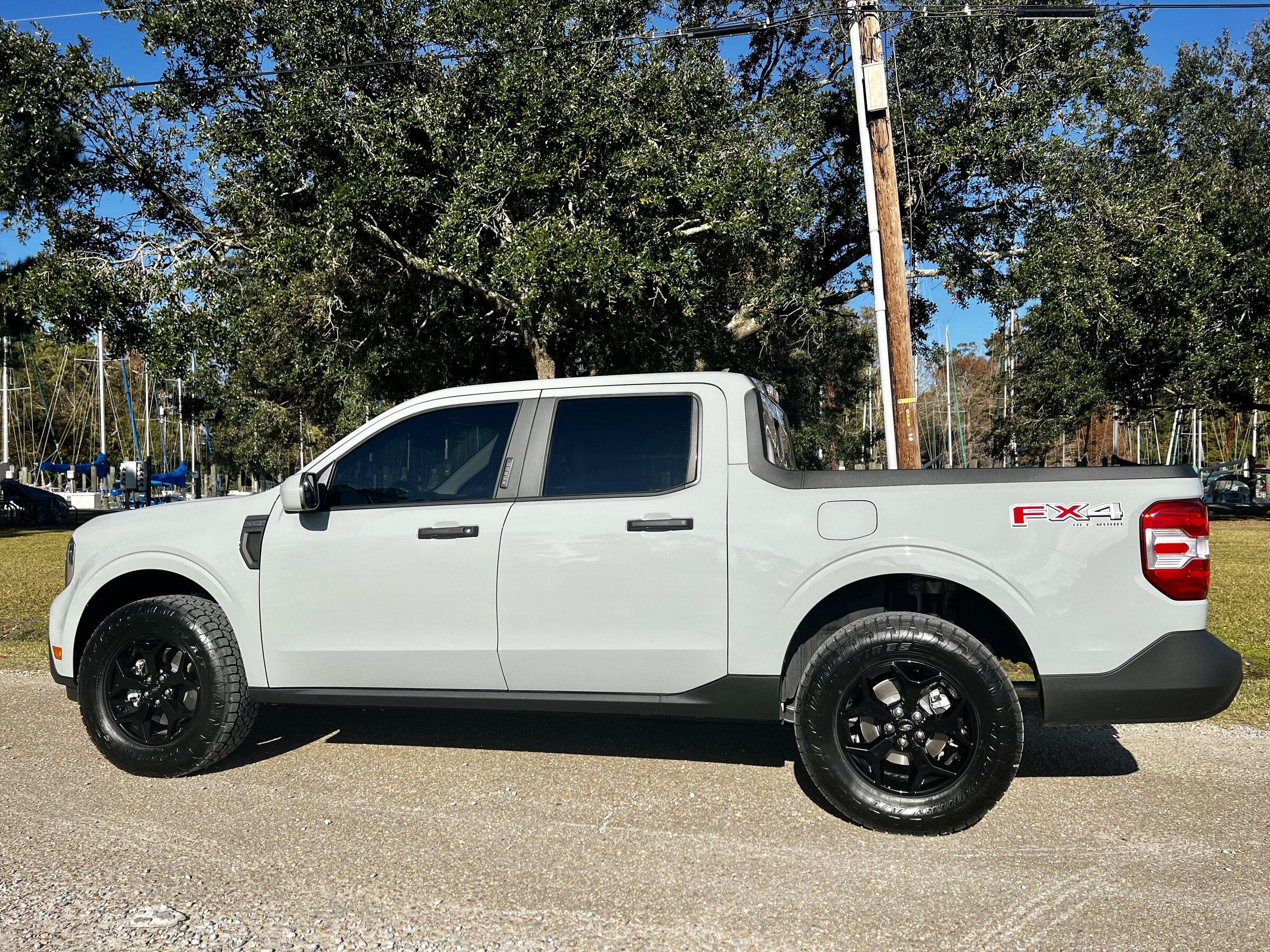

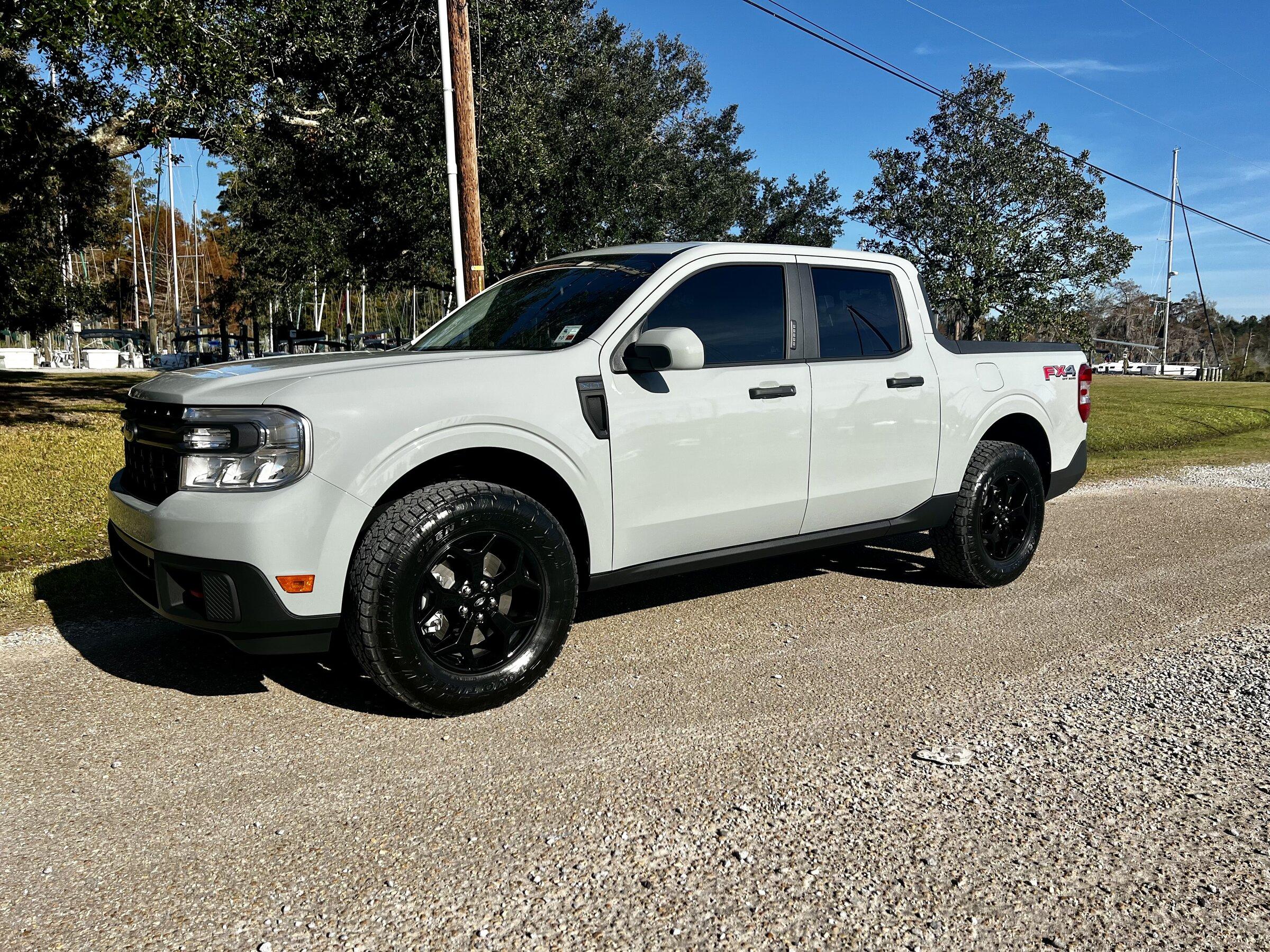

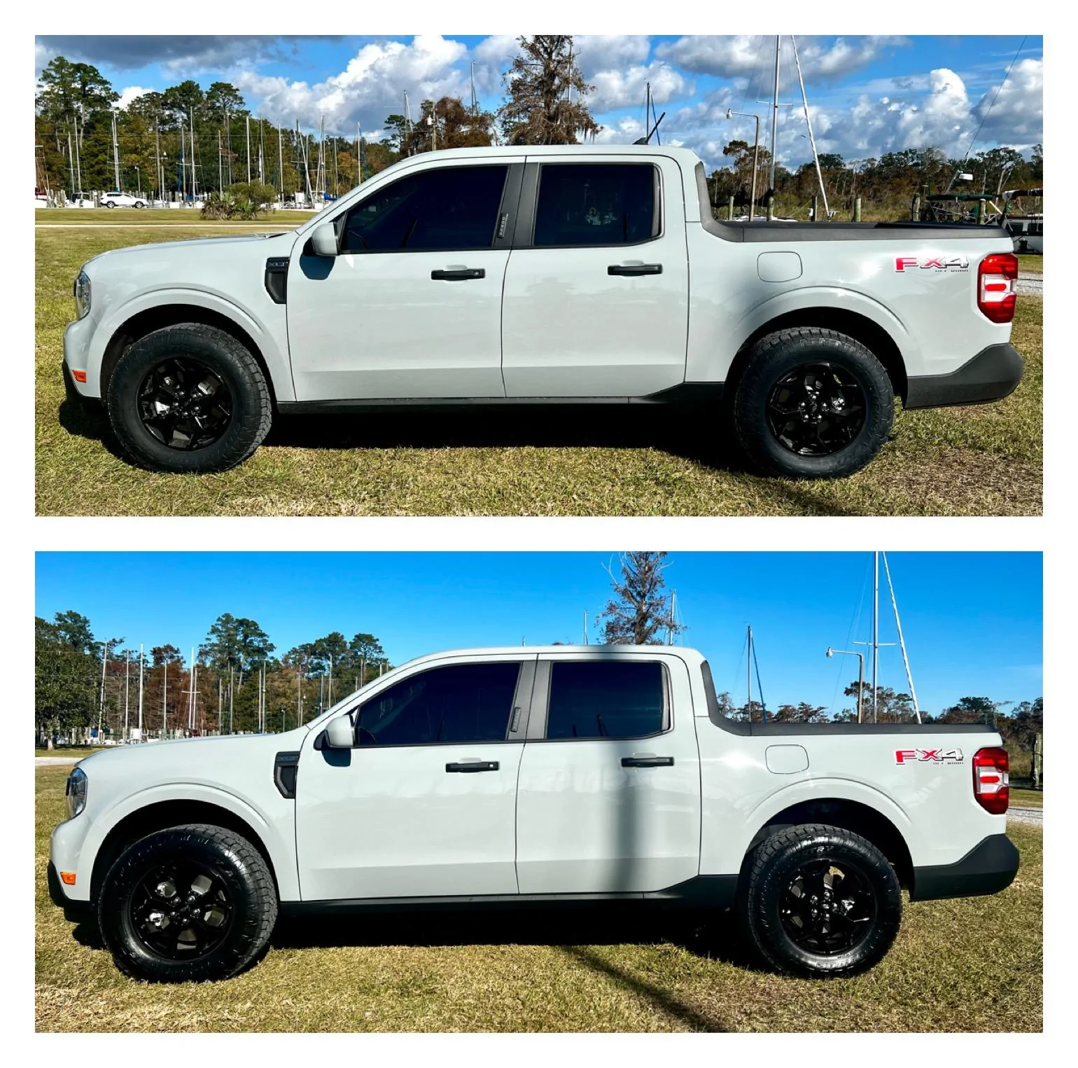

Installed the lift this morning and drove straight to the alignment shop. I’m very happy with how this turned out. Plenty of ground clearance for my needs without looking overly aggressive. I wanted a lift/tire combo that looked like it should have come from the factory and, for me, I have achieved that. I have no inner fender rubbing, however, it is close at full lock. I have no need to trim anything, which was one of the goals of this set up.
Lift: 4 Wheel Parts (1” front/.75” rear)
https://www.4wheelparts.com/p/4-wheel-parts-factory-leveling-spacer-kit-62207k/_/R-4WPBR-62207K
Tires: Toyo Open Country AT III (245/70r17)
The split photo shows with tires only at the top and with lift and tires at the bottom.

Damn that looks Good!!

Beauty!

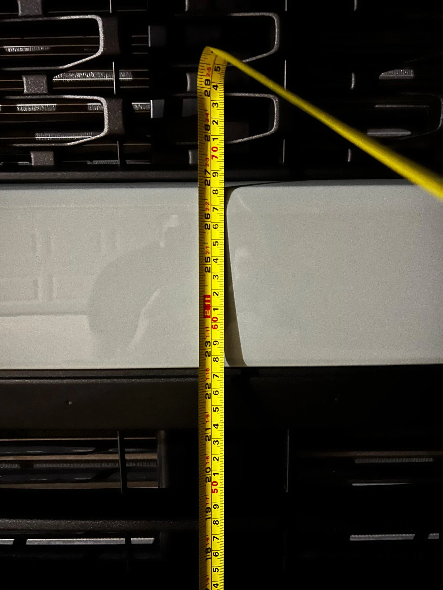

Looking to do the same ! Can you measure how much clearance the lower front valance/bumper has after the lift ? Thx-

Looks really great, how hard was the install ? Have you done this before? I think it really makes your Mav looks more trucky, def the look I am going for, let us know any updates on driving feel and mpg.
Again looks great!

10.5” at the lowest point nearest the front tires.
I mean middle front right under the license plate mount of those of us forced with front plates ?)

With the tires installed was there any rubbing before you added the lift?

Install was not bad, very straight forward. I’ve installed 4 or 5 sets of coil overs over three Miata’s in my life. This took my buddy and I about 3 hours working semi leisurely. Ride feels just like factory. Appreciate the kind words!
Nope, had the 70 profiles on for about 300 or 400 miles before today and no rubbing.

I think this is the real sweet spot. No hate for those who like the 1.5-2" lift, but this just gives it that last little nudge it needed to look really great without throwing off the dimensions or design.
I think this is what you’re looking for. You can see one of the two dimples for the front plate. Soo somewhere around 21.5-22”? Hope that’s what you needed.
