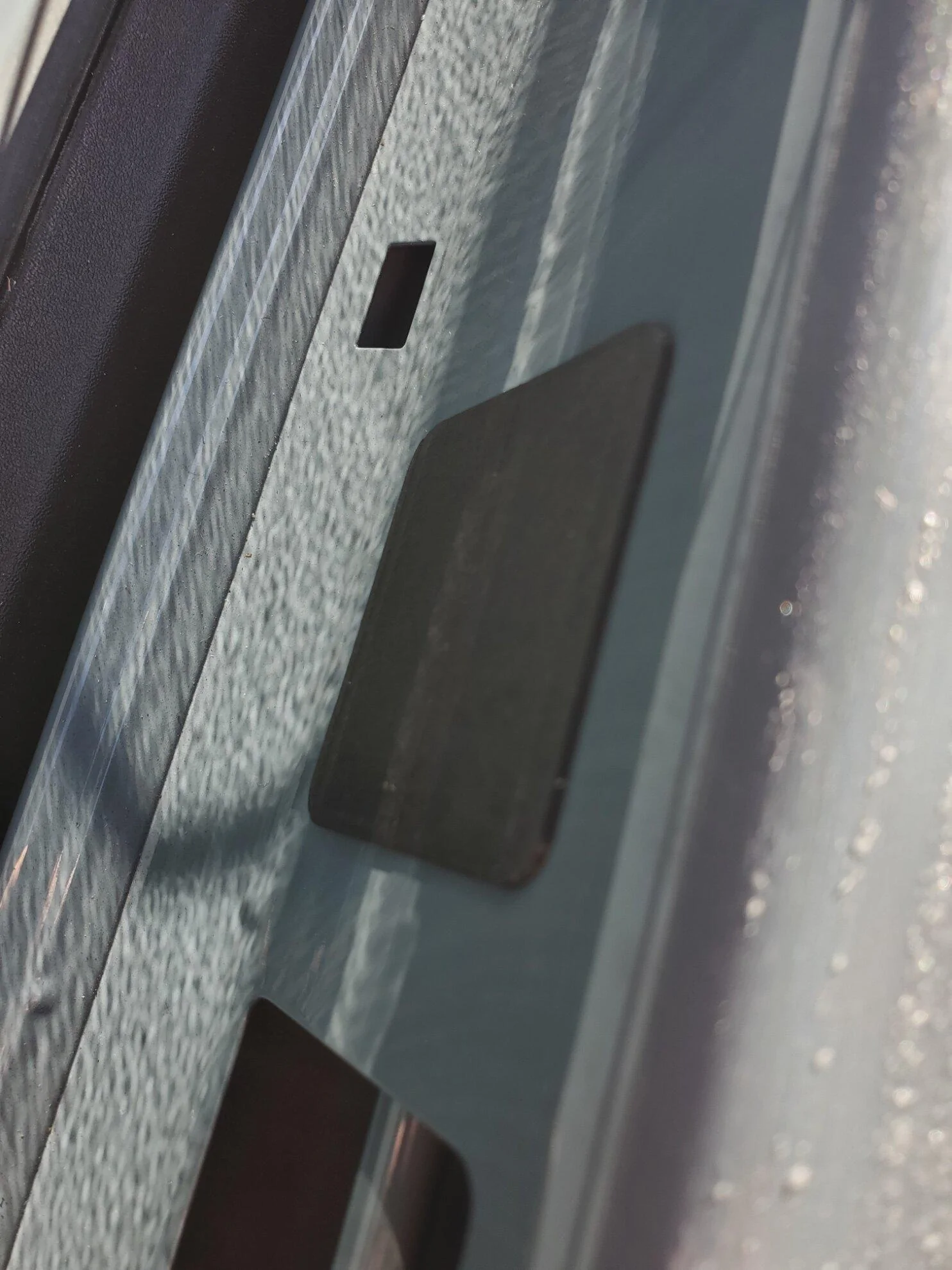

Just wanted to give a shout out to the designer of these pieces! I downloaded them from thingiverse and printed them today. Perfect fit on my maverick.

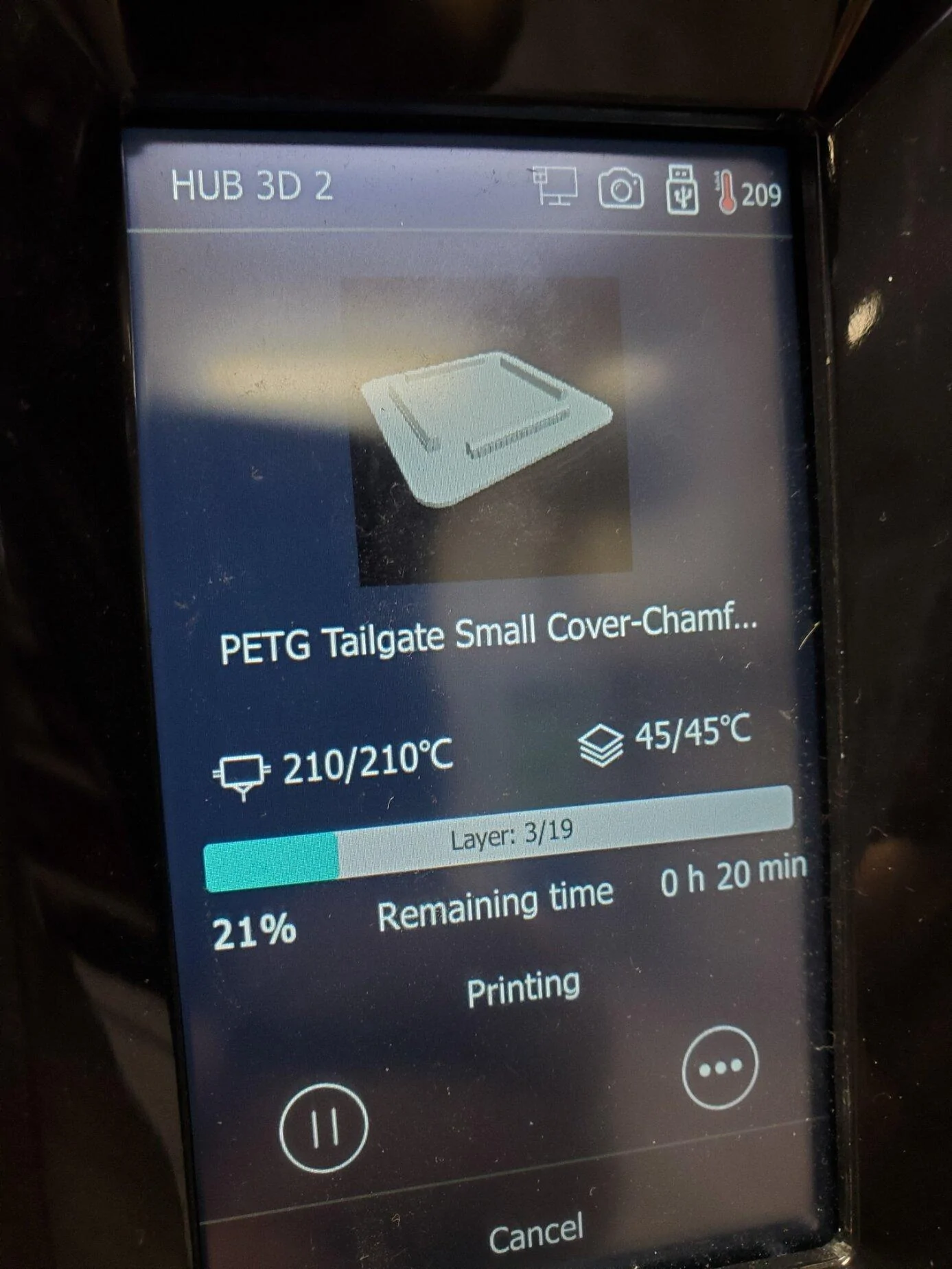

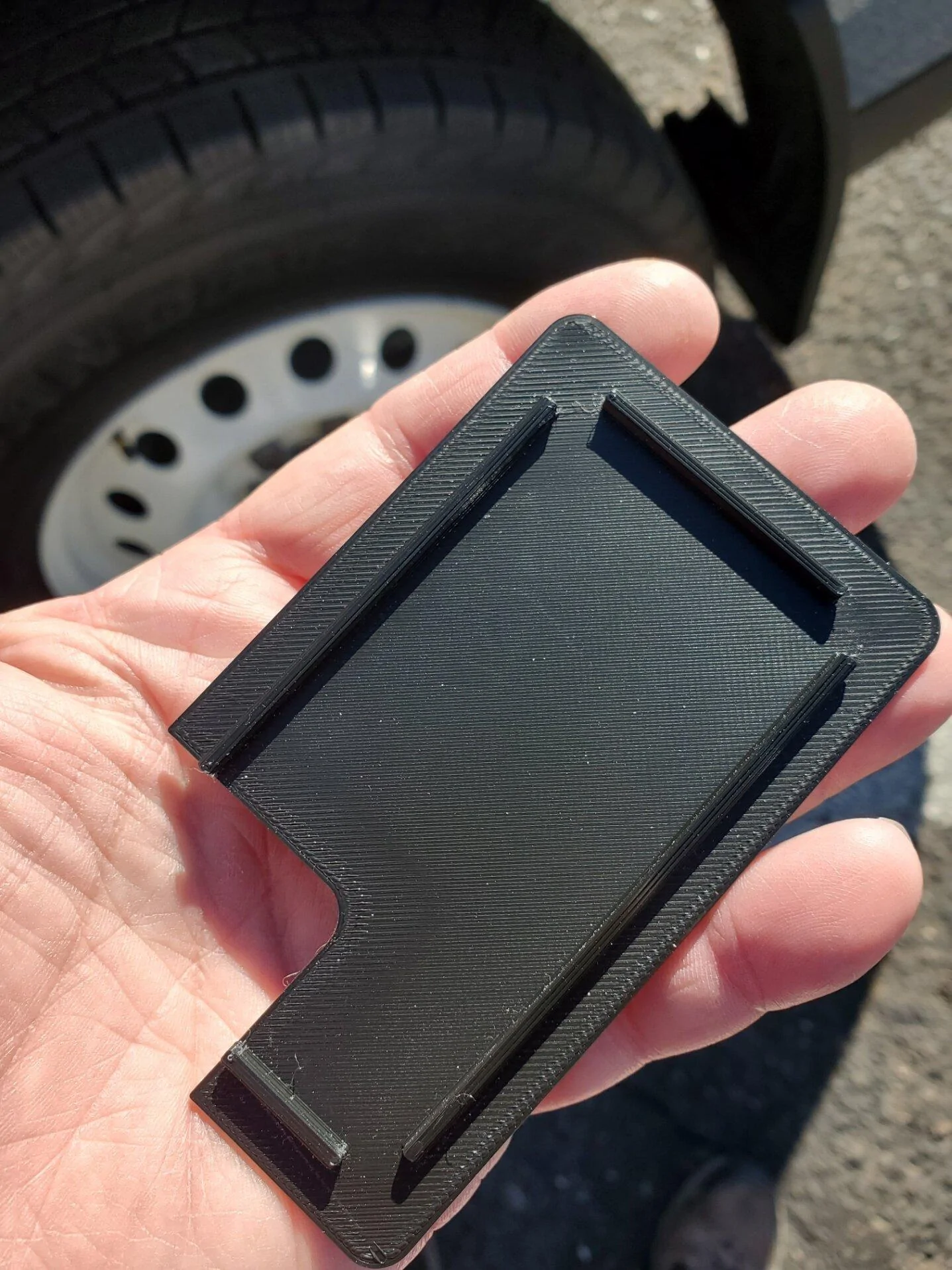

I printed these yesterday and they are a perfect fit... Printed in Black PETG and took right at an hour...
...This is the link if anyone wants to print it themselves.

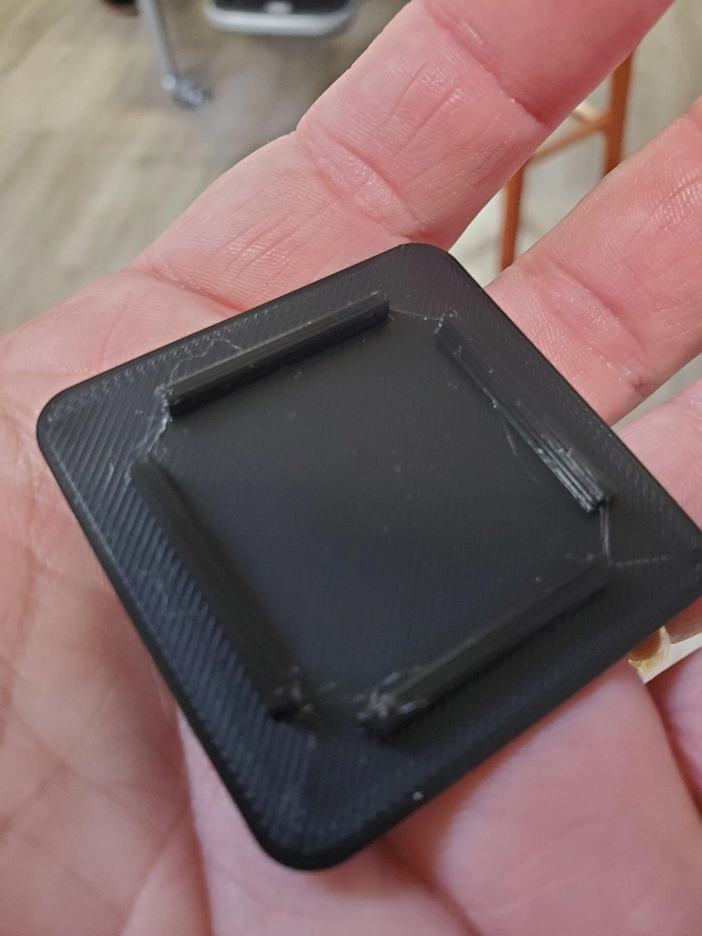

The PLA is fairly rigid, but the design is very straightforward. I did include supports under the clip edges.
Ford Maverick 3D Printed Tailgate Hole Caps Small into

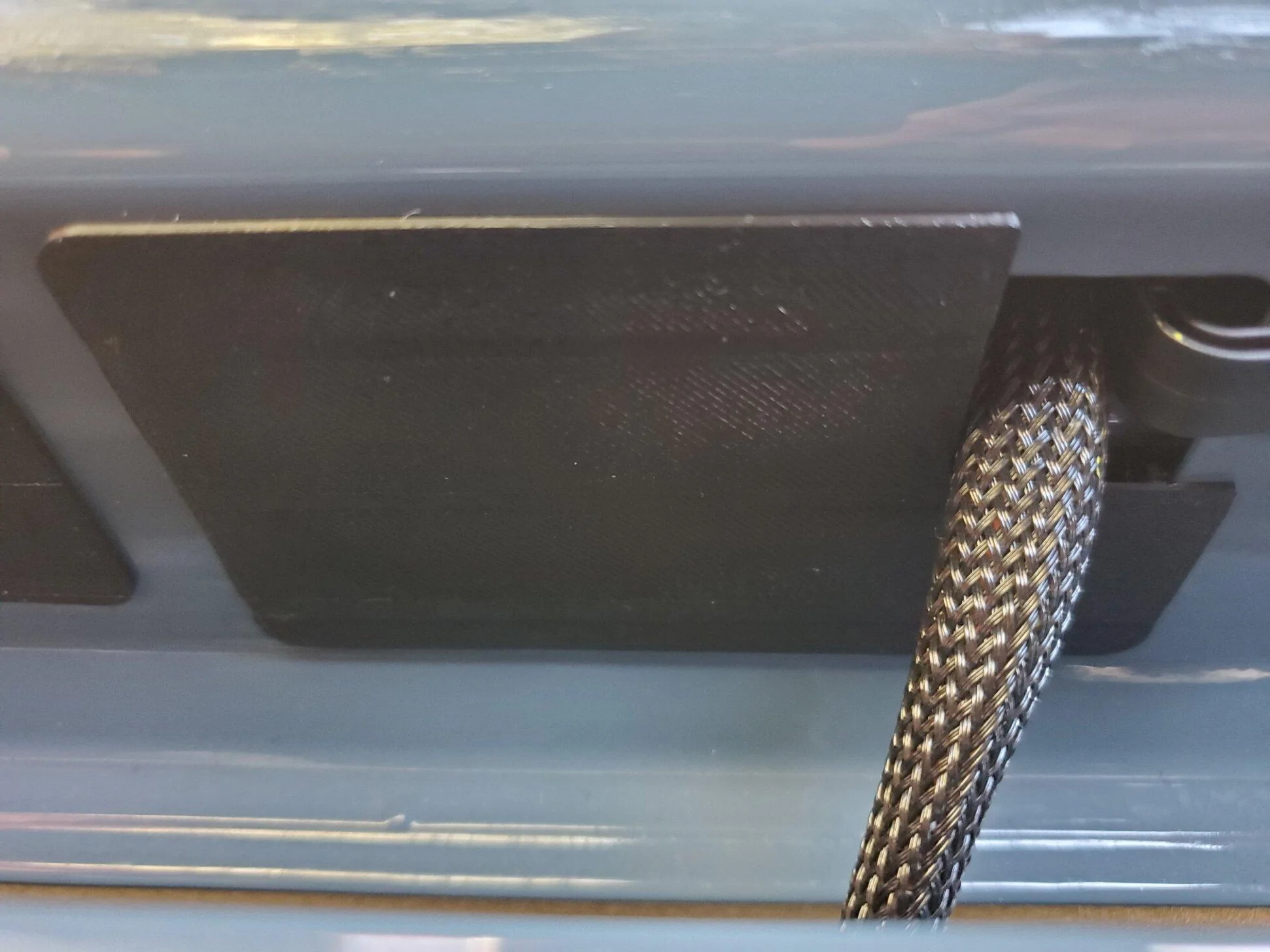

With the support elements removed, it fit easily into the hole in the tailgate, with a mil or so of tolerance and slide in both directions once seated.
Ford Maverick 3D Printed Tailgate Hole Caps Small installed

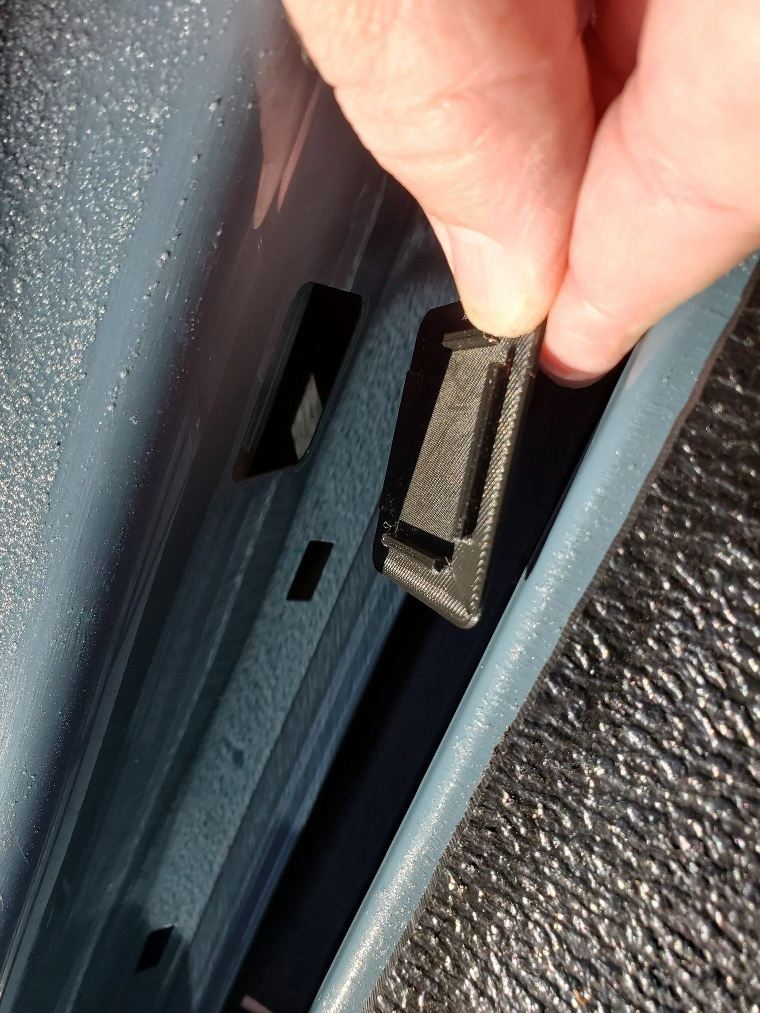

The larger piece took about 35 minutes, and again, I included supports under the clip lips that were easy to remove once the printing was complete.
Ford Maverick 3D Printed Tailgate Hole Caps Large alon
The piece clicked into place easily. Once installed, the larger piece had no extra tolerance, being a snug fit without any slide.
Ford Maverick 3D Printed Tailgate Hole Caps Large installed
Printed in black PLA, so they may not last forever here in the desert where rigid plastics deteriorate to become brittle and are subject to cracking. However, as a learning project they were great, and the finished product looks very OEM.
More likely they'll get too soft and deform to the point of falling out. PLA starts to get droopy at relatively low hot temps so something like PETG or ASA is more ideal for a hobbyist (PETG is kind of a PITA though) or ABS/Nylon if you don't mind even fussier materials.

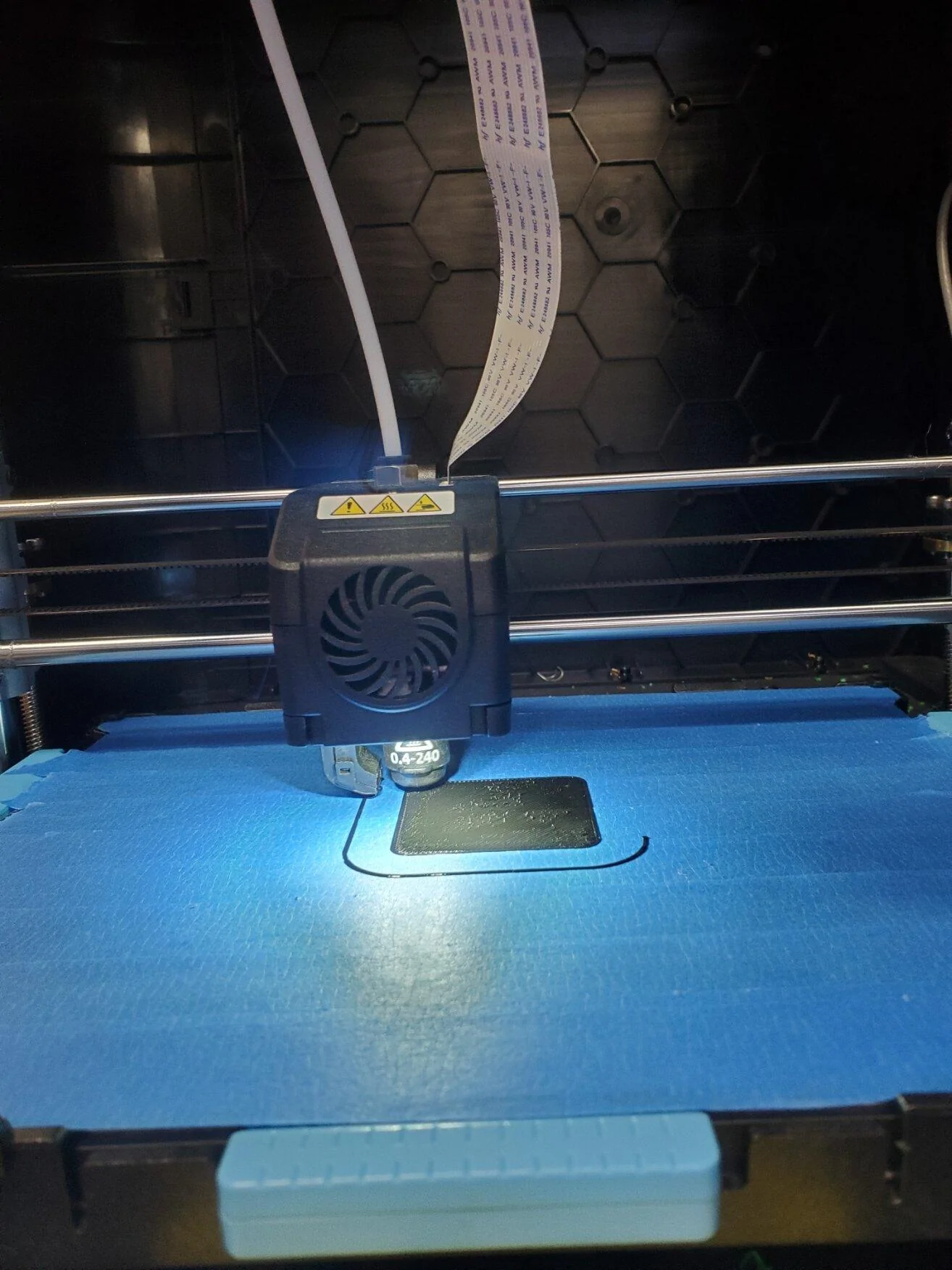

What's the reason for the masking tape on your print bed?

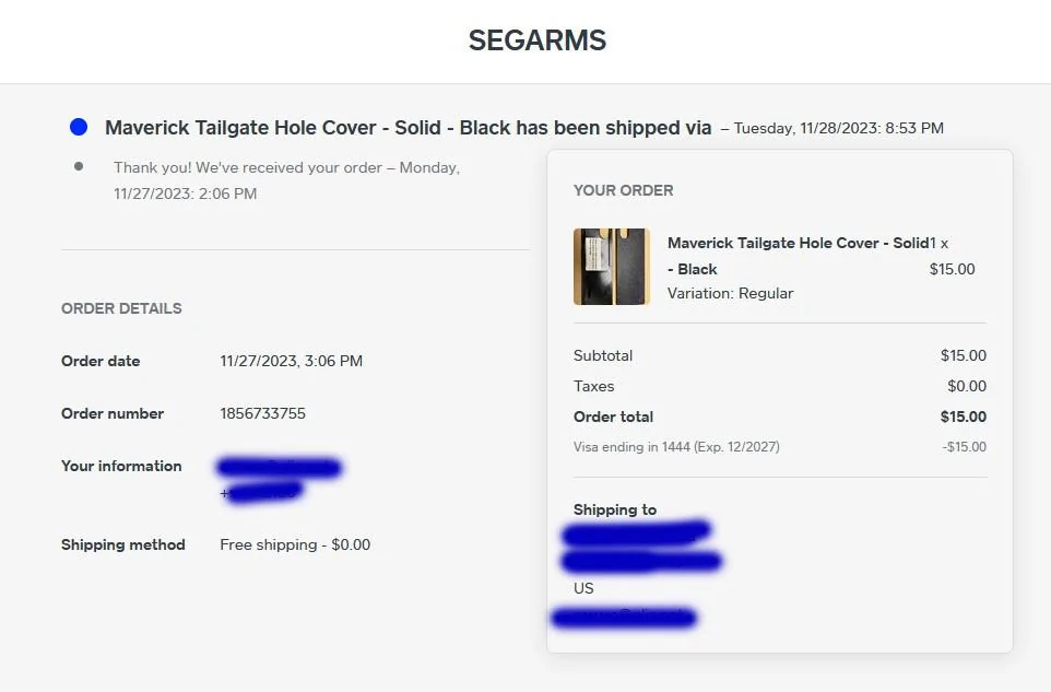

Just a heads up to everyone here, I placed an order on 11/27 for the tailgate hole cover, received a conformation and charged to my CC card, says they were "shipped", however, I have not received anything yet....
Anybody else in the same boat?
The maker indicated that the blue painter's tape helps taller items adhere to the base platform.
Taller items apparently tend to slide or slip a bit on the X- or Y-axis without it, so that the elements that are higher on the Z-axis get out of position as the lower, base portion of the item moves on a slippery surface.
I was worried that the covers I printed would be difficult to remove from the bed, but they came off without any problem.
PETG was my first choice, but PLA filament was free and the maker told me that as a learning activity it would be fine, and I can bring some PETG filament and print the covers out with that if the designs worked.
The designs seem really excellent, so I will probably order some PETG in the new year. Unless you strongly recommend some other filament to me that would be a better medium or longer lasting for hot, dry weather?

I hope not but am happy to send another out to you.
I didn’t use trackable packaging for most of the orders. They are now tracked due this exact issue.
I sent you a pm. Let me know.
