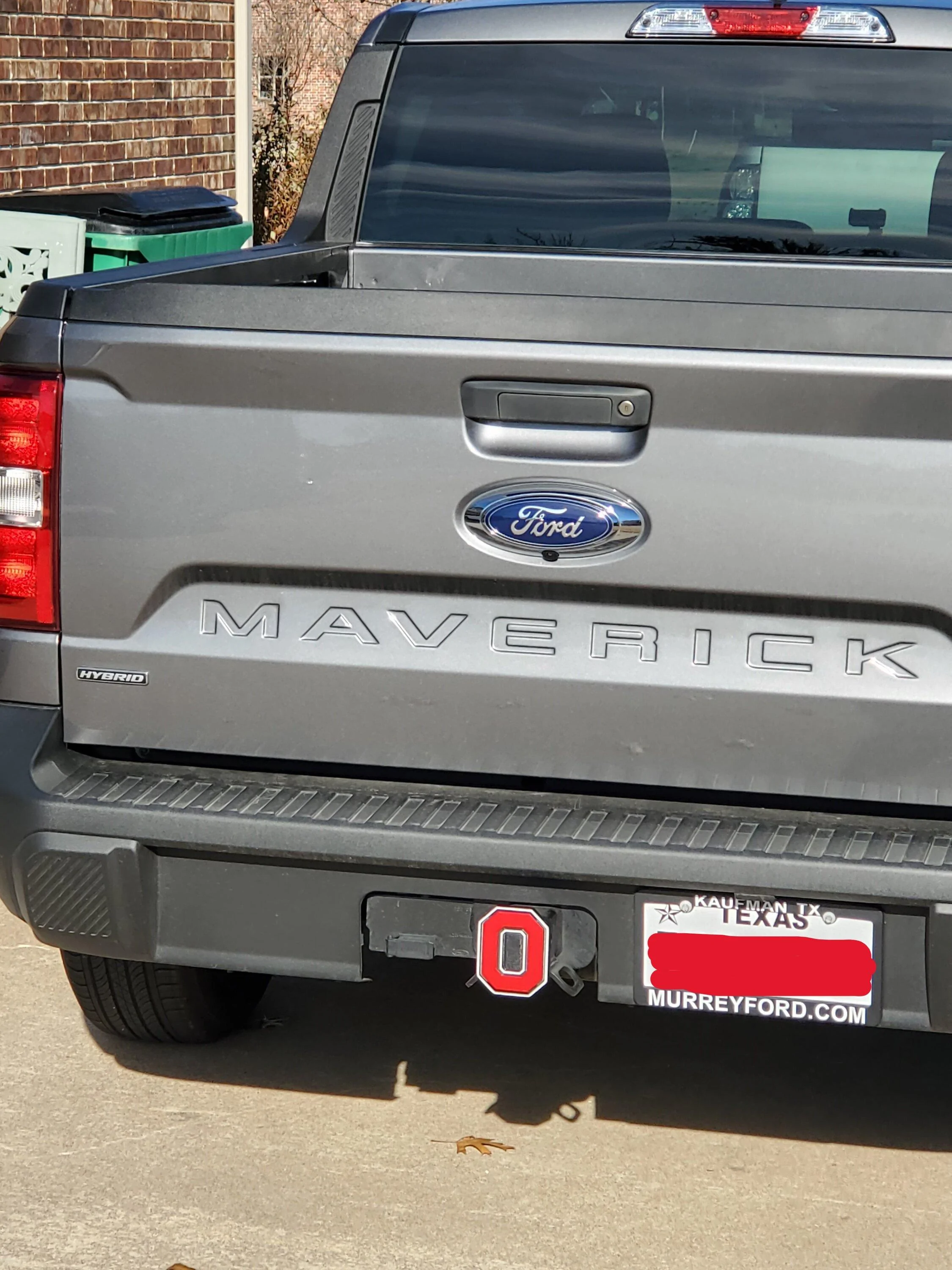

My son printed this for me. Quick paint job and UV clear. We will see how long it last in the sun.

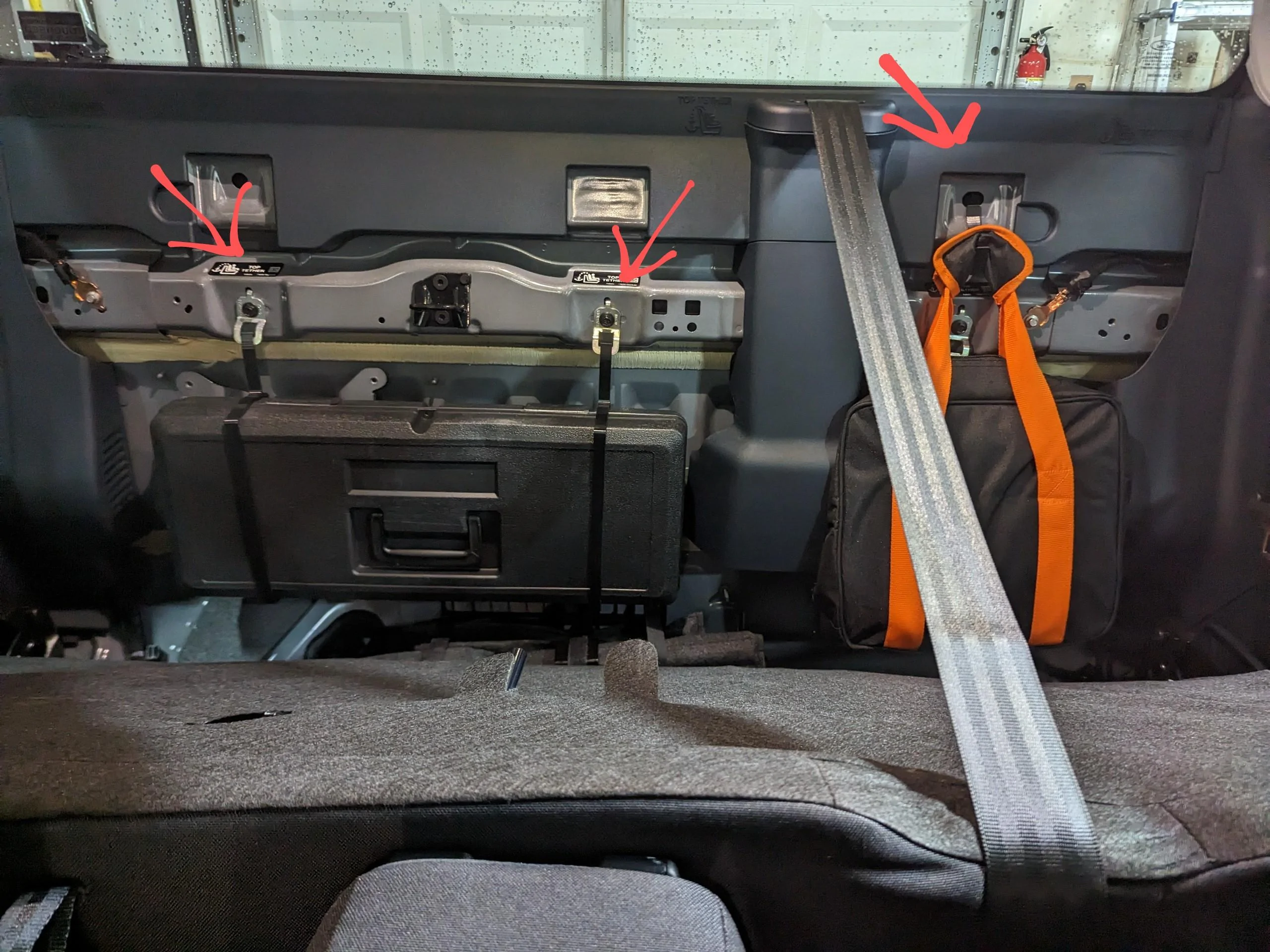

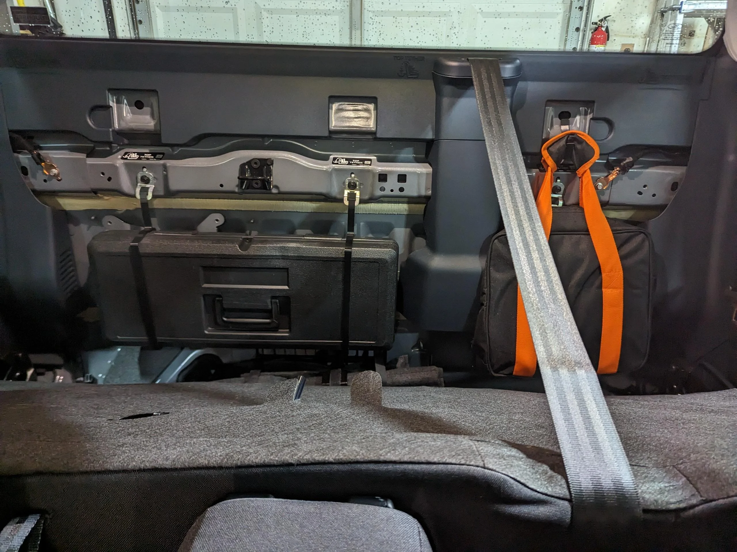

Behind the seat storage: printed brackets to hold crappy harbor freight emergency tool kit (left)and tow strap kit (right) neatly behind seat using existing holes / brackets on the truck. I'm a little OCD and didn't like the toolbox getting wedged in under the seat.
Toolbox bracket

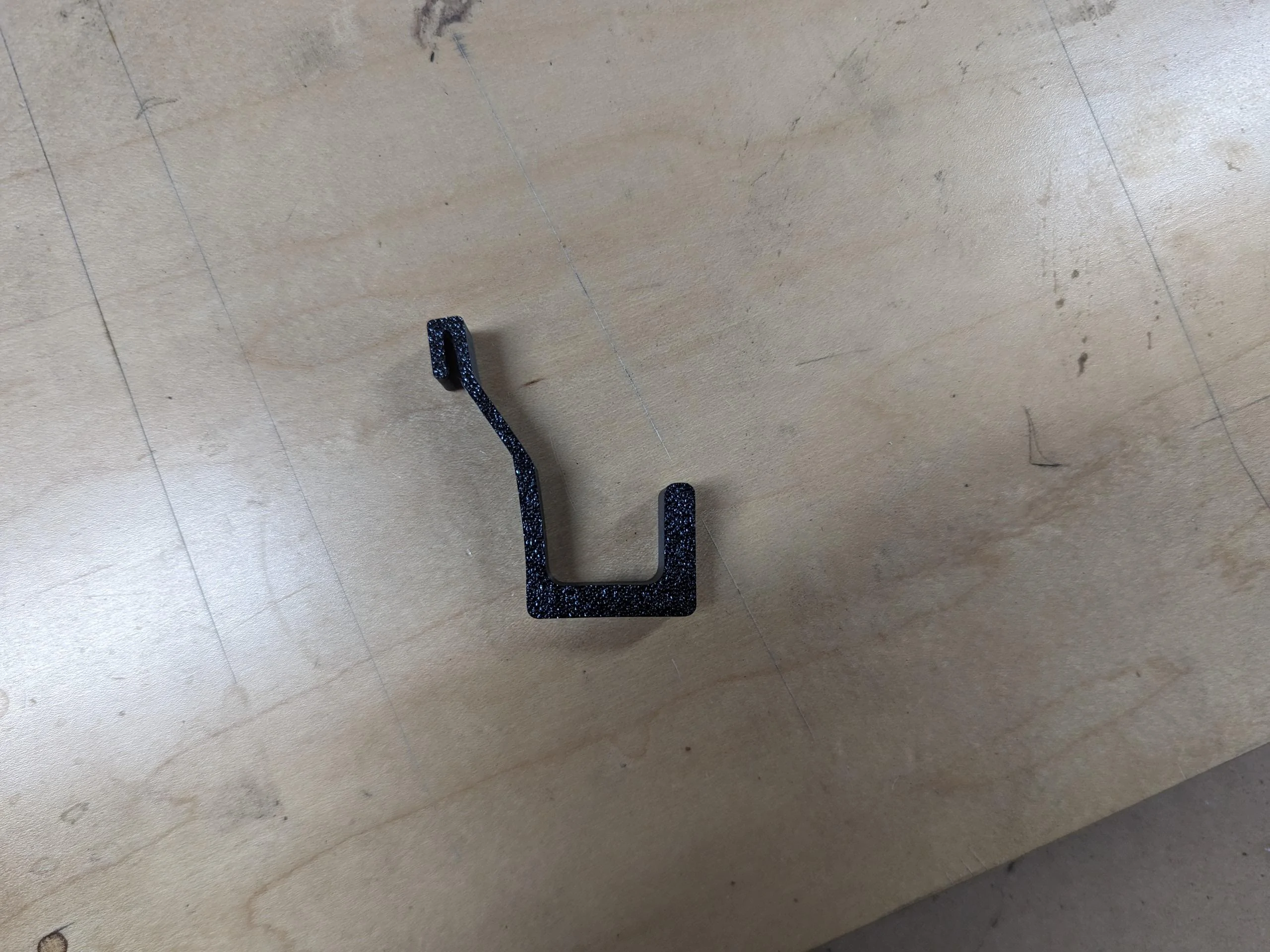

Hook for tow strap kit (I'll probably redo this to be more of a round hook but it works)

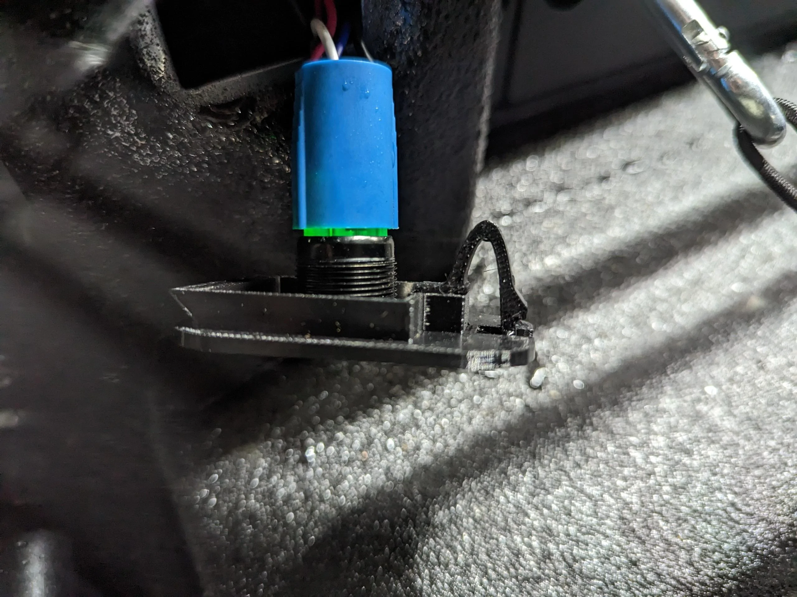

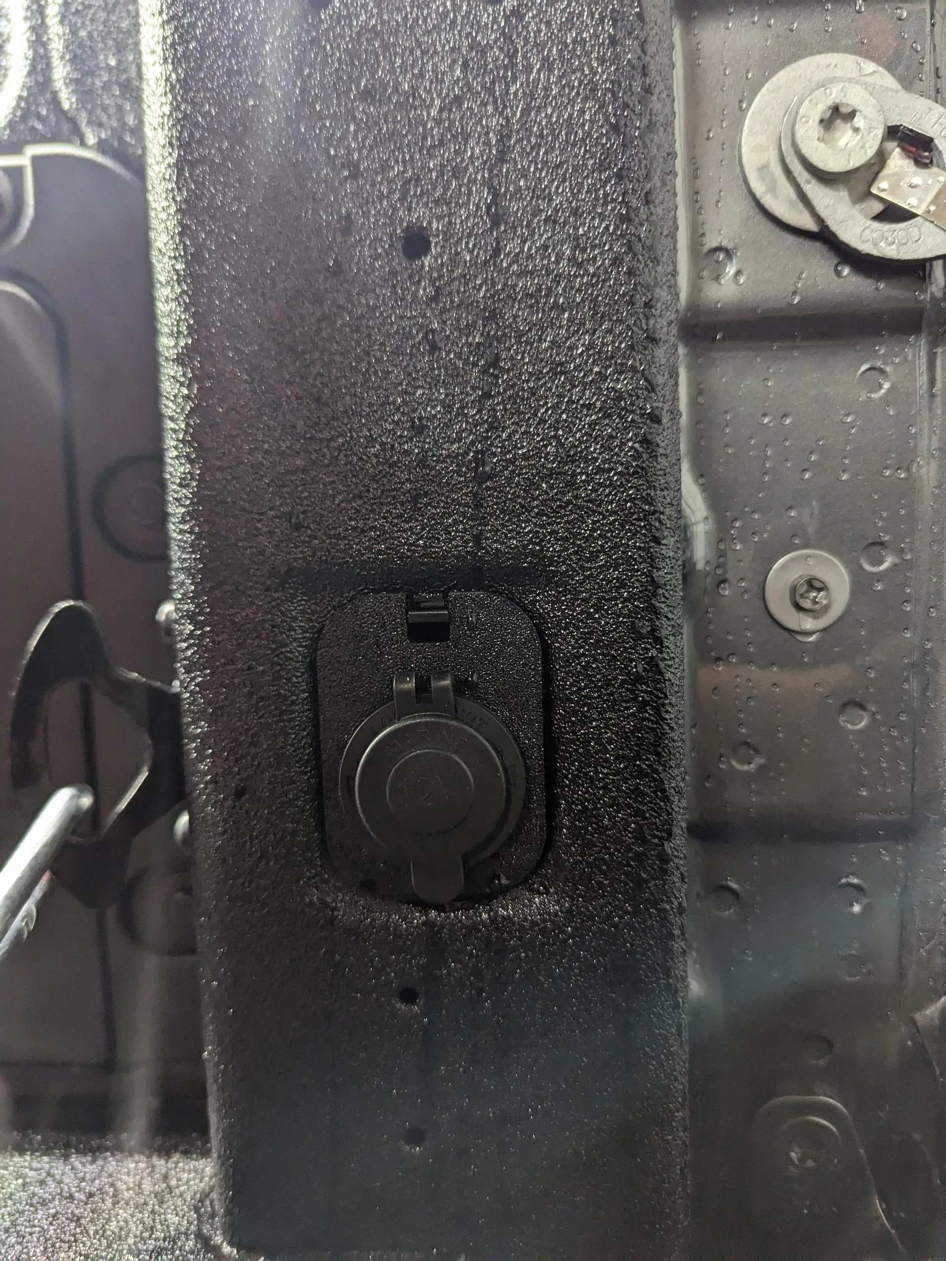

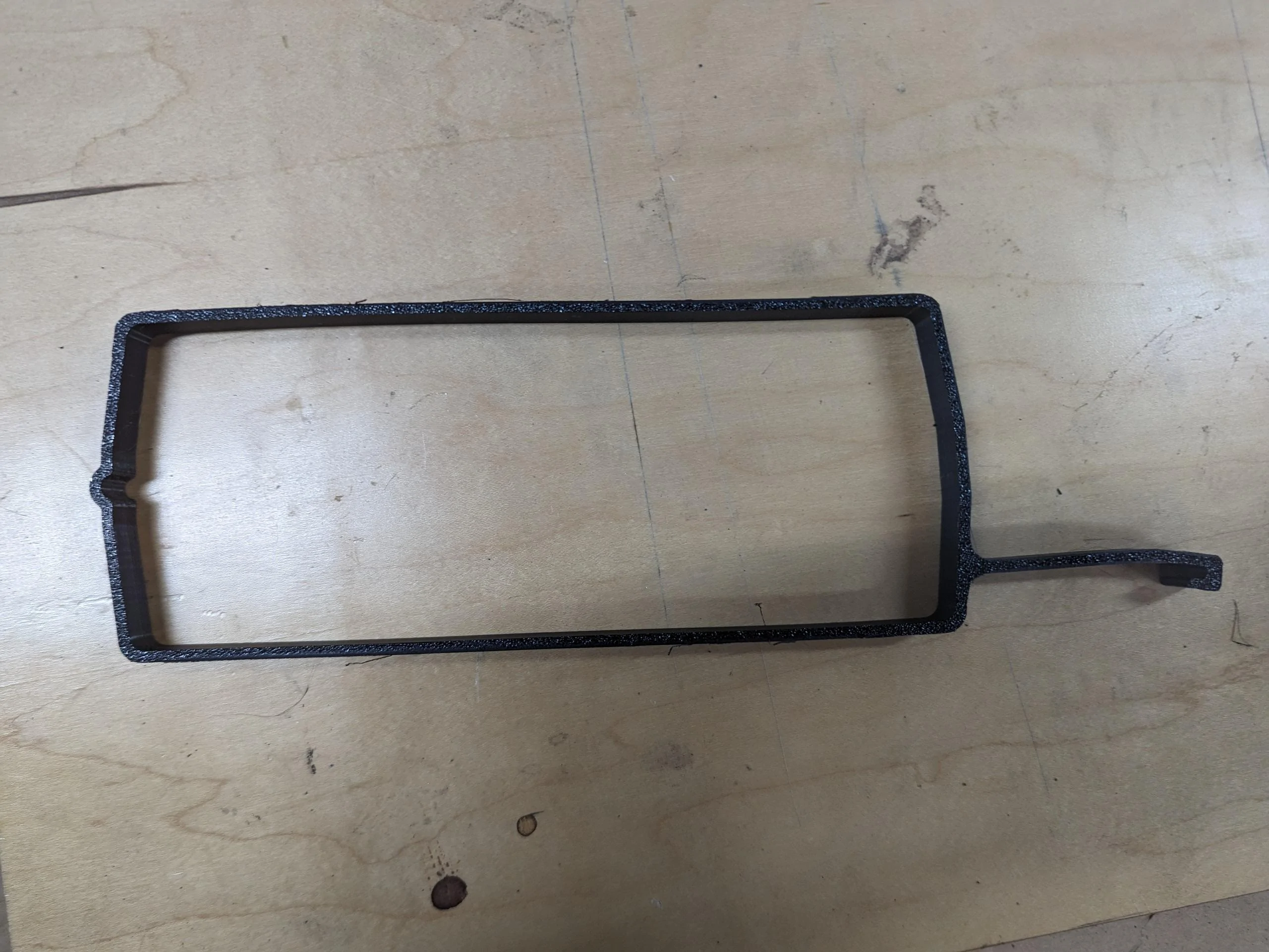

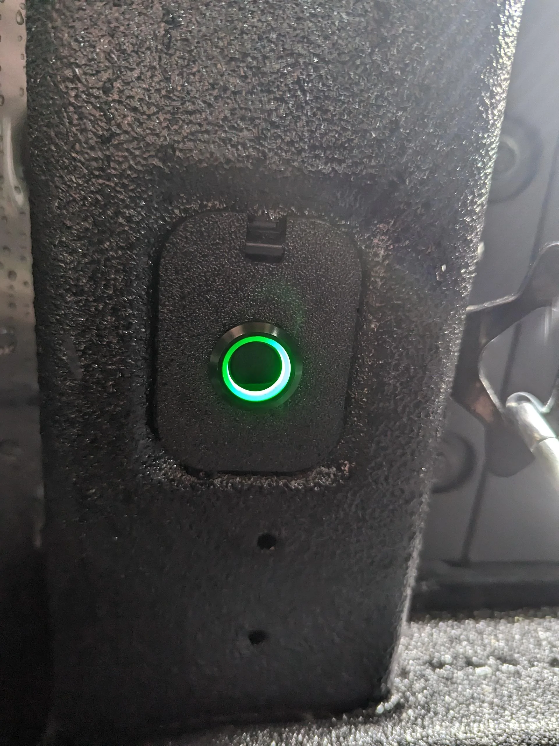

I also printed new flexbed plates for my bedlighting switch and a 12v outlet. PETG filament printed on textured PEI matches the factory spray in liner almost perfectly. I found a file on Thingaverse but the fit was easy off and not strong enough, I did copy and modify the clip design though.
