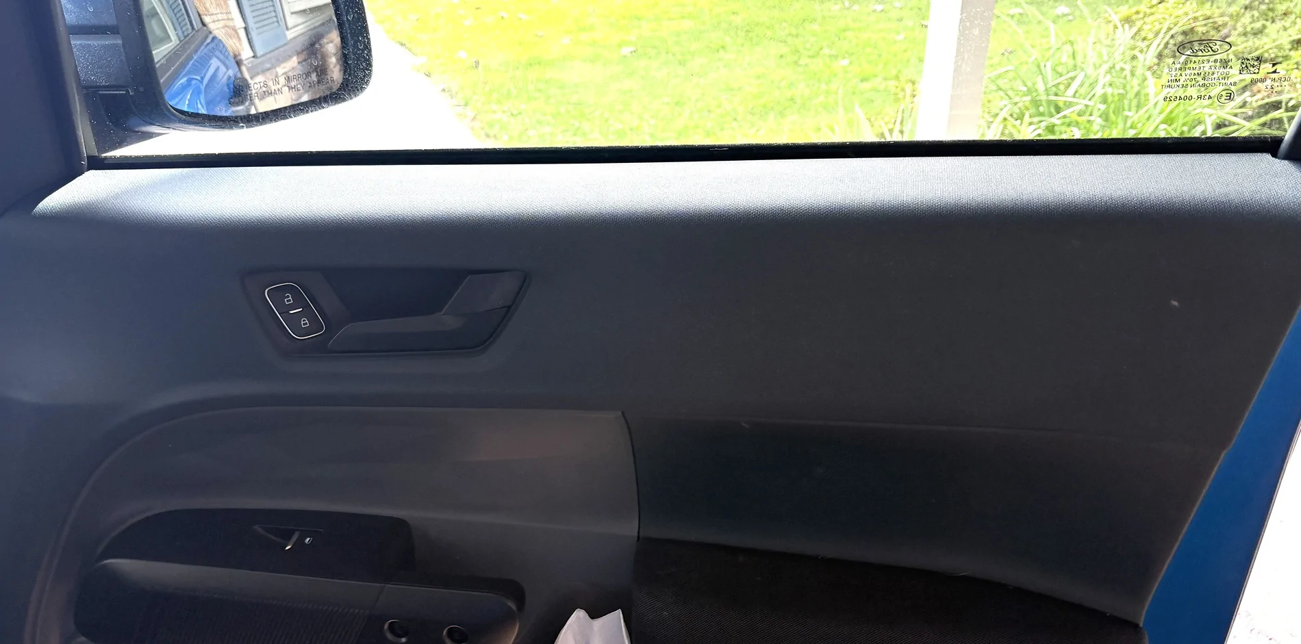

I have a Basset Hound as a co-pilot. Drooling is their nature. I'd love to see a thin cover device that slips over the interior door trim, at the windows- where he rests his chin when the window is down. Something that just covers the curve from the window glass slot down over the door handle.
