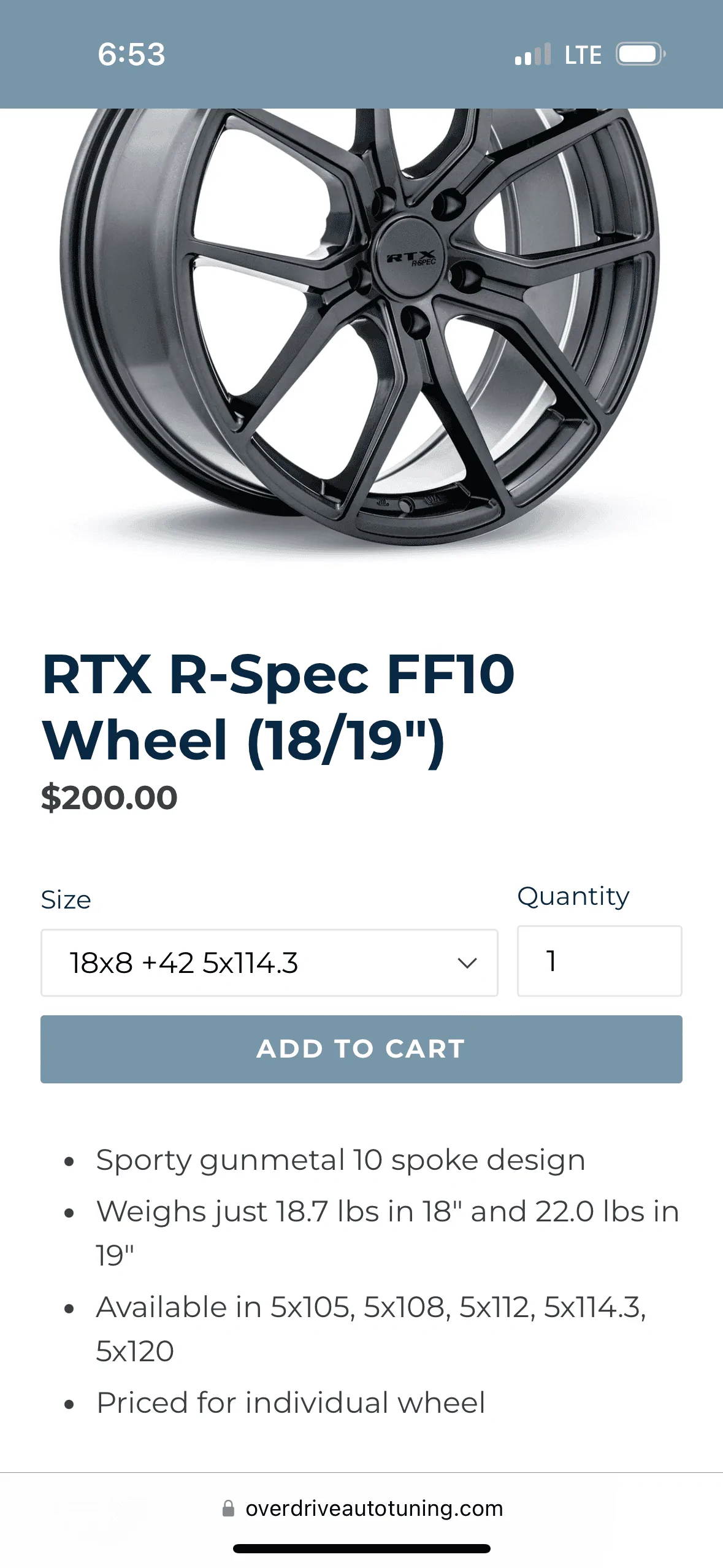

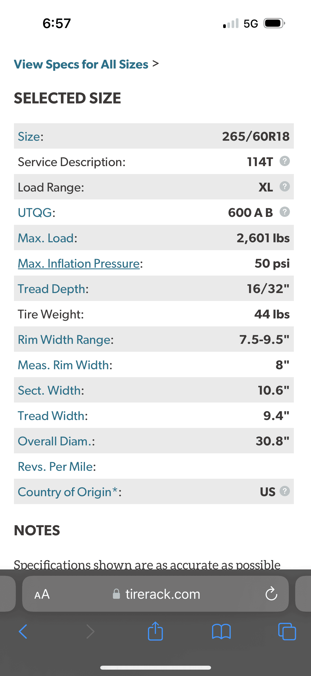

So I did some leg work for you
Your tire weight 45.2 lbs plus your rims.
28lbs. =73.2lbs
Mine
Rims 18.7lbs
Tires 44lbs tire rack 45 lbs discount tire weight.
Total 63.7lbs
Oh man someone should have let you know how much damage you are doing. To your driveline by adding those bigger tire you put on.
Attached are pictures of my weights for components. But we could also both pull one off and weight them. I’m would today if you wanted.
This isn’t to point out you are gonna have issues like you like to do to other with no real way to back it. Just simply to point out that maybe we have more instances that say it’s ok.

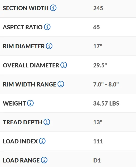

Here is what I found on yours.
WOW Never would've looked there
I was only able to find places with one in stock so I kept looking. Somehow I stumbled upon them on Amazon.
I really had a hard time finding rims I liked. If I found the ones I liked either the offset was wrong or they were very heavy. Then I found these and they worked then came finding them anywhere in stock.
I was gonna add the link to them but if I go to order it now says none in stock.

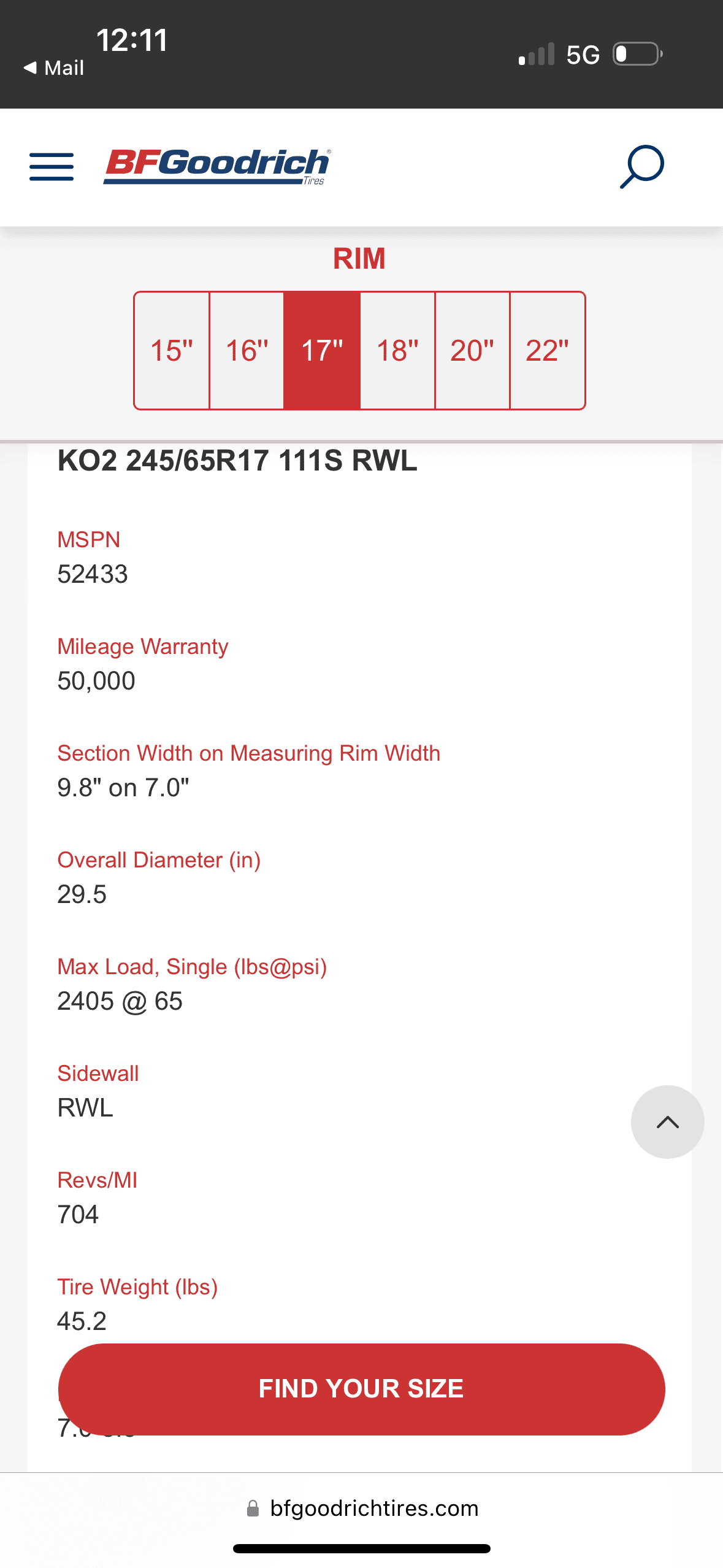

Well I did look them up. If you can find another I’m glad to see those
And if you notice that’s bf Goodrich’s site. I would assume they would be more accurate than tire rack. As the rack has been know for a while to be off.
but again don’t provide anything yourself just tell people they are wrong and go about your day.
Or you could post your own findings.
By your logic not only am I wrong, now ford has been wrong. And even now bf Goodrich is wrong.
Or what happened is you said something that is totally wrong.
When provided with data you simply ignore it or say that it’s wrong.
Maybe in all your wisdom you could give us a different tire weight. But you are gonna have to shave off a decent amount to make up the extra weight. Or come back to reality and say oh wow didn’t know your rims where that light.
Which is it? If the weight is the big issue and mine are the same weight or lighter what make yours a better setup?
Please explain in detail not just continue to tell me I’m wrong and that you knowledgeable is special.
I’d actually be more than willing to have an ah ha moment that’s how we learn.
But I’ve proviided weights of tires and rims you have not.

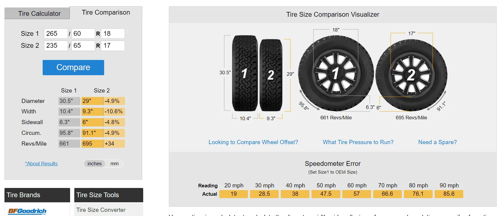

Ford Maverick 265/60-18 Cooper Rugged Trek tires installed Screenshot 2024-02-24 104716
And I've never advised anyone to get MY tires. In fact, I've done the opposite (many times) because I saw the loss and knew it was the limit. They are without a doubt the limit for tires on these trucks because of their weight and the revolutions per mile you compromise with the size. Now I'm really glad I opted for a lighter and slimmer wheel. I've always ran lighter Wildpeaks and should have on this truck. Even when asked on my own build log "do you recommend the KO2's?" I said no. The trade off isn't worth it - which is exactly what I said in my initial posting here. All you two have done is manage to turn this into an argument where you are completely ignoring the other factors.
Yes, 99% of aftermarket setups are heavier than stock. It's no secret and mine is one of them. It's the limit for the driveline. Your tire weight was NEVER the ONLY factor here. Mine isn't either. For the 100th time.
Again, weight is not everything. Revolutions per mile and tire width. How many times do I have to say that is more important than weight alone? Which is why the 21" argument fell on it's face, which is why your vendetta against 245's now falls on it's face, and literally the entire point I've been trying to make since my first post but two people now so far have tried to derail so far and fixate on ONE single aspect while ignoring the other two that make both wider and taller setups harder on drivelines. It's not a question - it's widely well known. It's physics.
https://www.transmissiondigest.com/transmissions-oversized-tires/
Hence, why gearing comes up once you go beyond certain point (my tire size and ones similar including the 265/40R21's). You can debate this all you want and I apologize if I was incorrect about my own tire weight, but the rest of literally everything I have said holds true. Are you really going to continue combatting physics? Your setup is beyond the safe limits for the drivelines gearing. Your tune does not compensate for the changes the way you think it does. That article alone is basically the written in crayon version of everything I have been trying to tell you. Ignoring me is fine - ignoring physics? Good luck.
