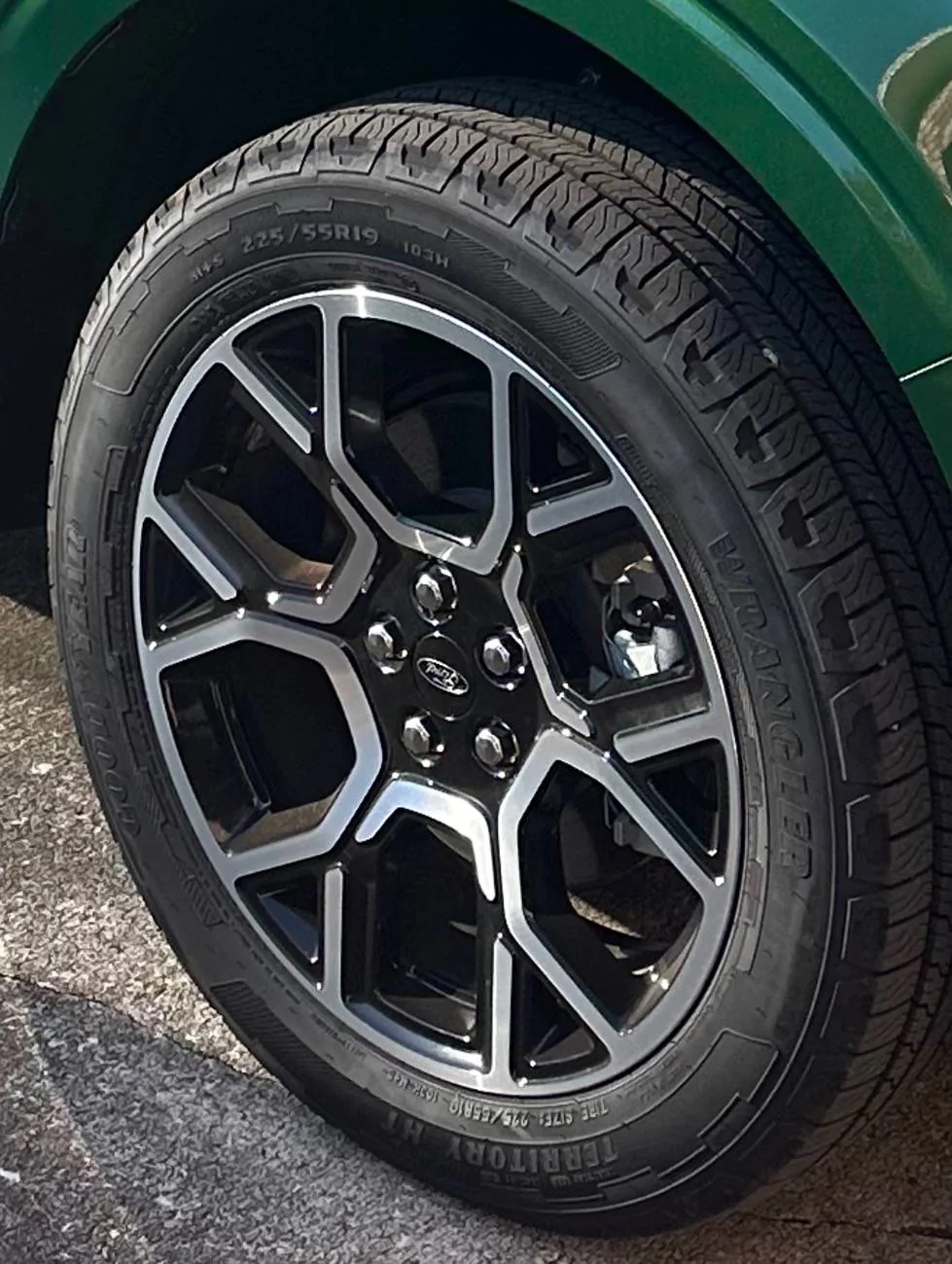

My 2025 Lariat came with Good Years (See Photo) I have less than 125 miles on them but did drive it home on the interstate about 70 miles very smooth and quite so far so good I’m happy

ā€˜25 Lariat, so same as previous post.
Road noise is fine. Didn’t hear the Michelins on my ā€˜22, don’t hear these.
Jury still out on comfort. The pressures seem a little high, which will give a rougher ride, especially being 19s. I haven’t lowered them yet. So right now, it seems slightly more bumpy/stiff than my ā€˜22. Could be the new suspension hasn’t settle just yet, I have less than 300 miles.

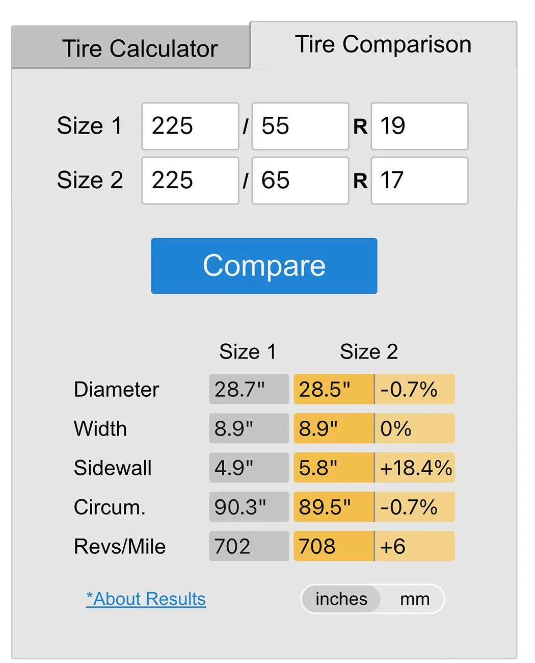

I plan on finding someone interested in swapping my 19s for 17s when my lariat comes in. I want more sidewall and I think it’s idiotic to put 19s on the truck, at least in lariat trim. Xlt has 18% more sidewall…

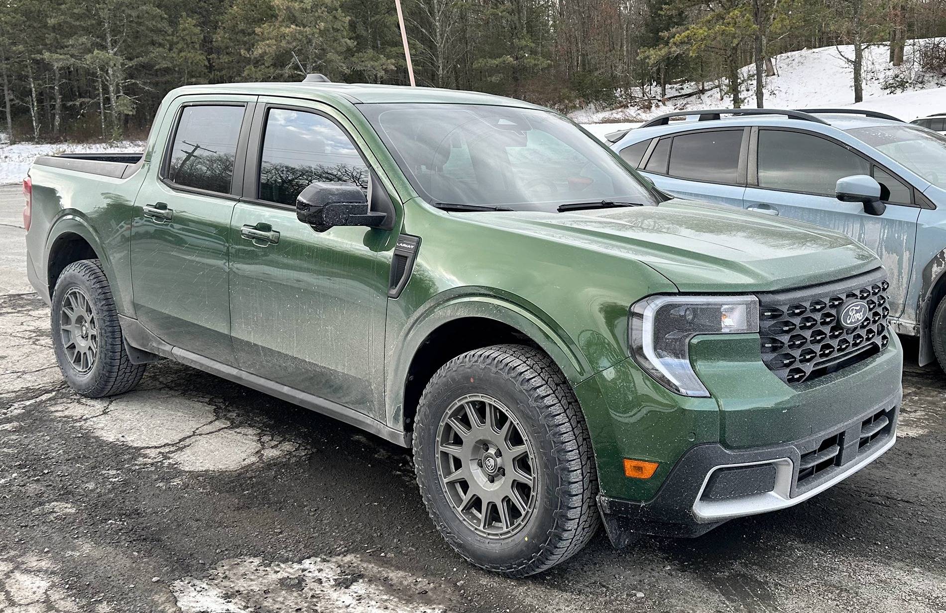

My 25 Lariat came with Goodyear tires. The ride was smooth and no road noise. I swapped them out for some 17's. I went with 245/65R17 Falken Wildpeak AT Trails and mounted them on my 17x7.5 +35 LP1 wheels. They fit perfect with no rubbing.

A little larger tire than I'd prefer but that looks damn good.

I had 235/65R17 on my 2022 Mav and they were great. The slightly larger 245's are nice. I think they fit the truck better.
