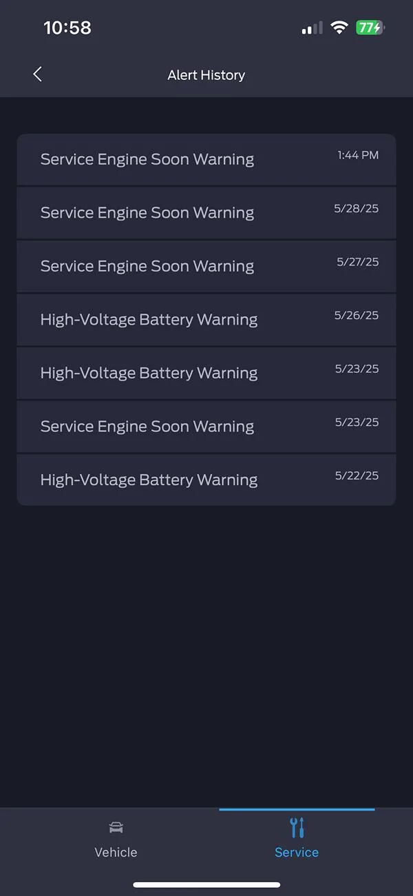

The DTCs appeared before my mods. See pic from Ford app.

Just a guess but 1 and 2 might be the issue. Not sure if you have the time before going to the dealer but if you do, try removing the splice and see if that changes anything first. If codes still show up then restore original tire size.
If not possible please let everyone here know what the dealer says and good luck.
