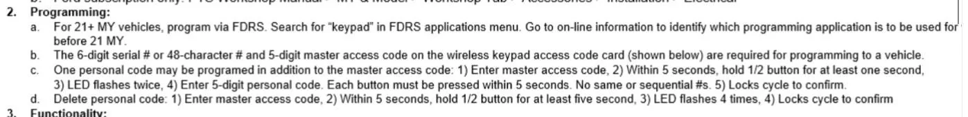

has anyone else purchased a 2025 Mavericks and have the $225 add on key pad?
the Maverick i bought yesterday has one and the master code works but direction say you can add a personalized code but the directions aren’t easy to follow and I can’t set mine personalized code.
any help?
Ford Guy doesn’t know and i can’t find a video that’s any help.

5 seconds to enter a personal code and activate seems rather ridiculous - what’s the rush?

Type in master code. Hold the 1/2 button until led flashes. Type in new code. It was easy. Also after I bought my keypad dealer charged me $30 to program it to my truck.

The dealer price for programing it initially is $56 these days. And you can't do it yourself. There are greater injustices in the world, but it's still a little irritating that you can't just program the initial paring to the truck yourself.
