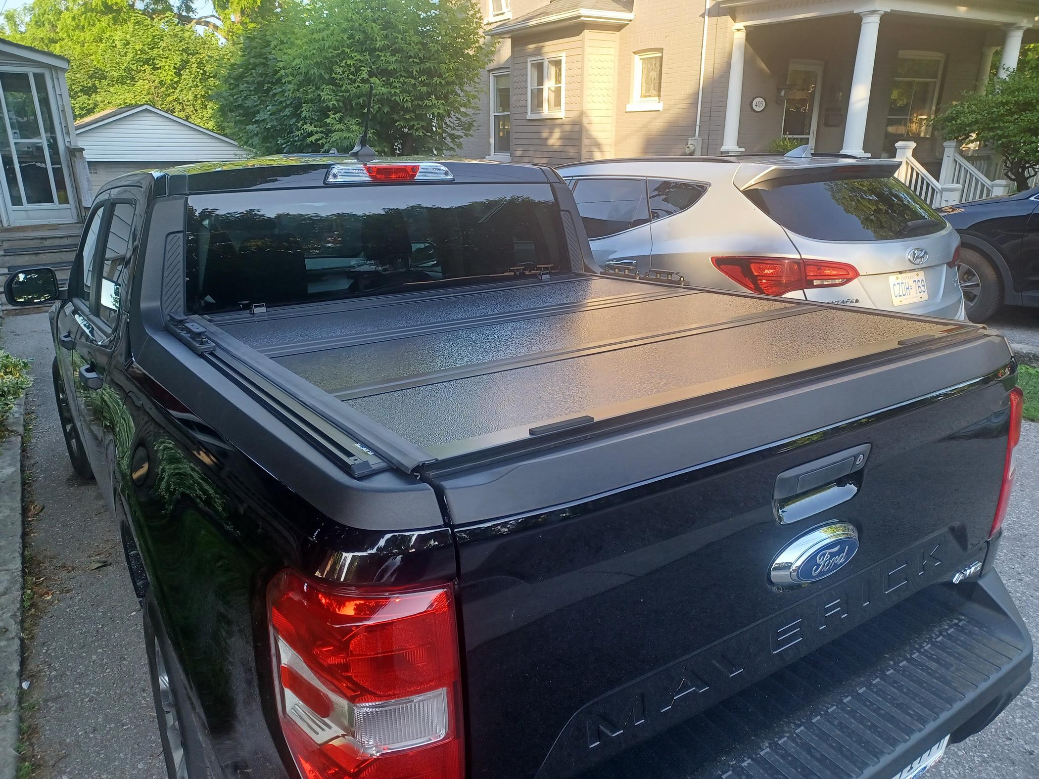

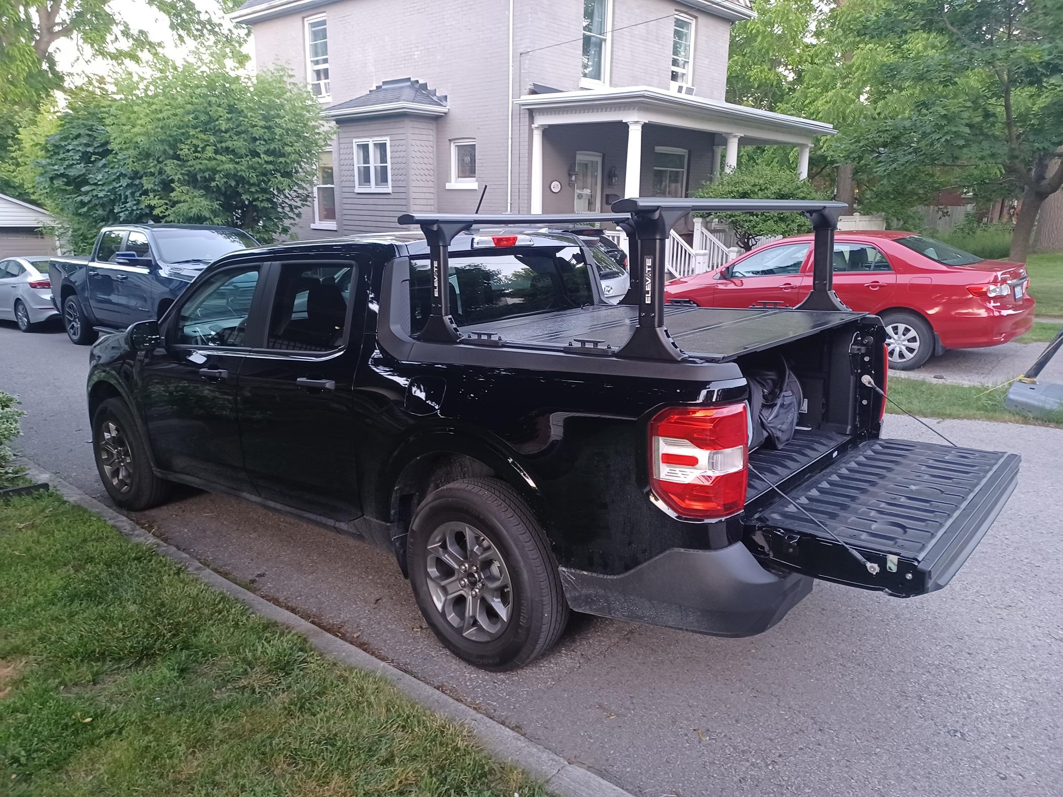

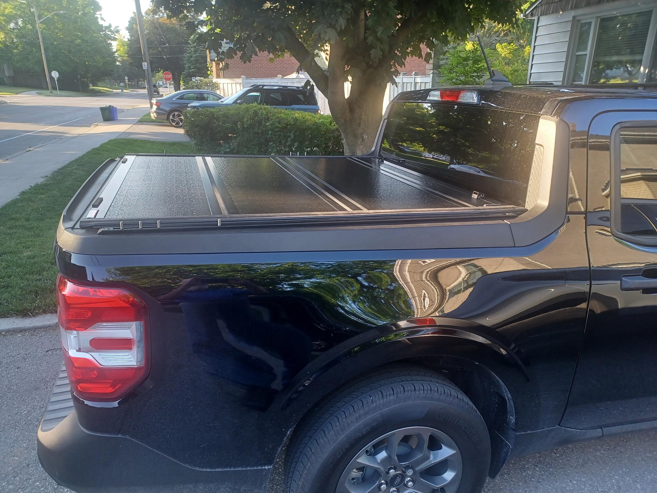

I've had my Maverick for about a month now and am thoroughly enjoying it so far. I've only done a few things to customize it so far and here are my results.
I've seen a few threads on here about tonneau covers and racks being installed together, so thought I would share my build.
1) The rack is the Elevate system from Truxedo.
2) The tonneau cover is from Bison (a Canadian company).

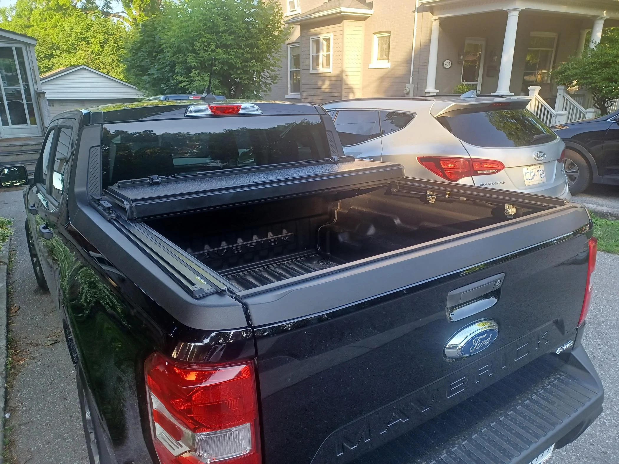

There was a minor hiccup with the installation of the tonneau cover, as the loss of width due to the t-rails caused some interference between one of the cover latches and the prop rod mounting hinge. The installer at Bison was great with helping me make it work together. All we had to do was move the prop rod mounts back a little bit and everything fits great. Tbh, I probably should have just removed the prop rods completely, as I have no intention of ever driving with the cover fully opened, but figured they might come in handy if I ever need to prop it open while loading/unloading the bed.
