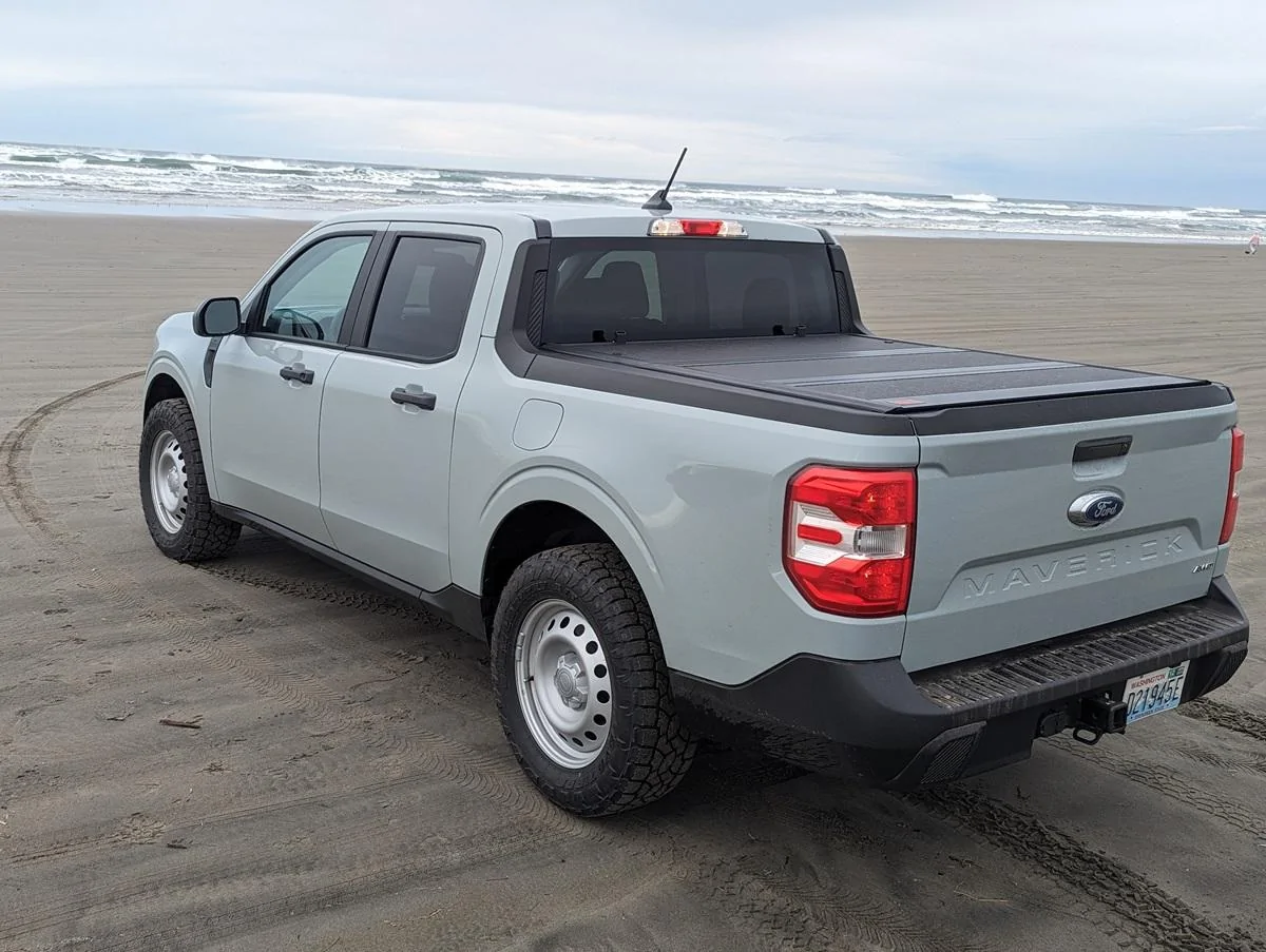

Added 245/65/17 Toyo tires and a Rough Country tri-fold tonneau cover.

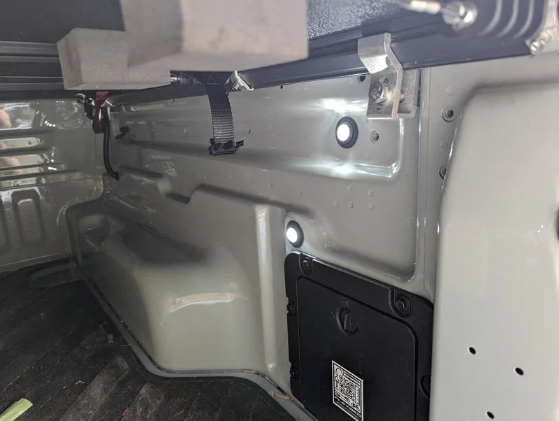

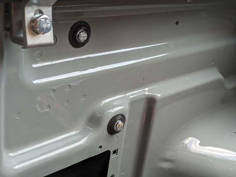

After installing the tonneau cover, I realized that i definitely needed some lights back there. I ended up buying some small LED lights from Bezos land and installed them in the factory rubber plugs in the bed for an OEM look. All I did was snip a hole in the center of the plugs and insert the lights. I did this on both sides for a total of four lights.
Ford Maverick 2024 AWD XL : Blank Slate PXL_20240205_004828425
I hemmed and hawed for awhile on how to wire this as the factory bed accessory wiring stays on for ~90+ minutes after turning the key to ACC. Since going inside the cab to turn the key just for bed lights seemed rather inconvenient, I wanted to wire this into the bed cargo light. The cargo light turns on/off with the key fob and by pressing the cargo button in the cab. I almost always have my keys with me, so it makes the most sense to wire the lights in that manner.
To wire this, I followed the guidance in this thread:
https://www.mavericktruckclub.com/f...ower-aftermarket-under-rail-leds.7570/page-12
I have a 2024 so wiring this was harder than 2022-2023 Ecoboost models. For the 2024, you have to run wiring all the way into the cab to the BCM and splice off a wire. This involved removing the fender liner and some interior trim to run the wiring.
This definitely took me longer than I'd like to admit, but mostly this was due to hiccups with the wiring and a lot of trial and error. If I had to do it again, it would probably only take 1-2 hours.
The lights are plenty bright in the dark, so this will do for now.

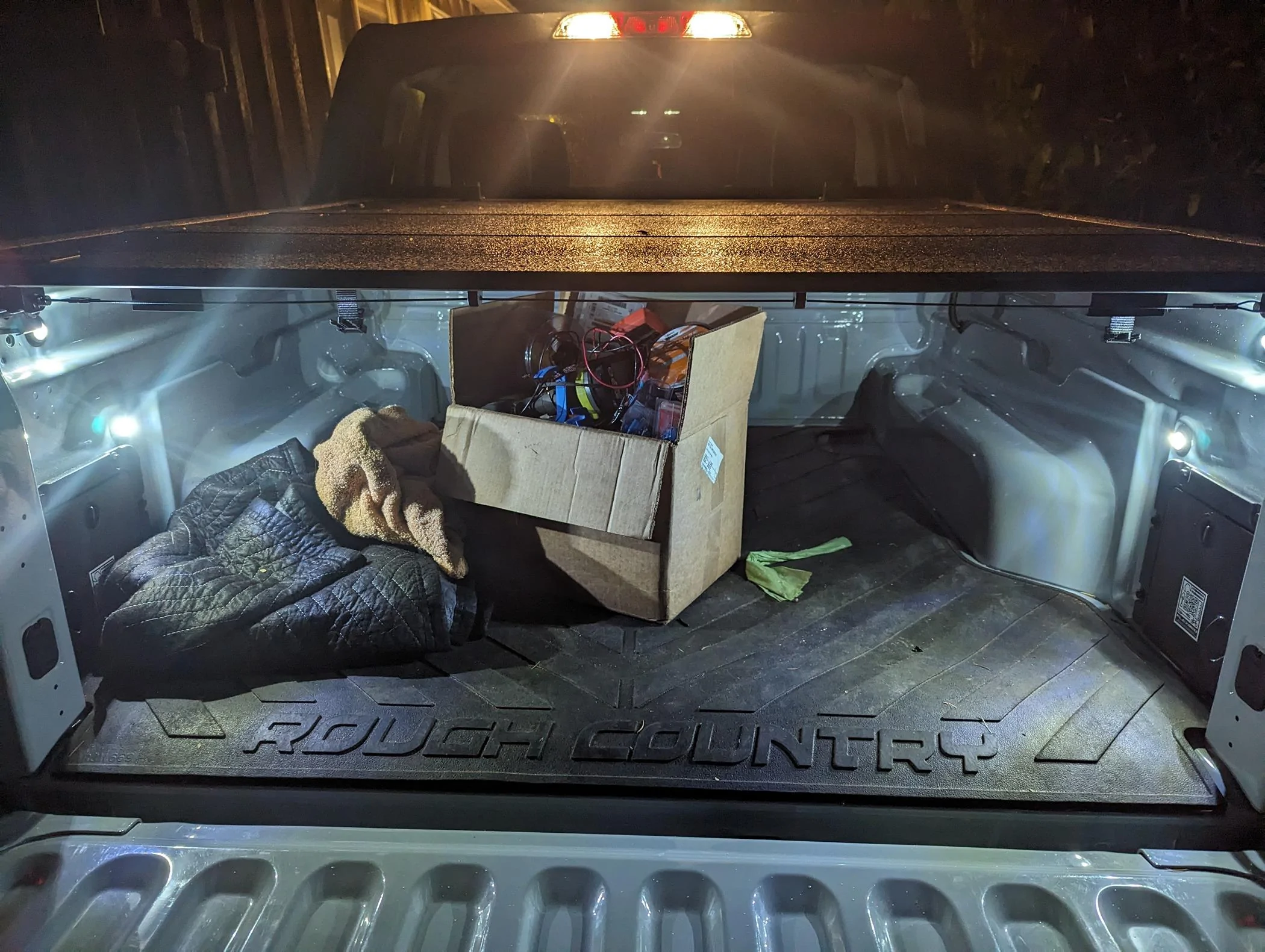

Ford Maverick 2024 AWD XL : Blank Slate PXL_20240411_204932453

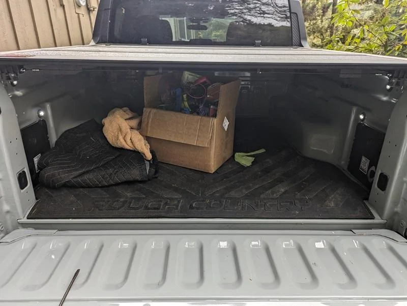

Lights aren't very bright during the day, but they're much better at night.
