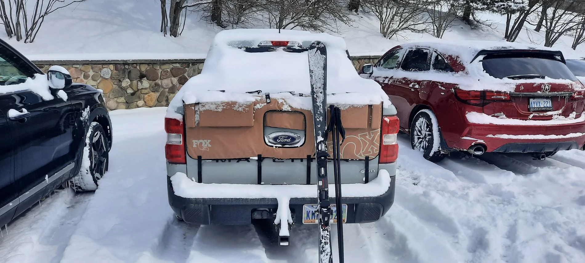

Bikes don't ever touch the bumper. Make sure your tailgate is clean like was stated. I wish I had a picture with bikes over it. But here's my pad in place. It has a removable velcro rear camera portal. In theory it can carry 5 bikes. I say 3. When carrying 2 bikes I put them on the sides to not block the camera.

I can tell you got a bed cover?

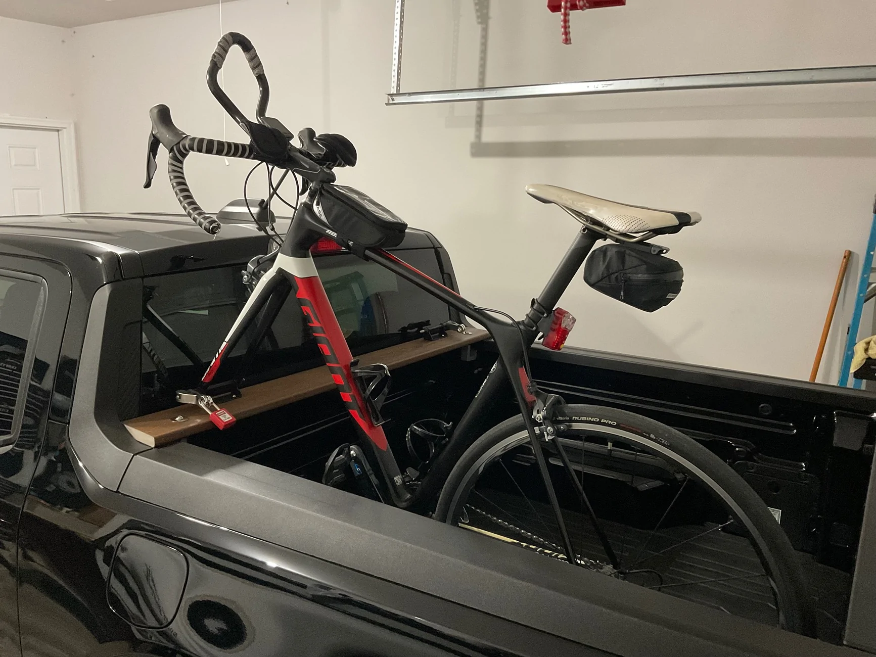

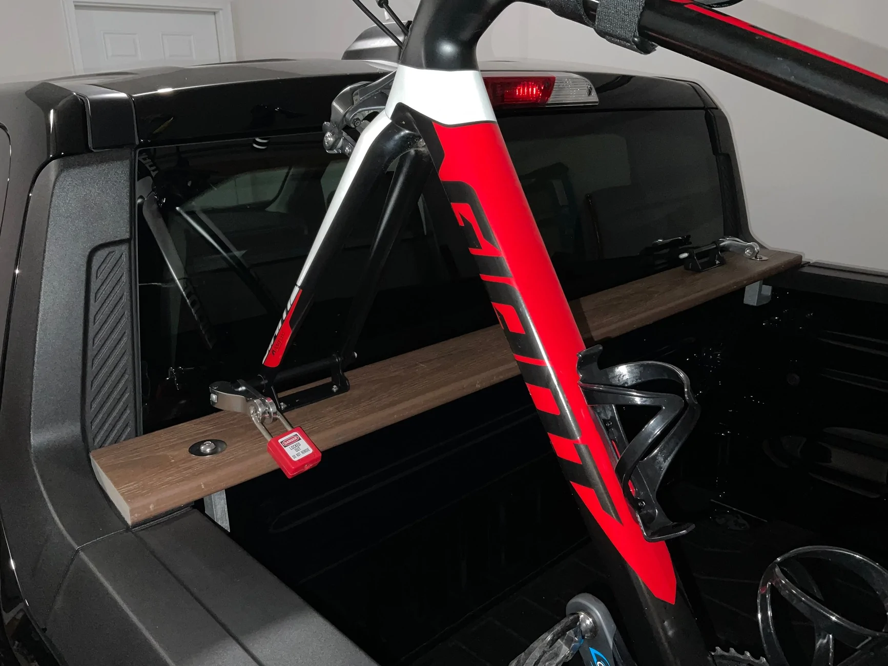

Here is my partially completed mount for anchoring 2 Delta fork mounts. It will be clamped down with a single 3/8” bolt thru the board w/clamp under bed rail. It should allow me to carry my road bikes without leaving tailgate down.

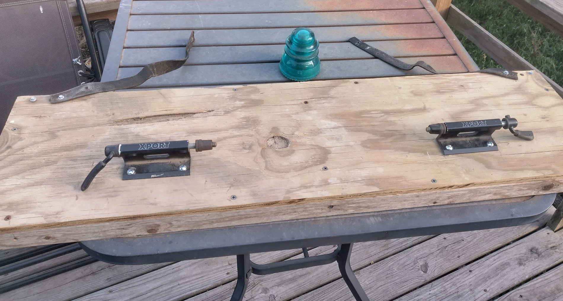

I put this in the front of the bed of my Maverick. I oop the straps through the front tie downs and screw them down.
