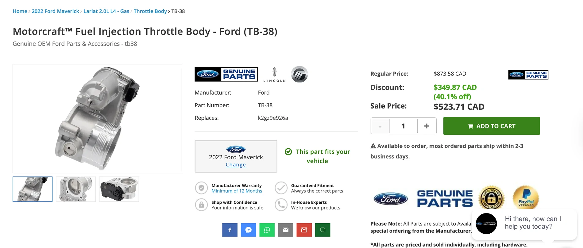

The Dealership Quote vs. My Research: The dealer says the throttlebody needs to be replaced. wants $1,100 CAD (~$800 USD) for the part alone, plus 1 hour of labor. The labor is fine, but that part price seems high to the TB.
I’ve been digging into the parts, and I found a Ford dealer listing an OEM part compatible with my truck TB-38 (see attached). Local dealer says I need “K2GZ-9E926-A.”
Ford Maverick 2.0L EcoBoost Throttle Body Failure? Screenshot 2026-02-20 at 5.25.04 PM

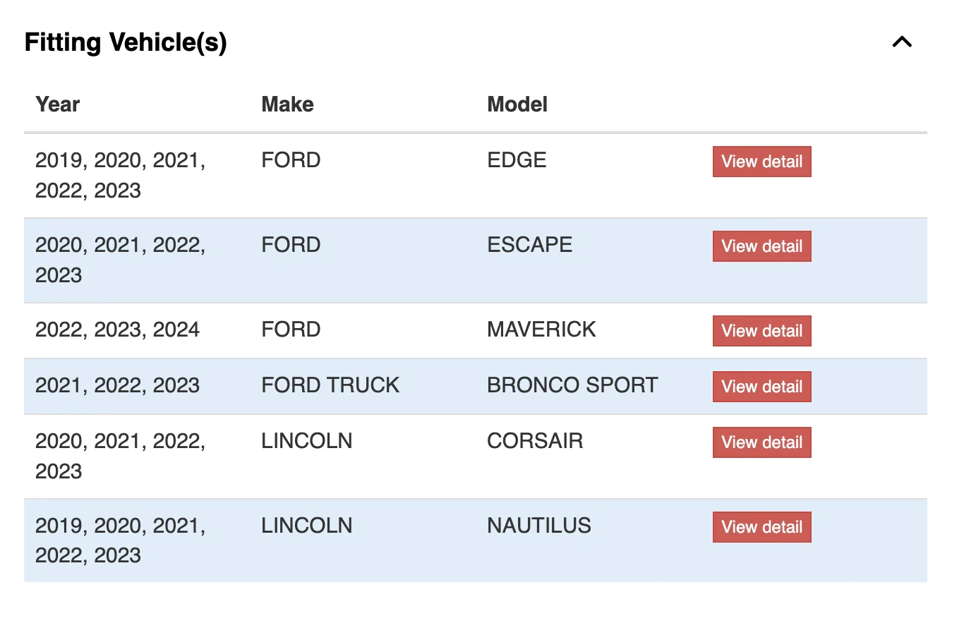

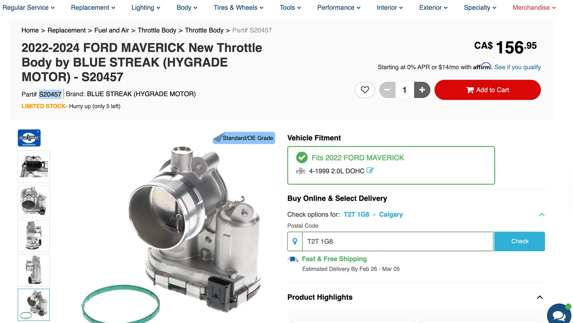

Aftermarket: I found a Blue Streak (S20457) for $156.95 CAD (~$115 USD). It lists the Maverick as compatible, but other sites only show TB’s for the Edge/Escape/Bronco Sport and don’t list the Mav as compatible, so I’m leery.
Ford Maverick 2.0L EcoBoost Throttle Body Failure? Screenshot 2026-02-20 at 5.40.47 PM
Ford Maverick 2.0L EcoBoost Throttle Body Failure? Screenshot 2026-02-20 at 5.42.57 PM

  • Has K2GZ-9E926-A been officially superseded by TB-38? If so, does anyone know if TB-38 is a revised design?

  • Aftermarket Fitment: Has anyone successfully run the Blue Streak or other non-OEM units on a Maverick?

The Part Number Breakdown
  • K2GZ-9E926-A: This is the Engineering/Production part number. It’s what was likely stamped on the part at the factory when your Maverick was built.
  • TB-38: This is the Motorcraft Service part number. It is the official "boxed" replacement part sold at the dealership parts counter.
Research Verdict: These are the same physical unit, but TB-38 is the "Service Replacement" designation. When you see a site say "TB-38 replaces K2GZ-9E926-A," it usually means you are moving from the factory-line version to the updated service-stock version.
