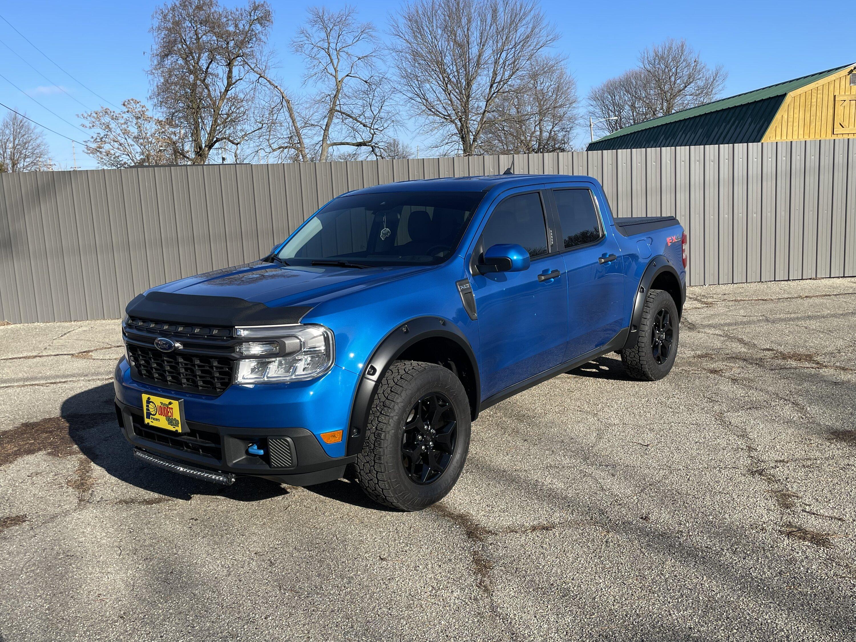

No issues with my 2” FordRangerlift. Took about 5 to 6 hours for installation by me in driveway. Make sure on all lifts the strut is ground back to clear the cv boots in the front.
That is a "Sharp Dressed Man" right there!
How big are those tires? and How did it effect the mileage? Do you feel much power loss going with the larger tires? Thank You
Deleted member 12286
Guest
They are 245/65/17 Toyo Open country. I have lost some gas mileage but I mainly drive in town. Get about 22 in town.
There is no power loss at all.

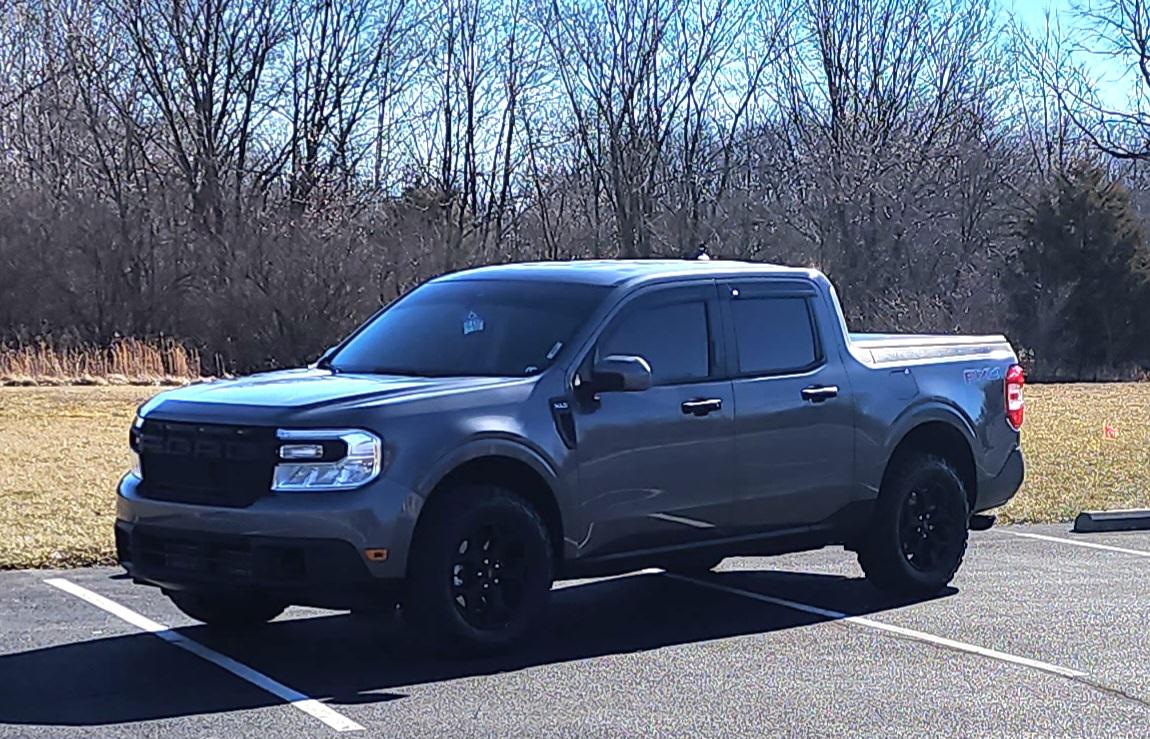

My RTR liftbdid require any grinding or modifying pinch welds.

I didn’t have to cut the pinch welds either. I was referring to strut grinding on the inner side where it can potentially cut the cv boots.
I didn't have to do that. The RTR went right in, but then again they are an official upfitter for Ford like Rousch and Shelby.
