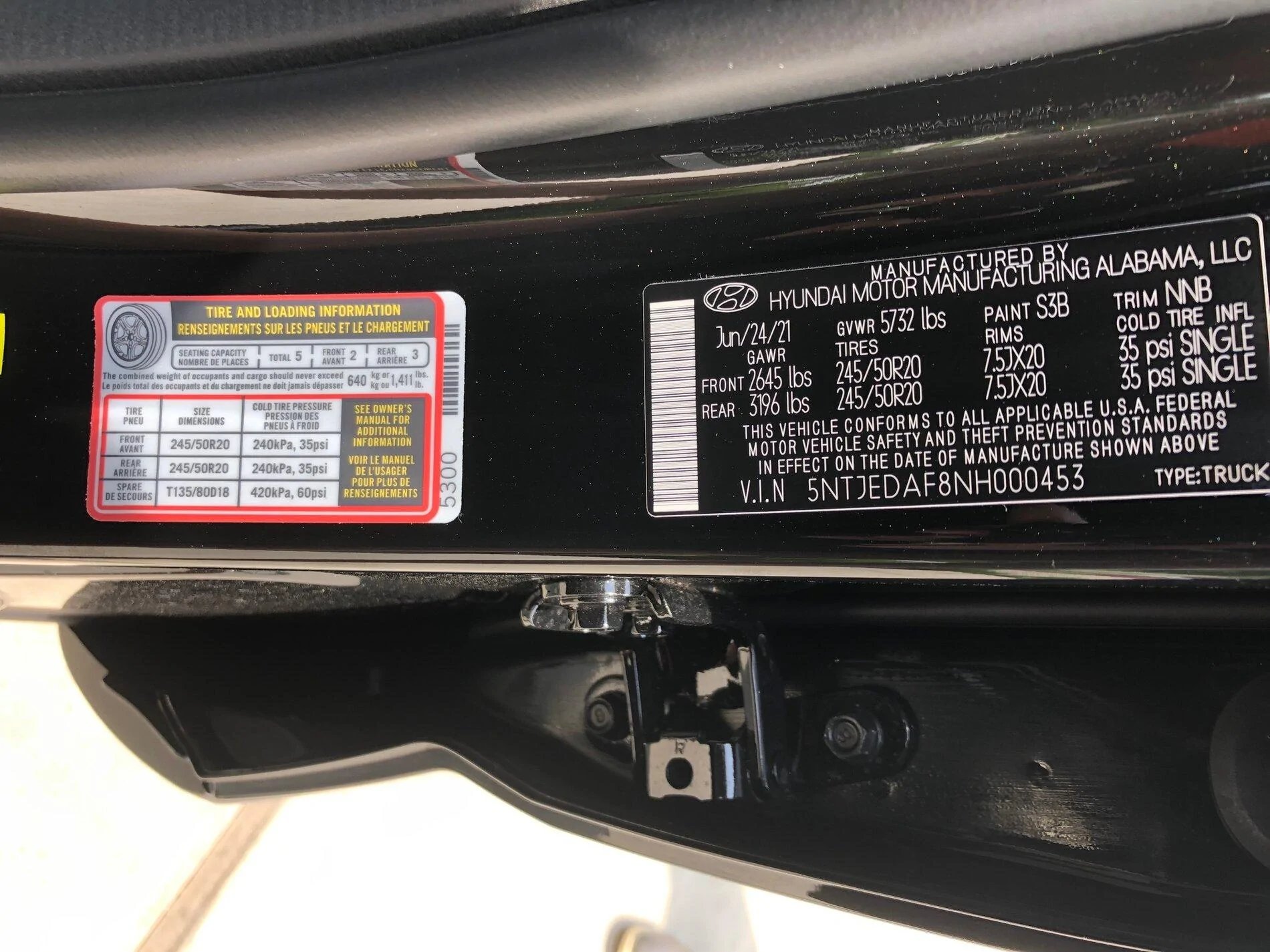

When I test-sat and did a look-see at a SC locally last week, I specifically looked at the bed area to see if it had any warning labels etc about the so-called "~660 lb. max. load capacity" for the composite bed that many sites reference. Nada.

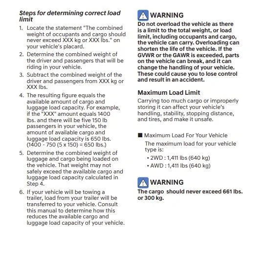

I had earlier looked at the SC online owners manual to see if specifically mentioned anything about that - you'd think that would be a pretty important limitation to flag, yes? - but again nothing - however....
1) Lots of early general info referenced the "~1700 lb+ max. possible payload" of the SC - so you'd expect the yellow door sticker to be somewhere in the 1500-1700 lb range (depending on trim level) - but the Limited SC I looked at has an actual payload capacity of only 1411 lb (less than a Maverick XLT hybrid).
2) Strangely, the SC owners manual (Vehicle Load Limit section) does mention 1411 lbs as a max. load for either 2wd or AWD. And that unusual mention of "Warning! Cargo should never exceed 661 lbs" got me wondering if maybe the composite bed does really have a low load limit due to its Ridgeline-like bed trunk.
