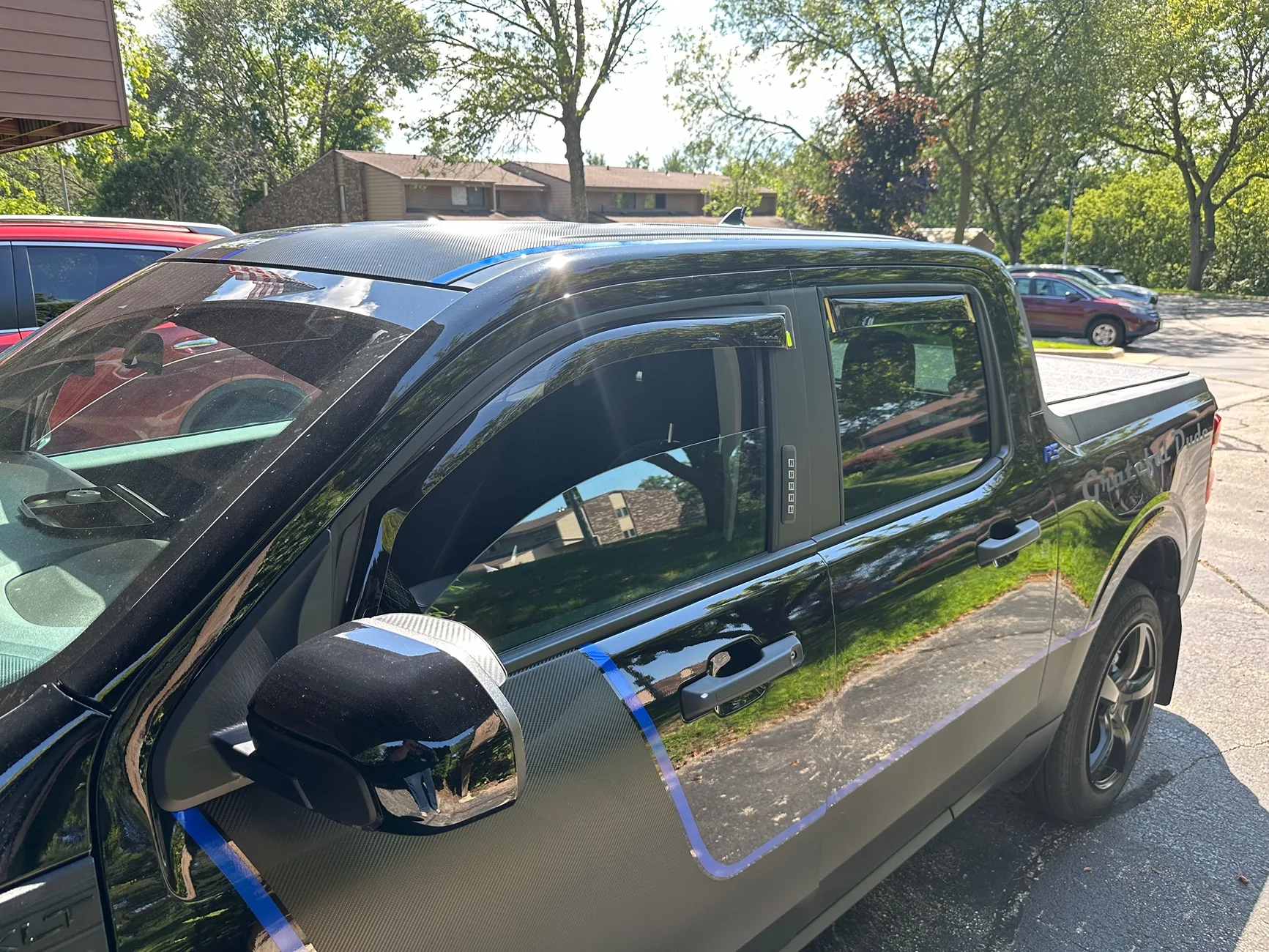

Love what you did there. When I was working on my design, it was between black n red, black n blue or black n gold... blue won out
You gotta send me the side shots. Do I see more carbon fiber accents on the side?

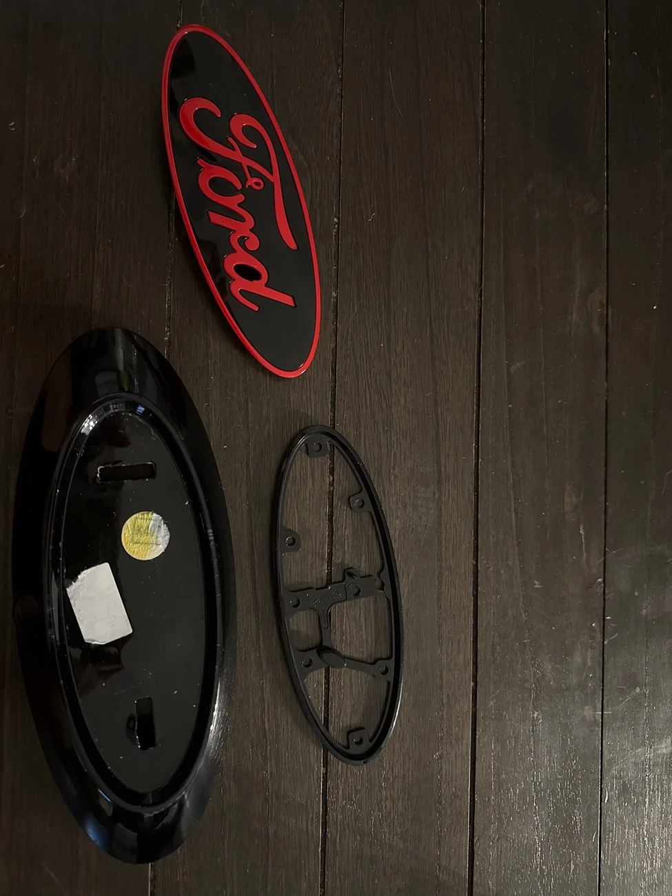

I couldn’t find any alternatives for my 2025 Lobo. That’s why I decided to disassemble them and customize them myself.

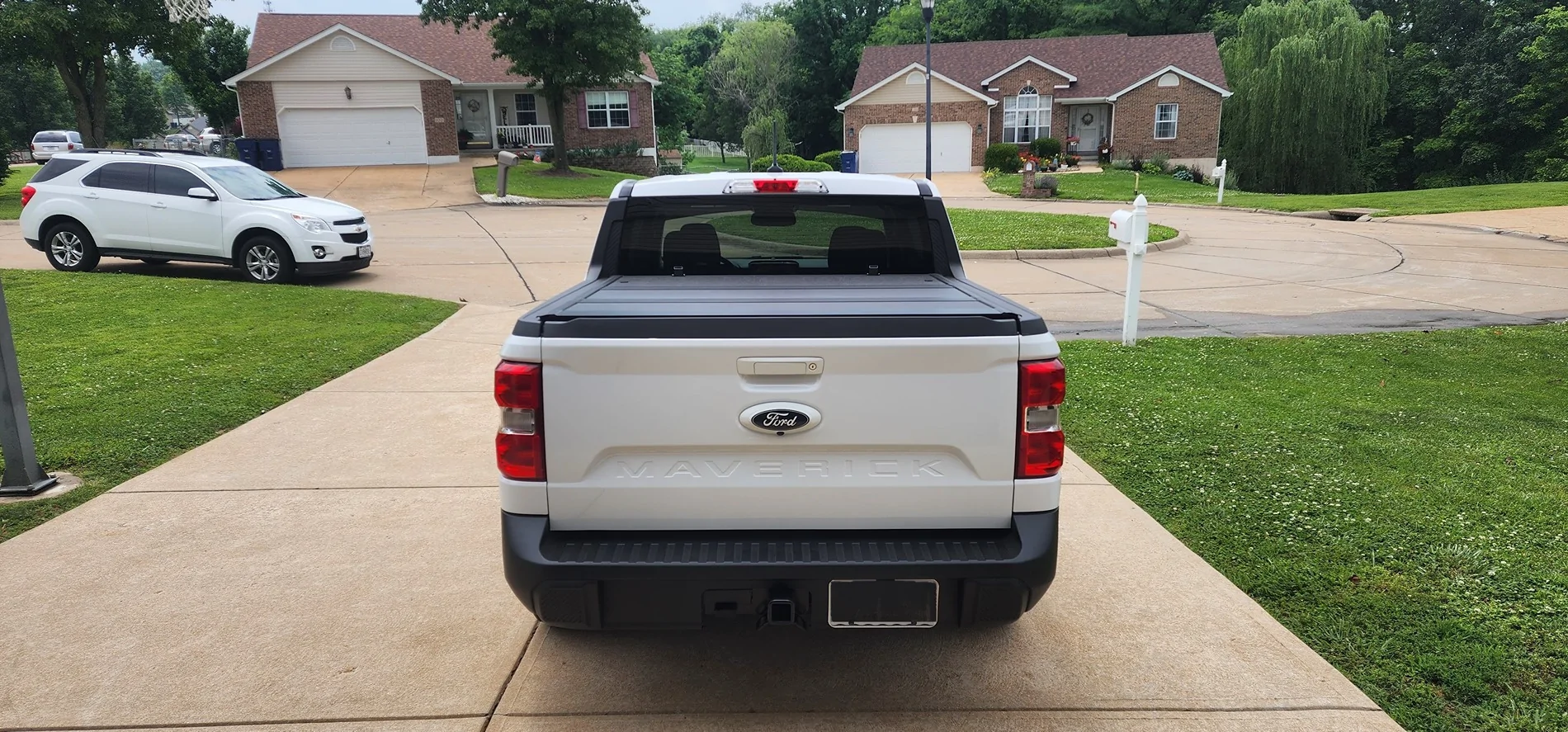

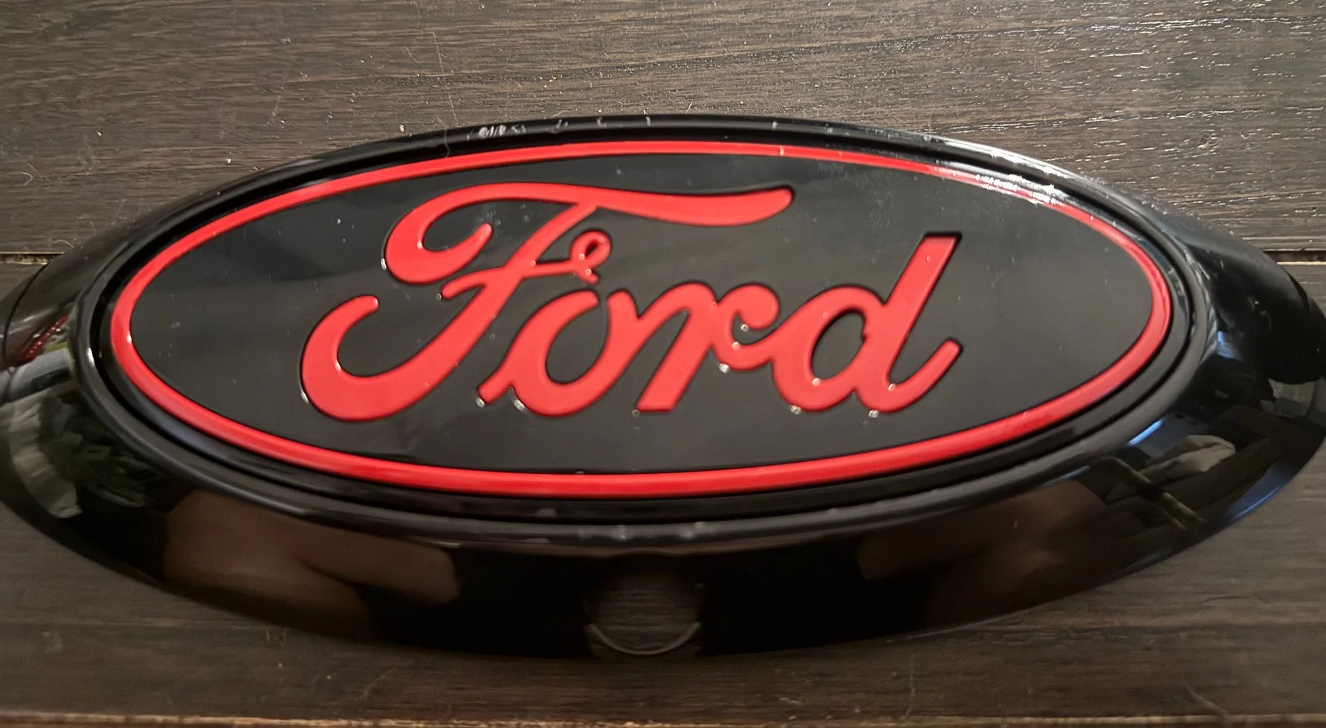

Removed the rear badge today. It is a 4 piece and fairly straight forward. The double sided tape is the toughest to deal with. When prying the oval from the large base trim piece, take your time and use a microfiber cloth with your plastic pry tools. I marred mine up a bit. The next part is the hardest! Separating the white lettering and oval (one piece) from the black piece. There are two clips that need pinched and released. Looks easy but the tape between the two pieces will make you second guess your life. I broke one of the clips. There are plastic welds on the back that need be lightly drilled. LIGHTLY!!! I broke the top of the white oval while drilling the welds. Thankfully I was able to glue it. Once all plastic welds are drilled, the two pieces will separate. Paint the parts whatever colors you like and reassemble.
I’ll post updated when reassembled.
That looks very sharp! Very nice addition!!

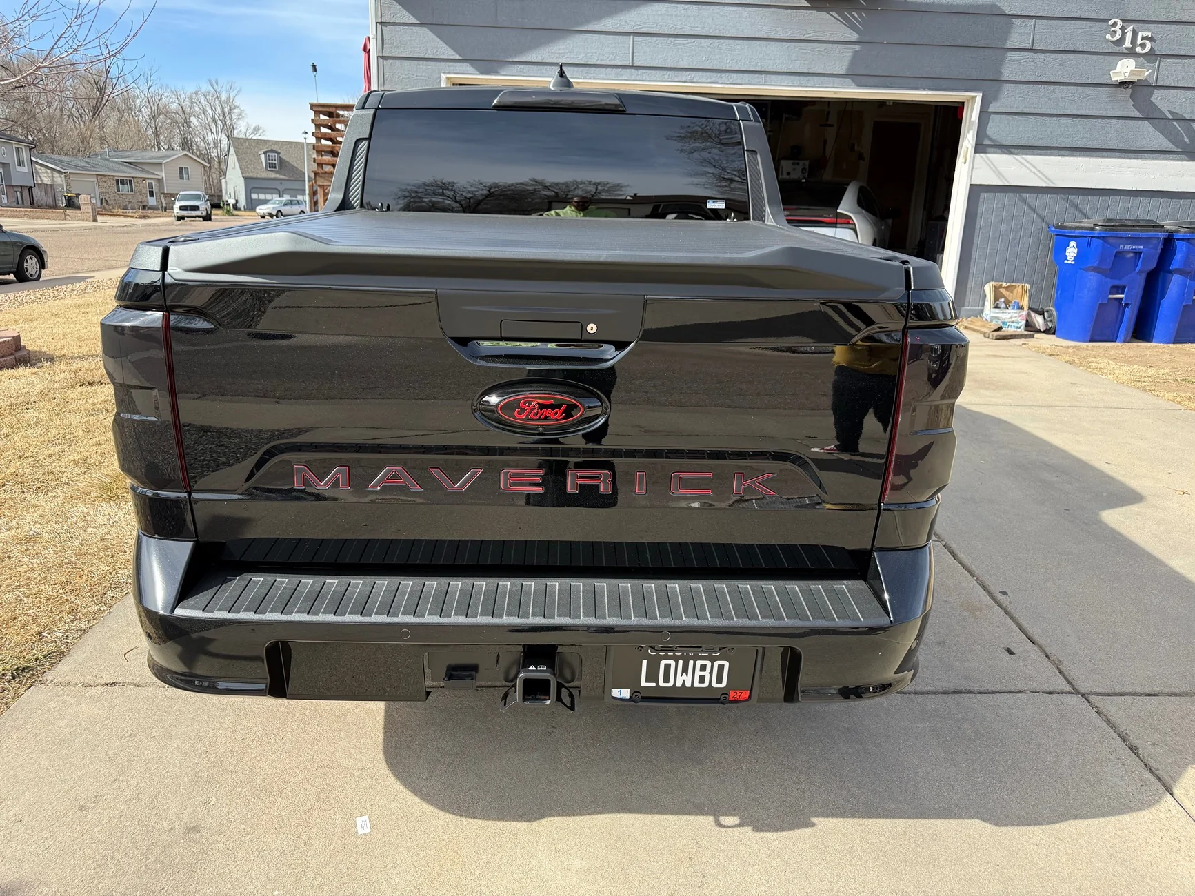

Looks great did the same to mine front and rear emblems.
