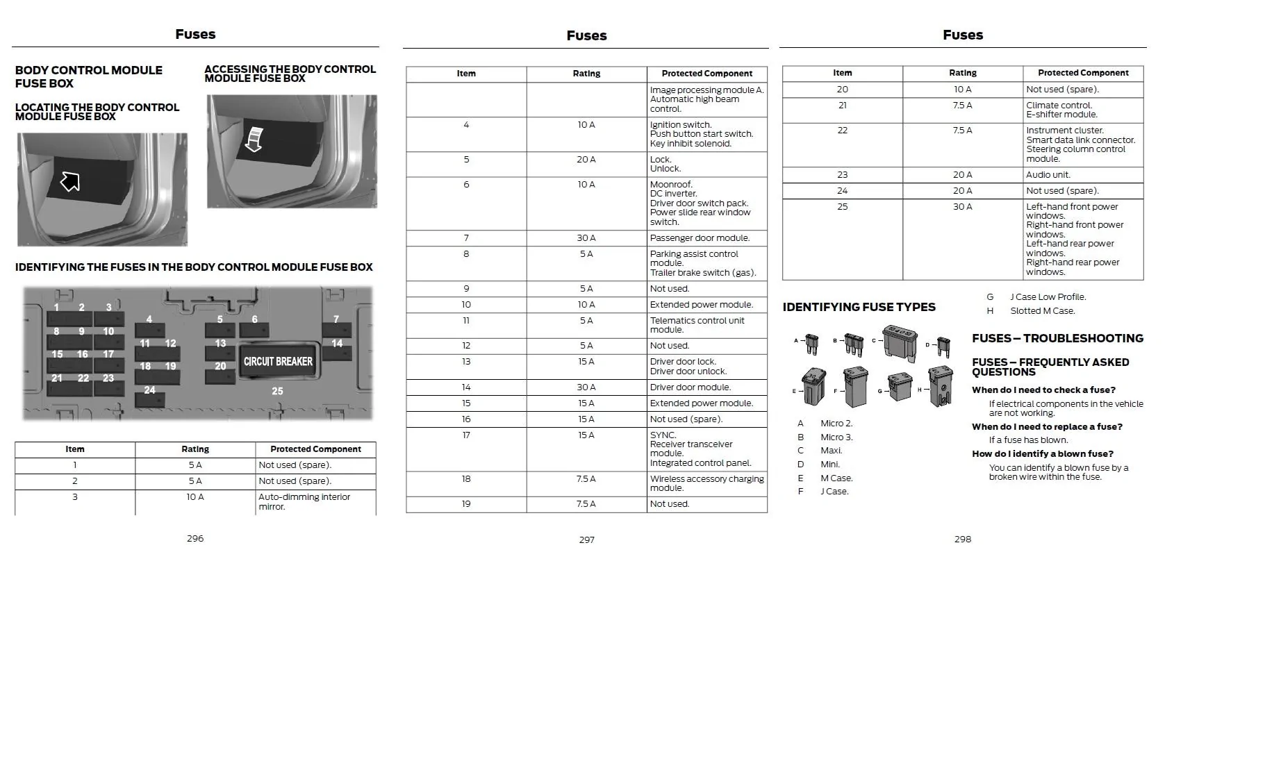

I noticed you had a sheet of paper with all the various fuses labeled on the fuse box....where did you find that? That would be very helpful.
I copied this from the Manual and put it on one page.
Thanks for the copy....
So why is fuse #3 best to use?
Thanks!
Dan
Turns on/off with the Truck ignition and it was easiest to get the adapter in, for me anyway.
