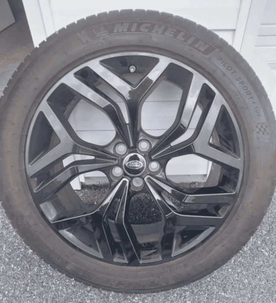

Bronco Sport take offs are rare and go for $1000+ around me when they do come up so I'm looking for alternatives. I've found a guy selling a set of 2020 Range Rover Evoque 235/50/r20. Looking on the forum I see someone saying that the Evoque 18"s fit, but I don't know how the larger wheel would impact whether or not they work for the maverick? Also seems to be a range of offsets for the 2020 Range Rover Evoque listed online so I'm not sure which these are.
Anyone "in the know" able to enlighten me?

Offset and center bore on the wheel looks like a good fitment. Tire size is a bit taller that OE sizing but should work no issues.

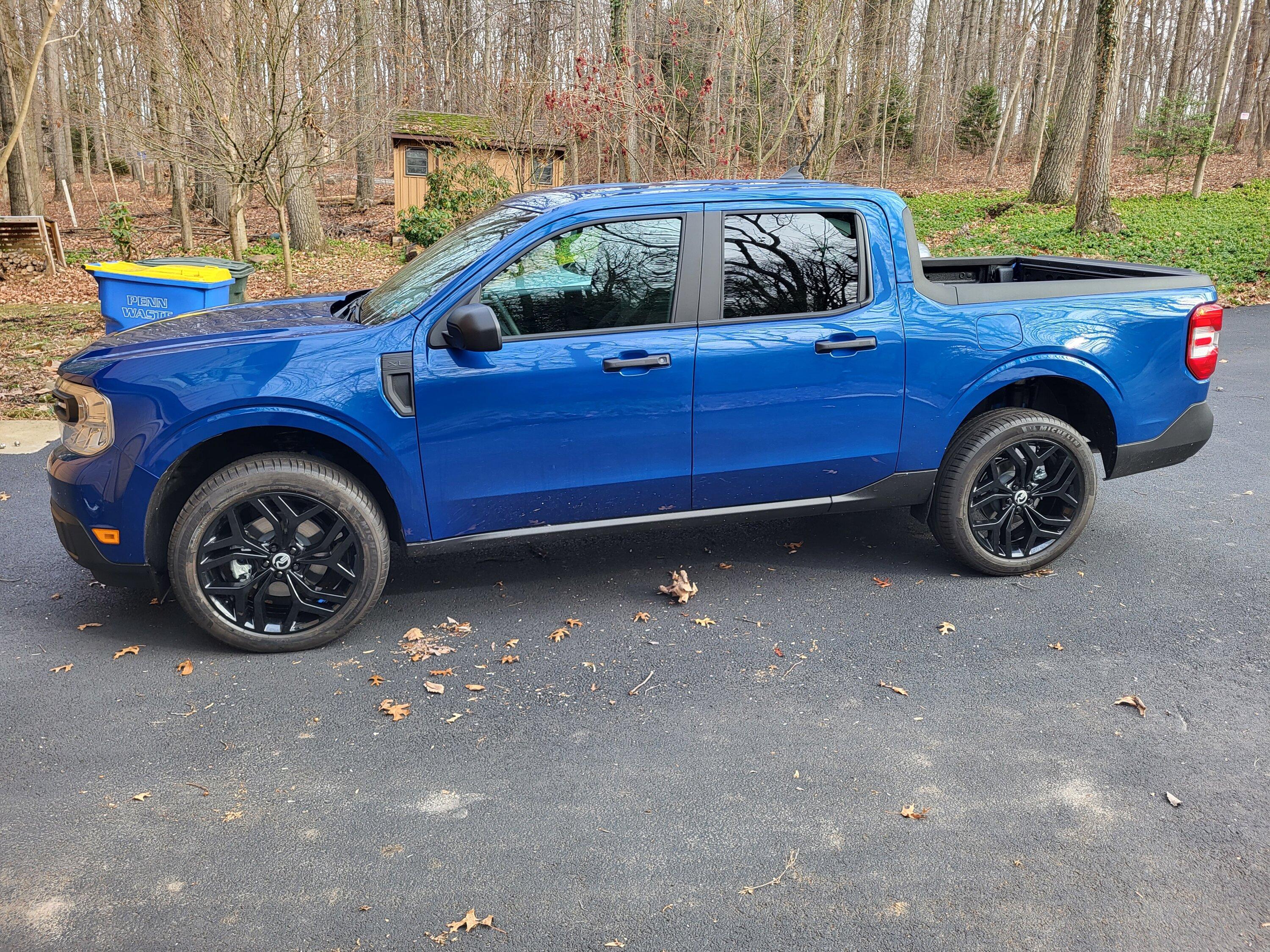

Finally got them on today. Figured I'd close the loop for anyone looking to do these wheels as well. Fit is good. No rubbing. Raises the truck by an inch. Tpms needed replaced. Harded part was finding center caps that didn't say range or land rover.

they look great, but ... you just mounted wheels with summer tires, today? the pilot sport 4 suv in your first pic is not an all-season tire.

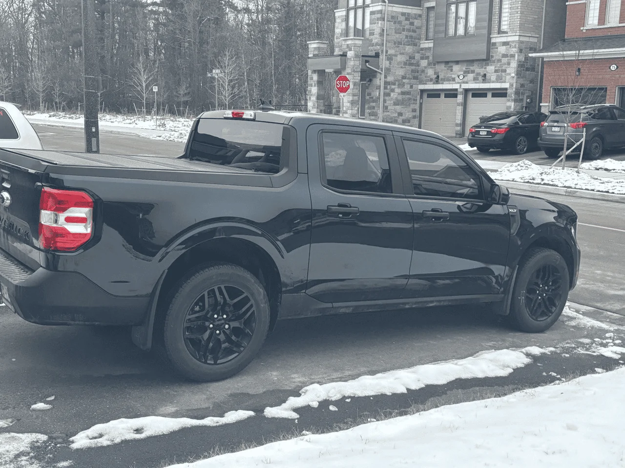

I have a similar set of aftermarket wheels with 235/60/18 for winter.
Next set of tires I'll probably do 235/65/18 to fill out the wheel well a bit more.
Might even use that size all seasons and use these for the summers, and put winters on the OEM wheels.
