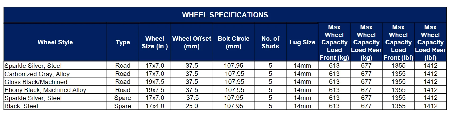

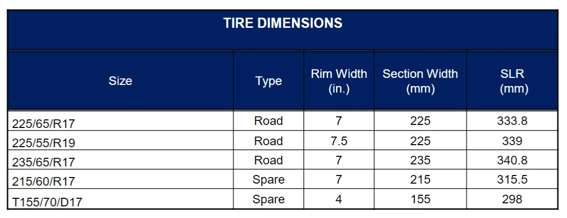

How wide is the wheel that the limiter use spare tire has? could a 225-65-17 tire be mounted on and used for spare?

Not sure if you are referencing the donut spare, or the larger one. Here are all the wheel & tire sizes .

Thanks looks like the 4 inch wide wheel would be to narrow to mount a 225-65=17 tire

That wheel is too narrow for a rear motorcycle tire, much less the stock 225 Maverick tire.
If you want a full-size spare, find a take-off steelie, or just buy a new one - when I did it Discount Tire had a steel wheel for just under $100.
