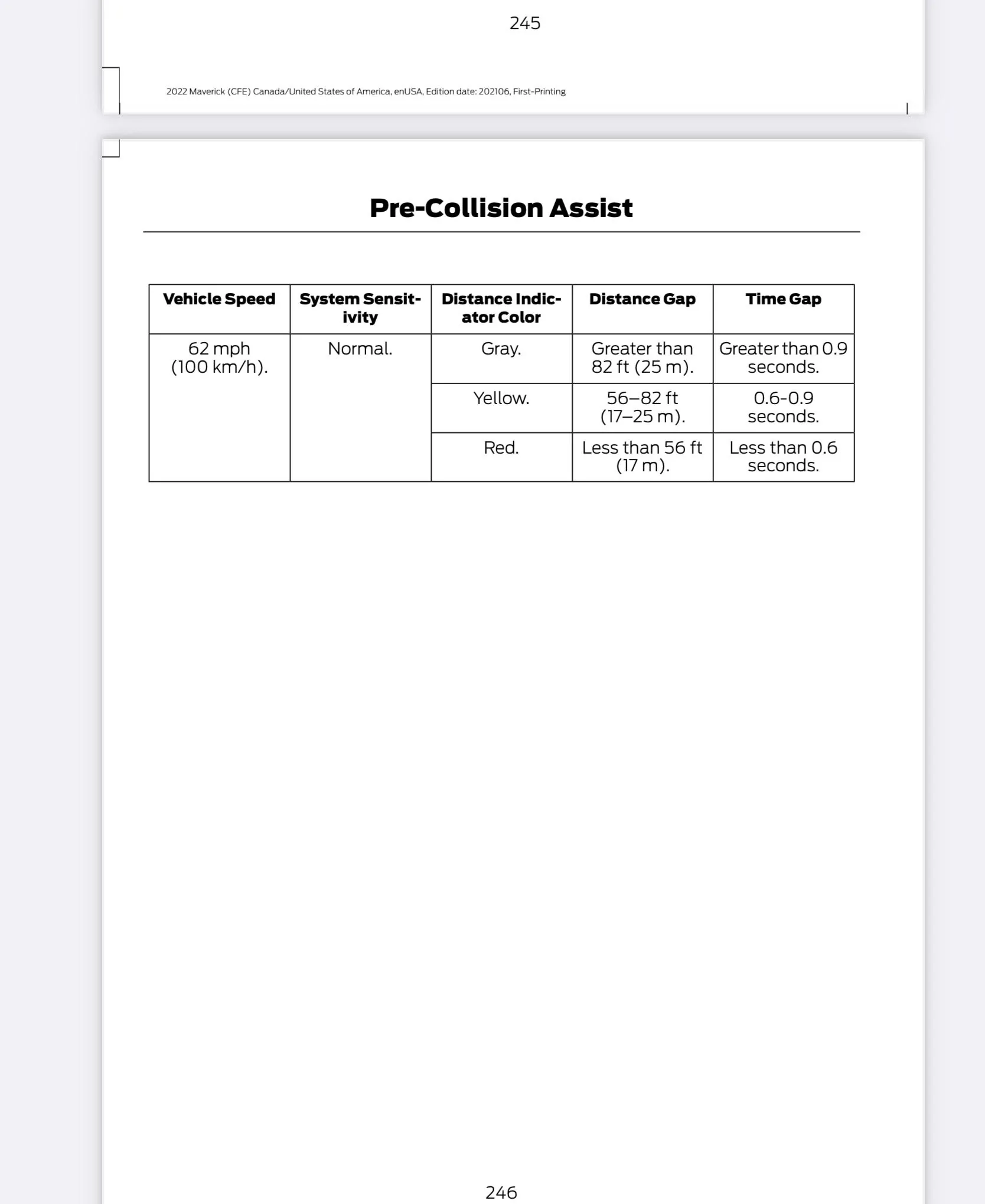

With adaptive speed control active, which can have an adjustable following distance, plus lane keep assist or lane centering (Lariat), when a car in front of you turns a corner or into a driveway, if the monitored following distance collapses too quickly, the Mav will apply the brakes to avoid what it thinks is an impending collision. This uses a radar sensor in the grille. Regular cruise control doesn’t use this radar sensor (uses front camera instead?), so may not react to an impending collision other than to warn the driver, also at an adjustable distance, but usually giving time for an inattentive driver to do something if the closing speed isn’t too great.
