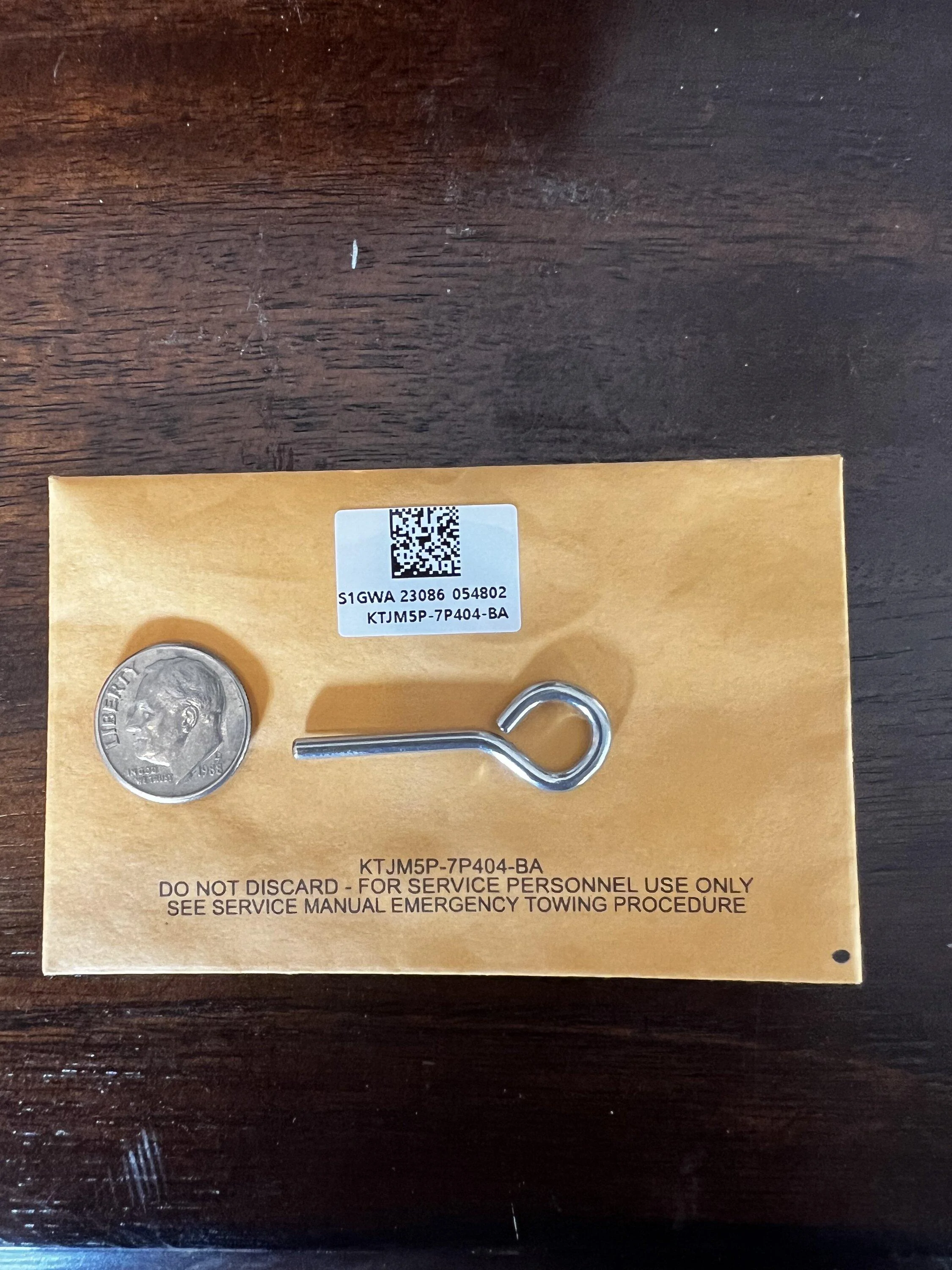

Found this in my new Mav. Any ideas on what it’s for? I’m stumped! (Dime is for reference).
Ford Maverick What is it??? 4BAD818C-A88C-4492-899F-EF6C153095AD

This is from BlueSpec1 posted on March 16th on this forum...
I have the metal pin in my glove box and see the Manual Park Release on the Transmission.

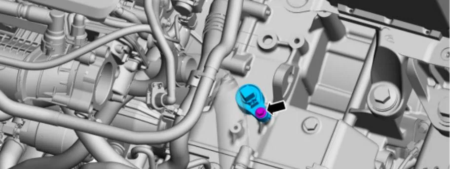

2. Remove the air cleaner.
Refer to: Air Cleaner (303-12A Intake Air Distribution and Filtering - 2.0L EcoBoost (177kW/240PS) – MI4, Removal and Installation) .

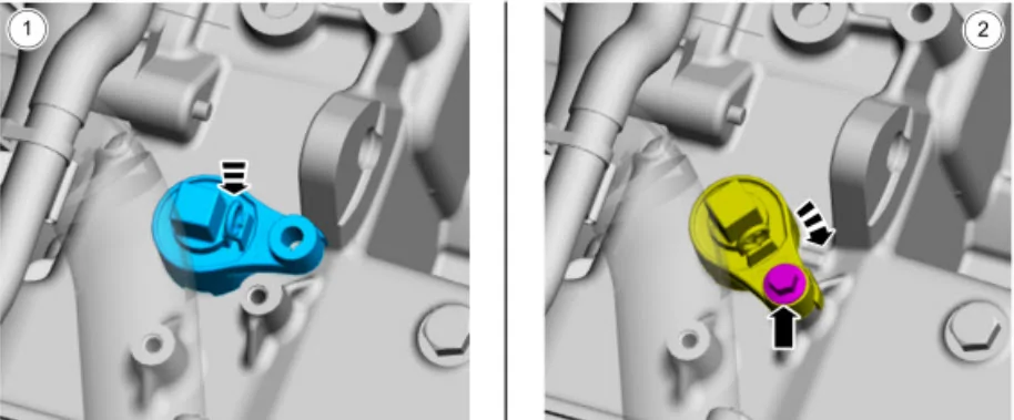

3. Remove the bolt and the manual park release.
Ford Maverick What is it??? ve-manual-park-brake-release-from-transmission-jpg

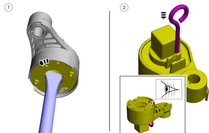

4. Locate the park override pin inside the vehicle storage.
1. Rotate the inner override counter-clockwise until the pin can be installed through the top.
2. Make sure that the component is correctly installed. Use the General Equipment: Flat Headed Screw Driver
Ford Maverick What is it??? park-override-pin-install-rotate-ccw-jpg
1. Install the manual park release into the transmission.
2. Rotate the manual park release clockwise and install the bolt. Torque : 89 lb.in (10 Nm)
Ford Maverick What is it??? reinstall-manual-park-brake-release-jpg
