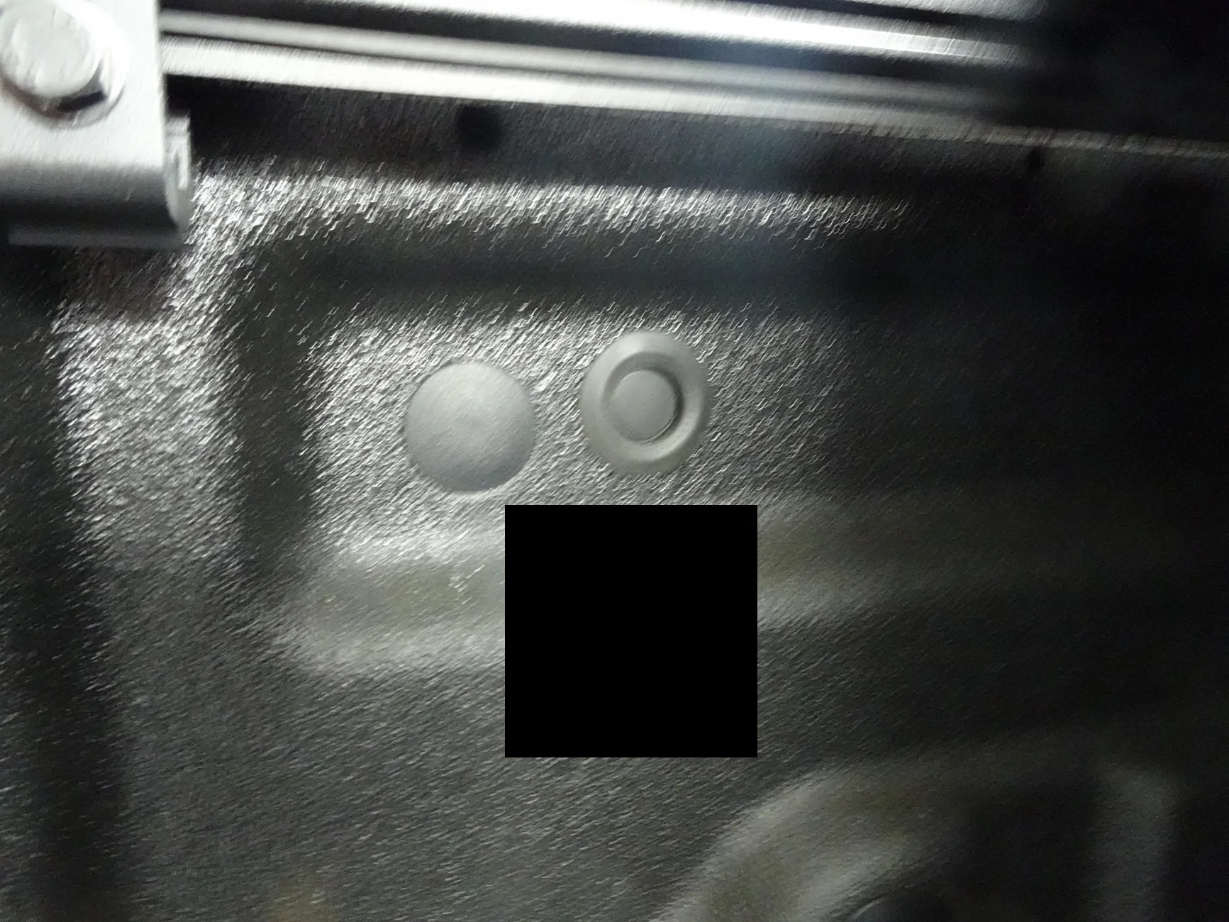

My Mav has 2 types of round plugs in the bed - the soft rubber ones & hard plastic ones, see photo.
I am planning to use one to route wire for bed lights. The rubber plug comes off easily, but are not placed where I want to route the wires.
The hard plastic ones are closer, but they seem to be hard to remove without breaking.
Anybody know what the plastic plugs are for? How to remove them? Thanks.

Those plastic plugs in the bed of a Ford Maverick (including the Tremor) are primarily designed to protect the threaded mounting points for the Ford "FITS" system and other accessories.
The bed is pre-drilled and threaded to allow for various DIY or factory upgrades. The plugs keep dirt, water, and debris out of the threads so they don't rust or seize up. Common uses for these holes include:
Tie-down cleats or D-rings.
Bed extenders or cargo management rails.
Threaded inserts for 3D-printed accessories (the FITS system).
Cancunbadlands
Cancun
Jul 5, 2025
4,434
4,777
Cancun
The Flathead Slide Gently slide a thin flathead screwdriver under the edge of the cap. Twist slightly to pop it up.
The Trim Tool A plastic interior trim removal tool is the safest way to avoid scratching the paint or bed liner.
Pliers (Grip & Pull) If you don't care about reusing the plug, you can grab the head with pliers and pull straight out.

Thanks for replies. Will give it a try to remove, post how wiring project went.
