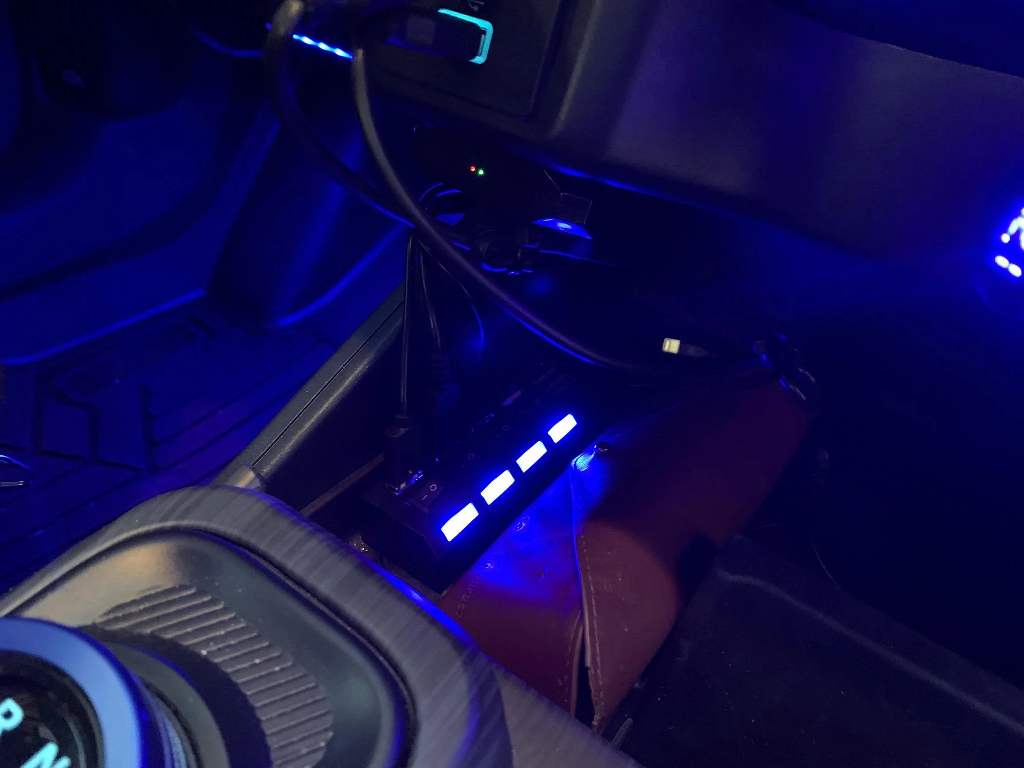

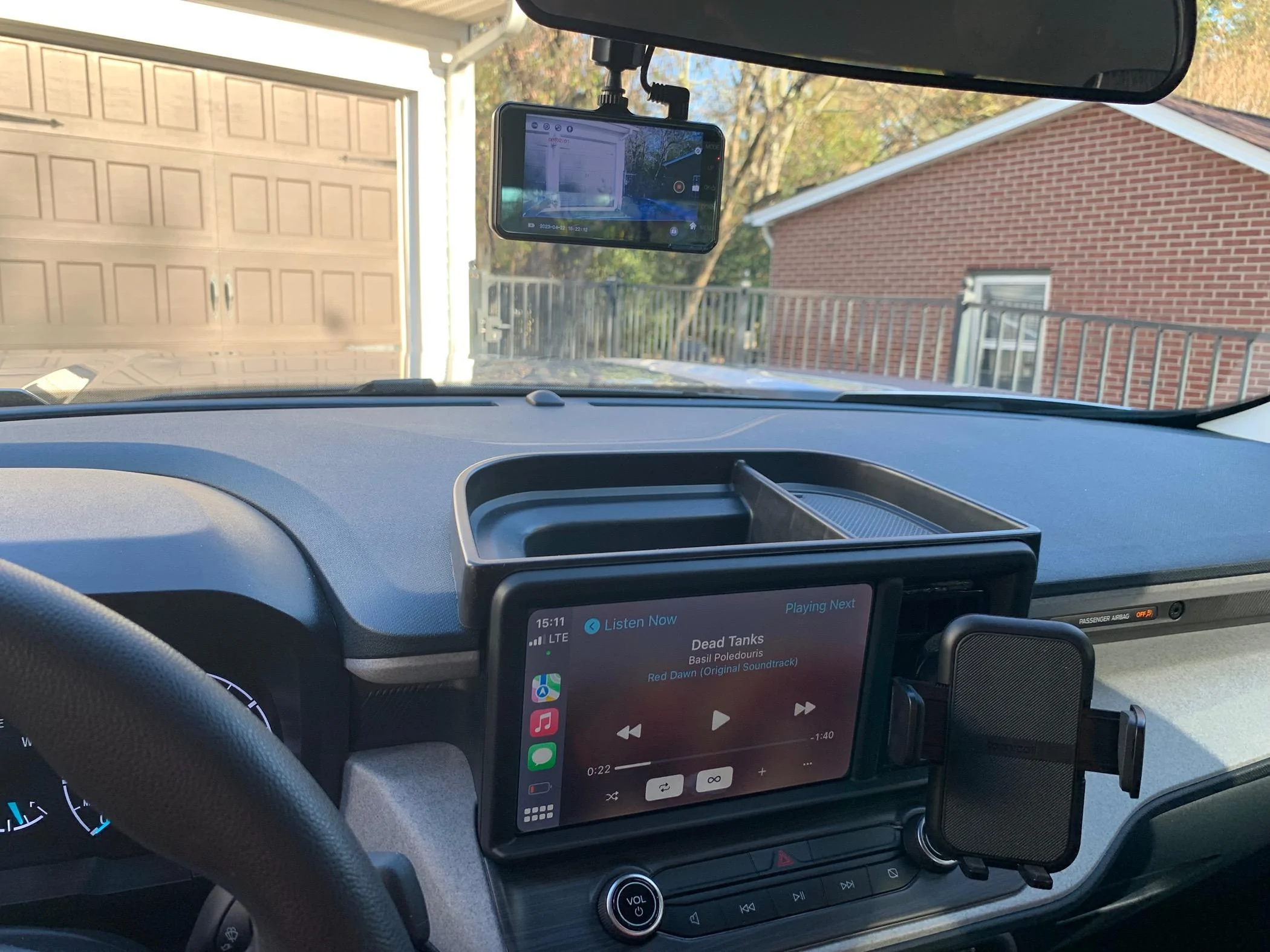

I took the easy way out for hard wiring my interior accessories. My front dash cam, foot well LED Strips, and MPH HUD are all powered from a x4 multi port USB hub. The hub is secured with 3M tape to the center console. They can be had for less than $2. from Temu. I especially like that the ports have an independent switch and LED light to indicate when power is applied. I notched the housing above the mirror to hide the entry point of the dash cam’s power cable. All wiring is hidden following common routing, under the headliner, down the A pillar, and under and across the dash to the hub. One interesting twist, On two occasions I tried a x7 port USB hub. My devices went haywire, When I returned to the original x4 port hub, everything went back to normal. I got the same conflict with two different x7 hubs. Go figure. Questions?
