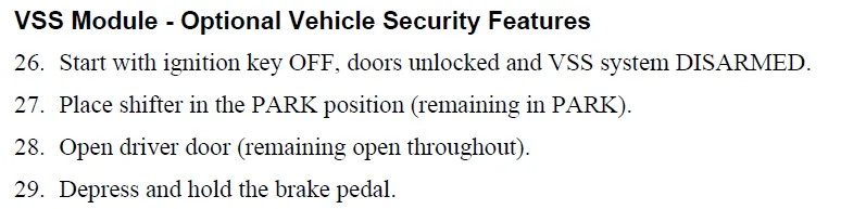

Okay , I finally got it installed. I don't know about other models, but on the hybrid I found it a little different. There is no plug in on the back of the OBD port. Follow the cable form the back of the OBD to the next plugin .You will probably need to cut the zip tie holding several cables together. Unplug the cable there. That port will also look like an OBD port. Turn it around to the backside and you will see a cable with a tab that plugs into it. Release that cable and that is where the security cable plus in, between that plug and where you just unplugged. Now just put everything back together. it's a PITA , but doable. The remote start worked with the fob and the basic alarm worked without doing anything. To activate the sensors see below...

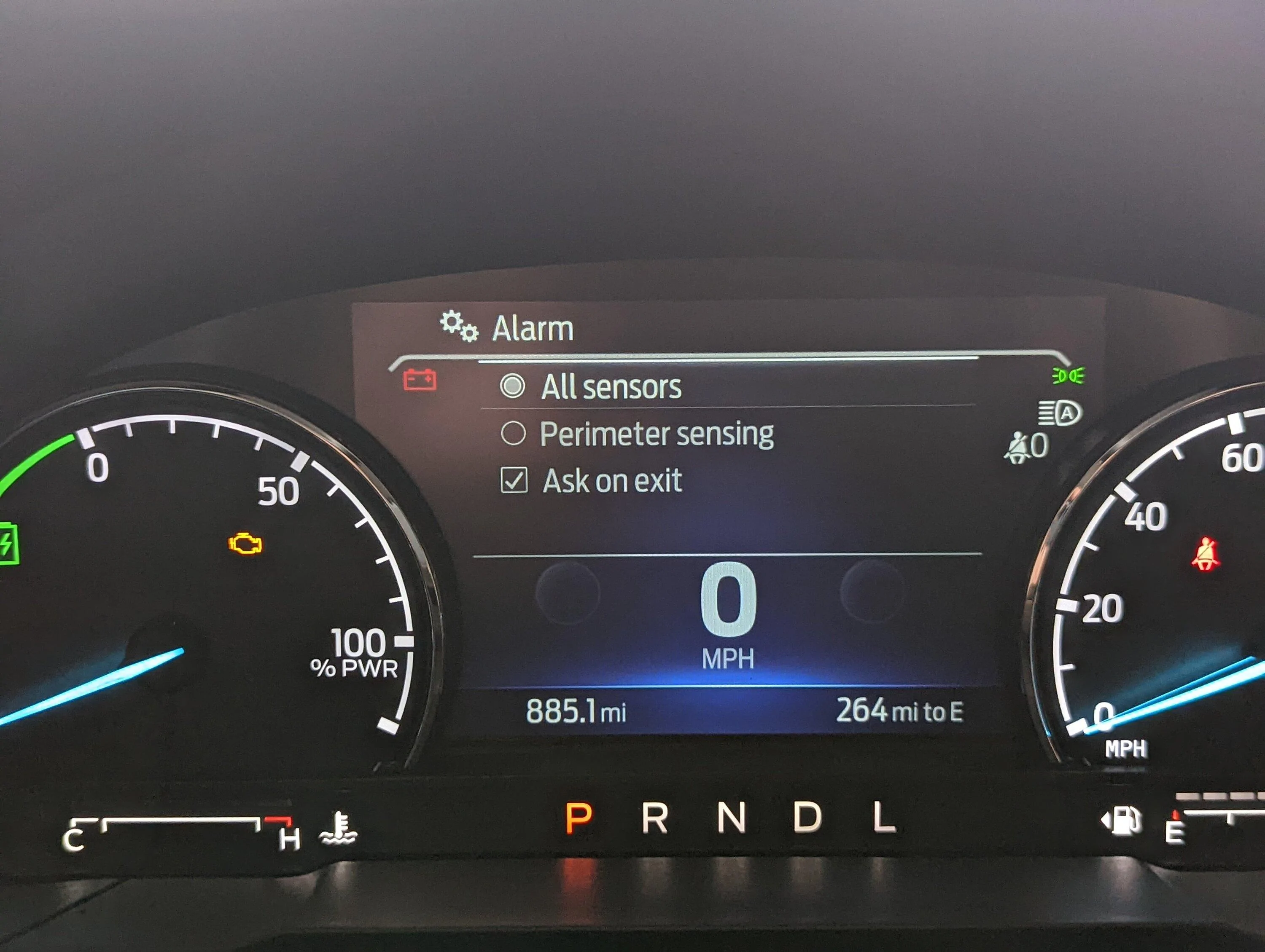

Everything works as it should, but the security display on the cluster display doesn't show. Maybe you need to do something in Forscan to get it to show up. Hope this helps someone
Interesting that it does not have the enhanced security but at least it turns on from the fob
