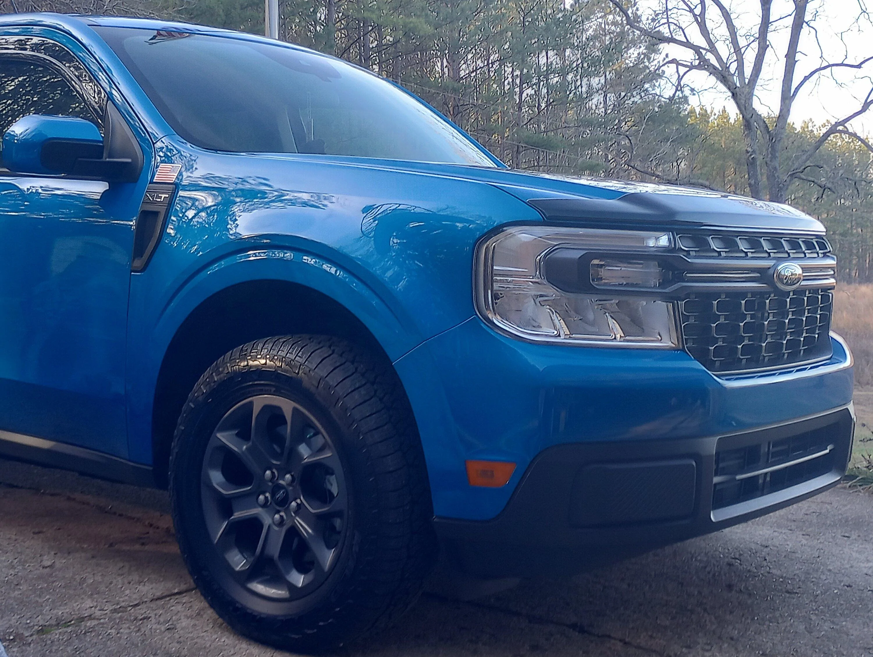

It's kind of hard to tell you 🤔 As soon as I got the truck I put the Wildpeaks on and got rid of those crappy Continentals 👎. Yes that's my tire size 👍🙂
Ford Maverick Upgraded tires good on suspension? IMG_20230109_144810519_HDR
I went cross country to Ca From Tn and back over 75 MPH got 33 MPG on the Hwy. 70 and under got 42 MPH with cruz on . Never did any long term city driving so city unknown. I live in the sticks in Tn curves ,up hill ,down hill ,up and down speed 38 to 39 MPG all the time . Hope this helps
