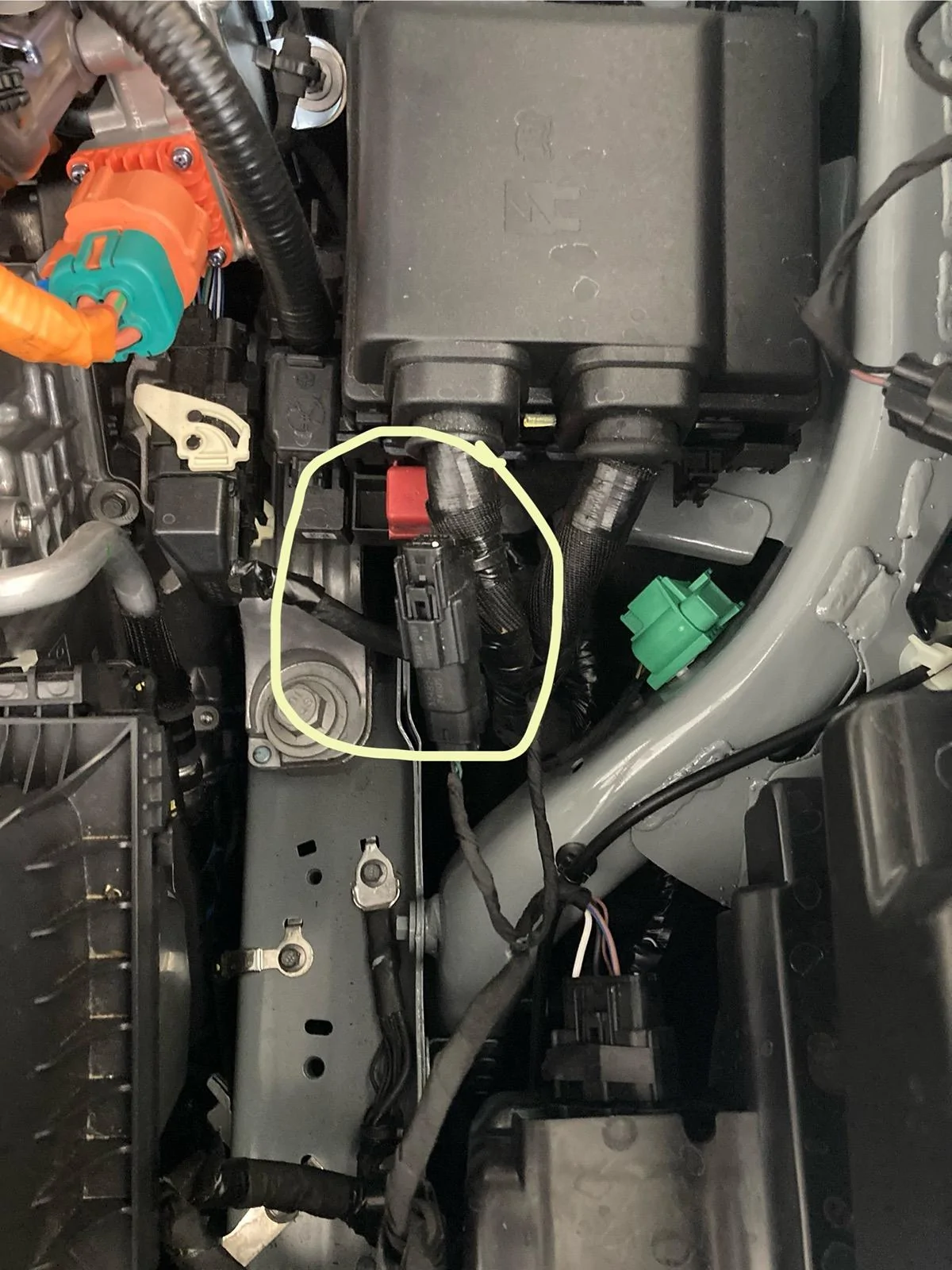

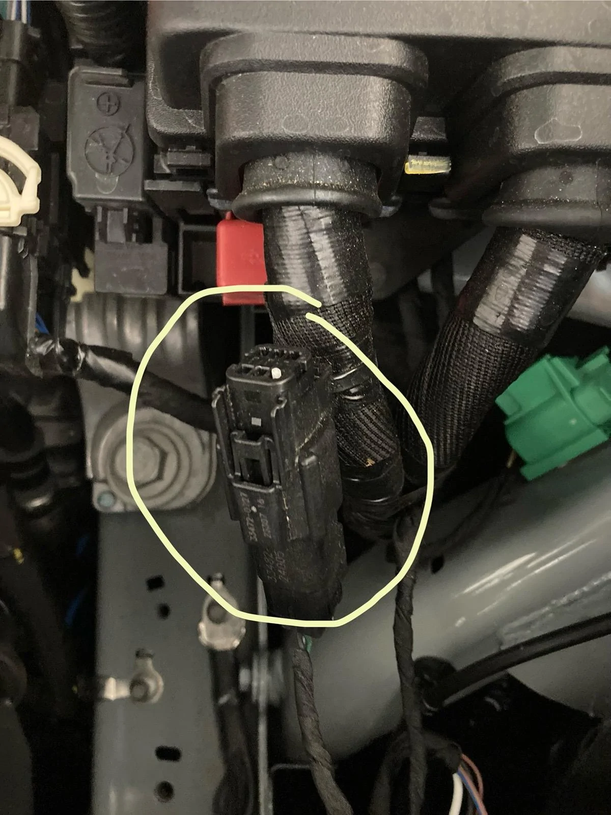

Hi- any ideas about what this connector can be used for?

That other connector is C1026 and labelled simply as 'EVAC and fill' according to the service manual. No reference to it in any of the procedures; possibly used at the factory. Should have three wires going it. The grey-blue and green-orange are HS-CAN Low and High lines respectively. Seems to be absent on yours but on previous MYs there's usually another wire that loops between the male and female halves to act as a retainer for the latter.
