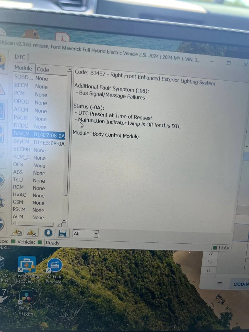

How do I get it to not throw DTCs? Love the look of the amber DRLs

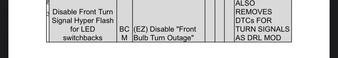

Yeah I am going to pick some up. I just have the back up camera recall fix Monday and reloaded the as-built bcm info because I didn’t want Ford to see the DTCs that the mod creates. In the master Forscan spreadsheet it says this option will remove the DTCs but I didn’t for me. Had to re-load the factory config for them to clear.

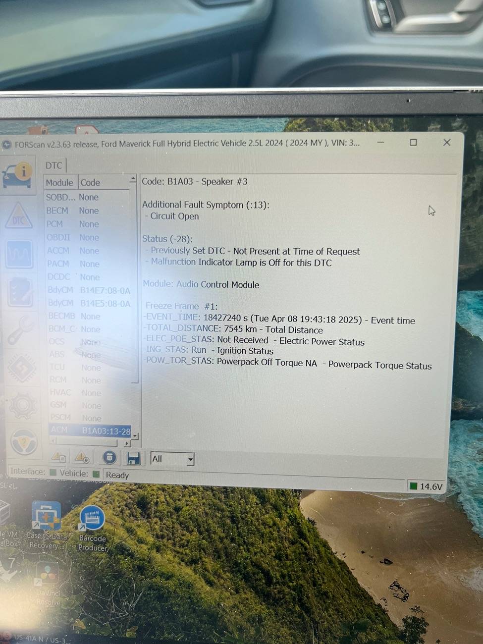

I have some DTCs on mine after making the change, but just ignore them. Got the ACM update for the camera recall, I guess the dealer was nice and didn’t mention a thing about any trouble codes related to the lights.
