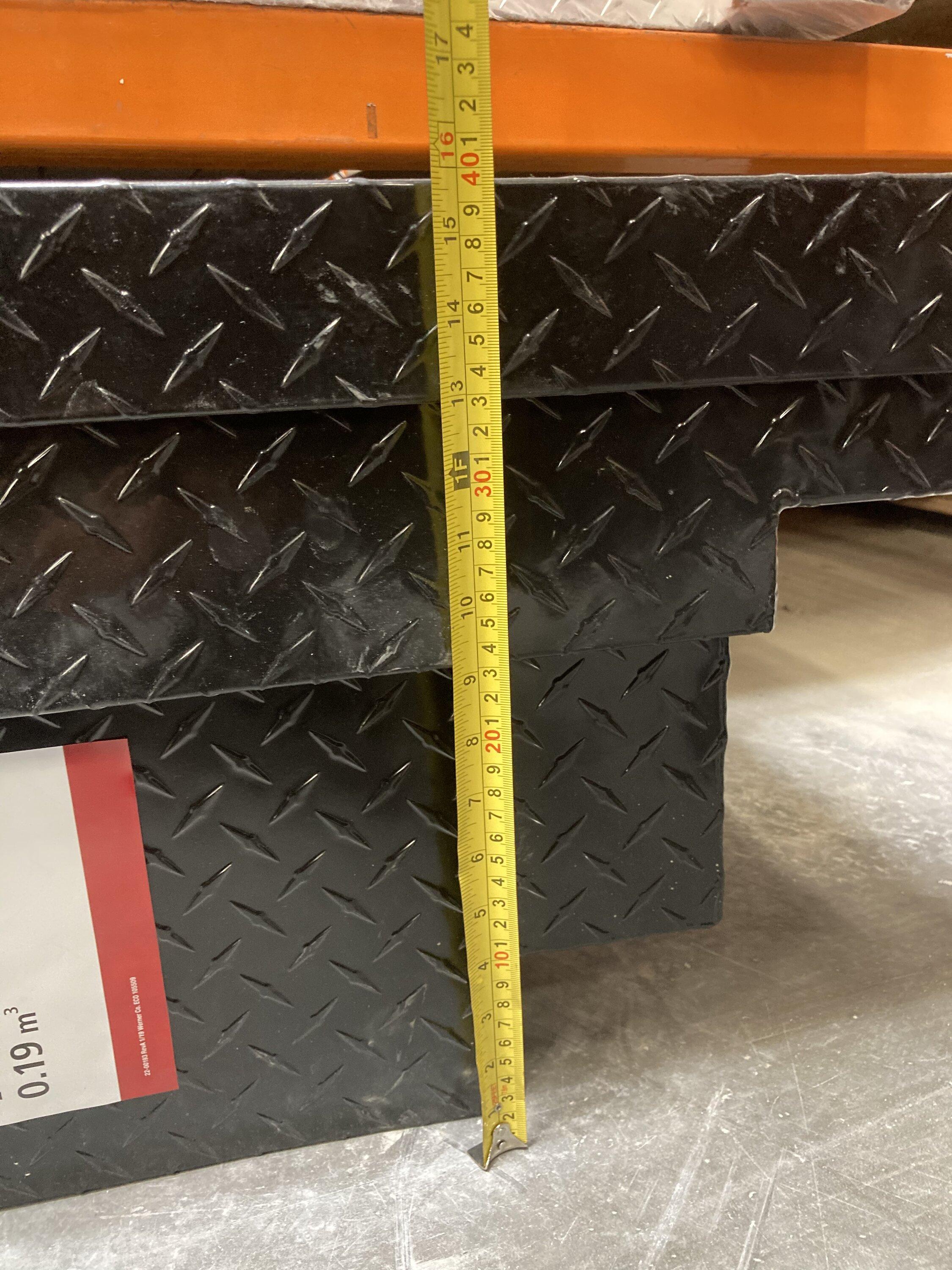

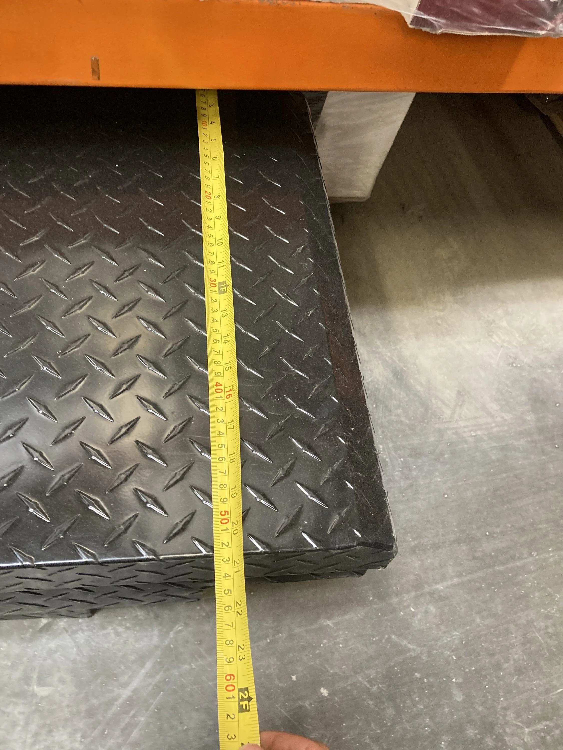

Anyone else shopping for a truck box that fits between the 53" bed rails and over the wheel wells?
Anybody know any that are a good fit without much over the rail height?
I don't think the market has anything to offer yet but plastic swing boxes, as of April 2022.
Post links if you see something that works.
First one to market with a box that fits tight around the rounded corners at the cab to bed interface, and a low profile, will be the stand out.

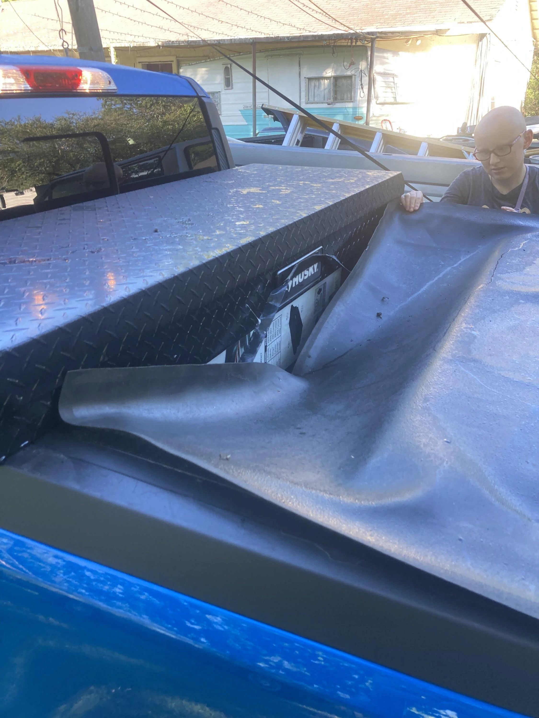

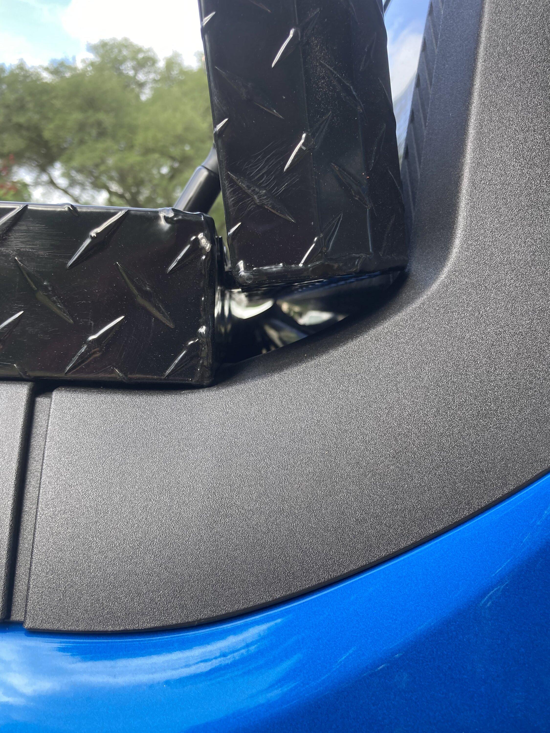

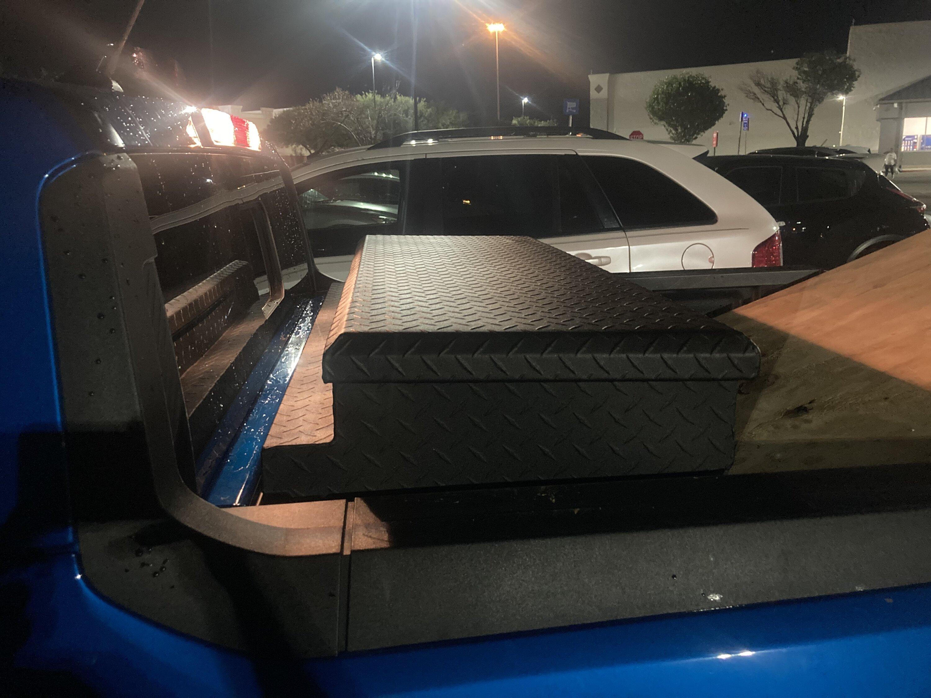

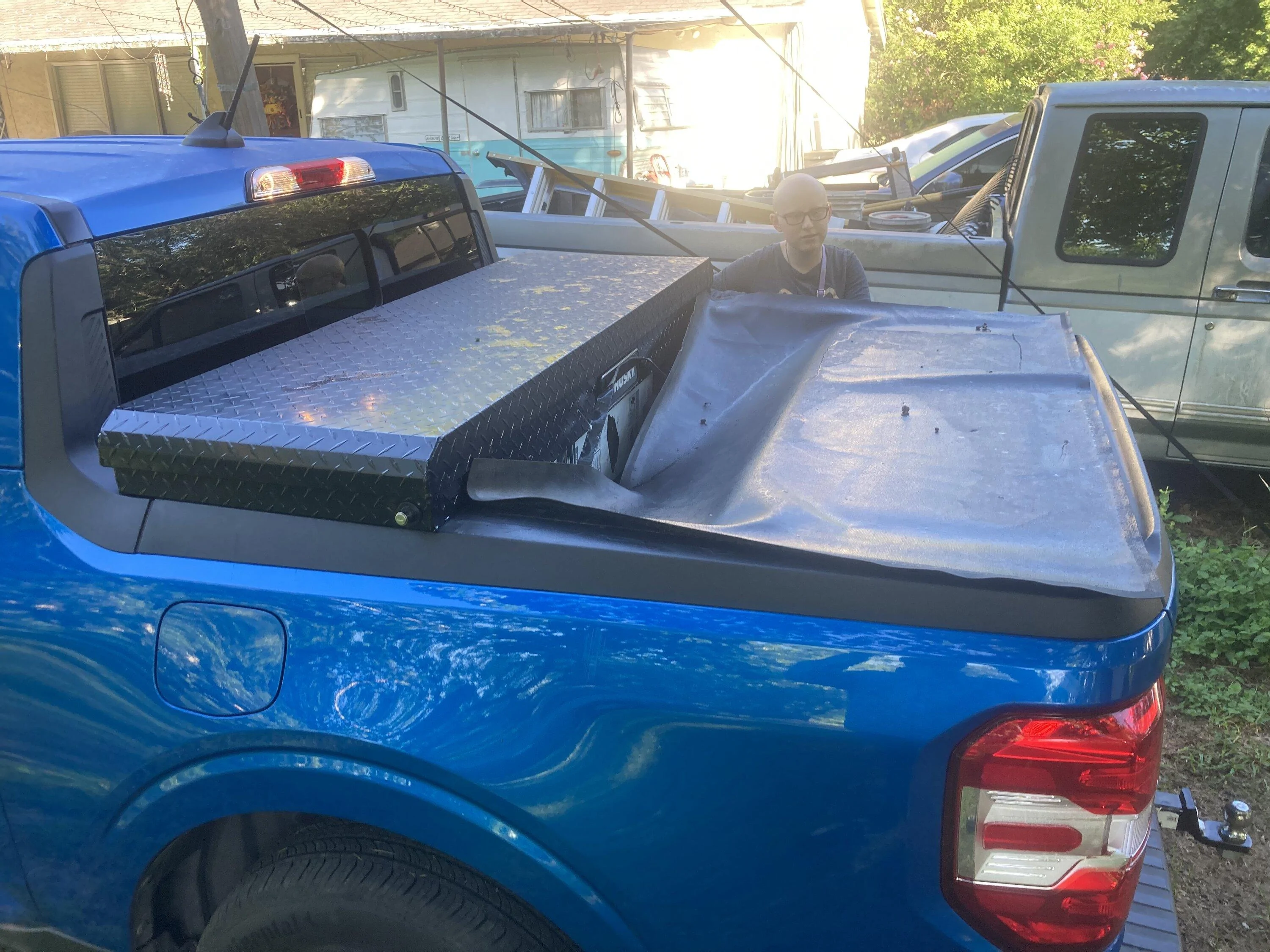

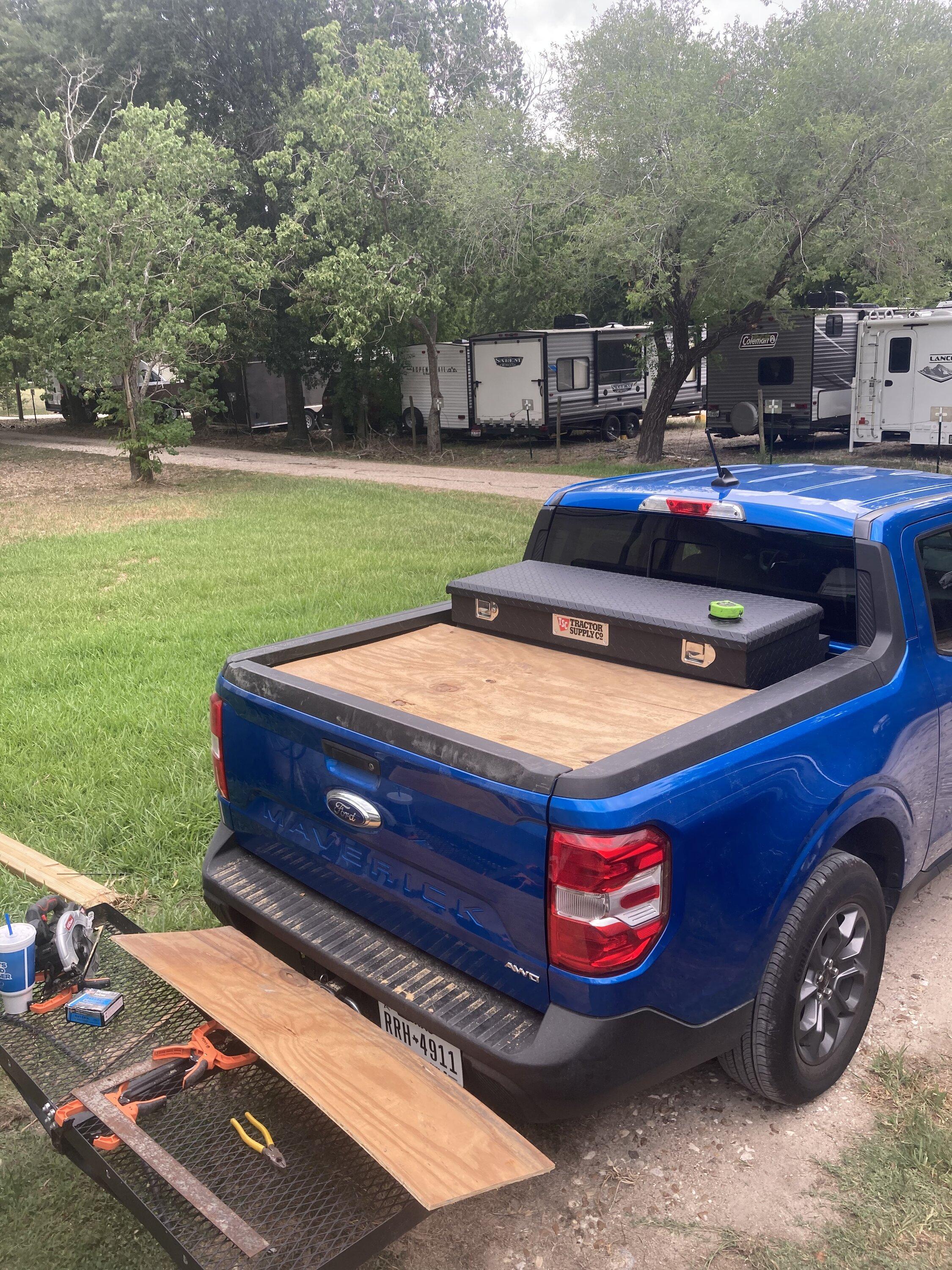

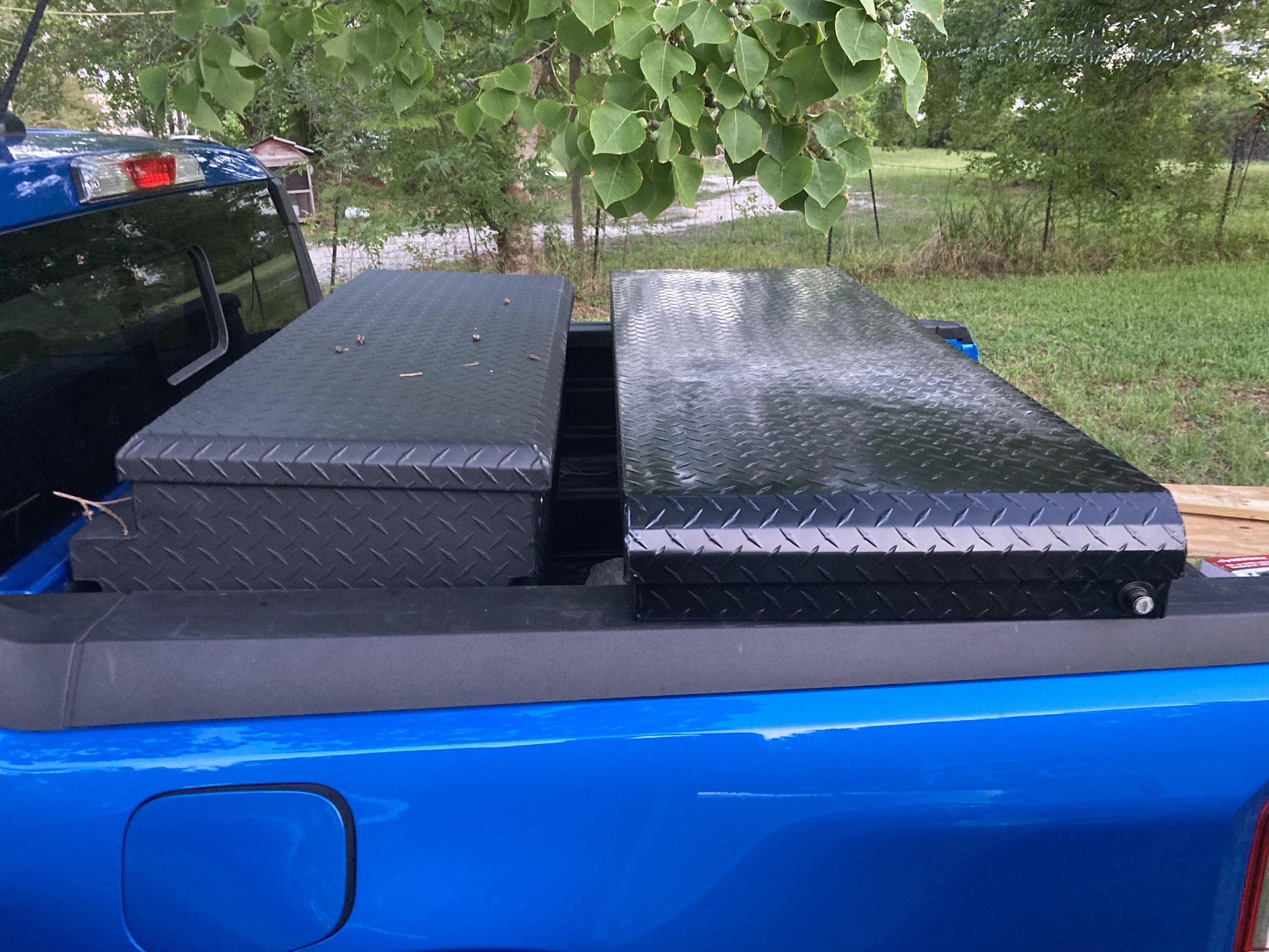

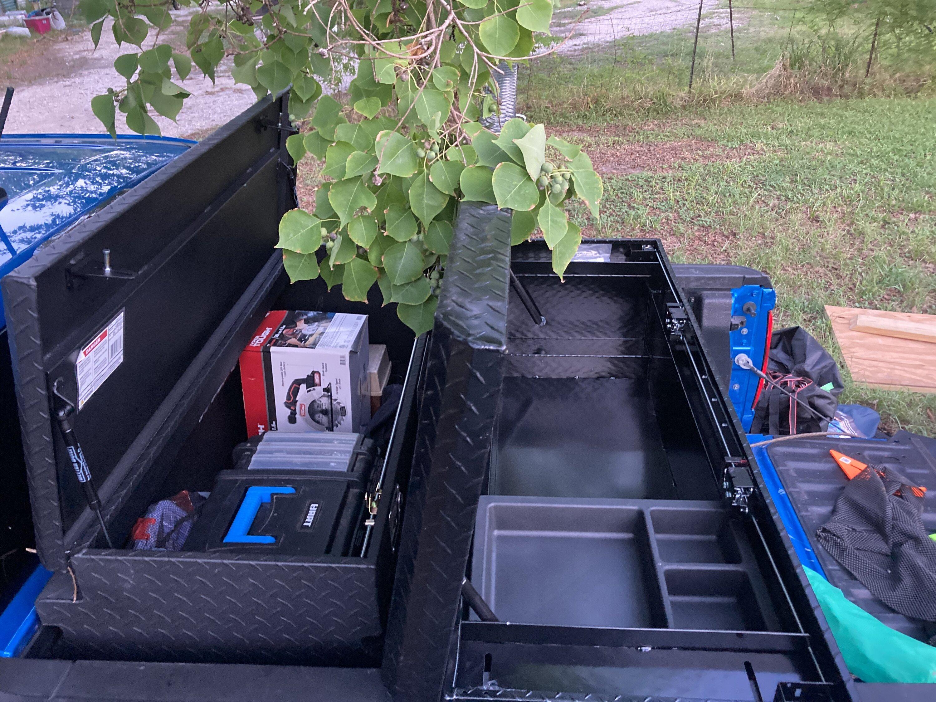

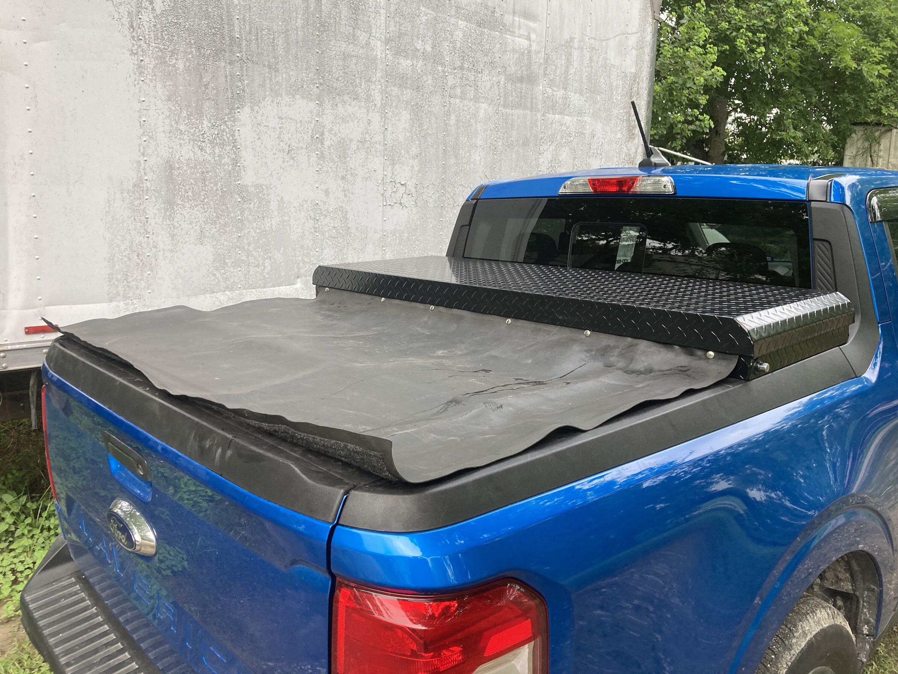

I started with an “in bed box” or “chest” from Tractor Supply Company, that was about 48” wide and had the bottom back edge cropped to fit a full size truck wheel well up against it. It was basically lost space in the Maverick. It also sat on the wheels and when I accelerated it occasionally fell / rotated onto the sloped side so I ran a 2x6 under it in the groves for the horizontal board in the wheel well and bolted it down. that stopped the tipping over.

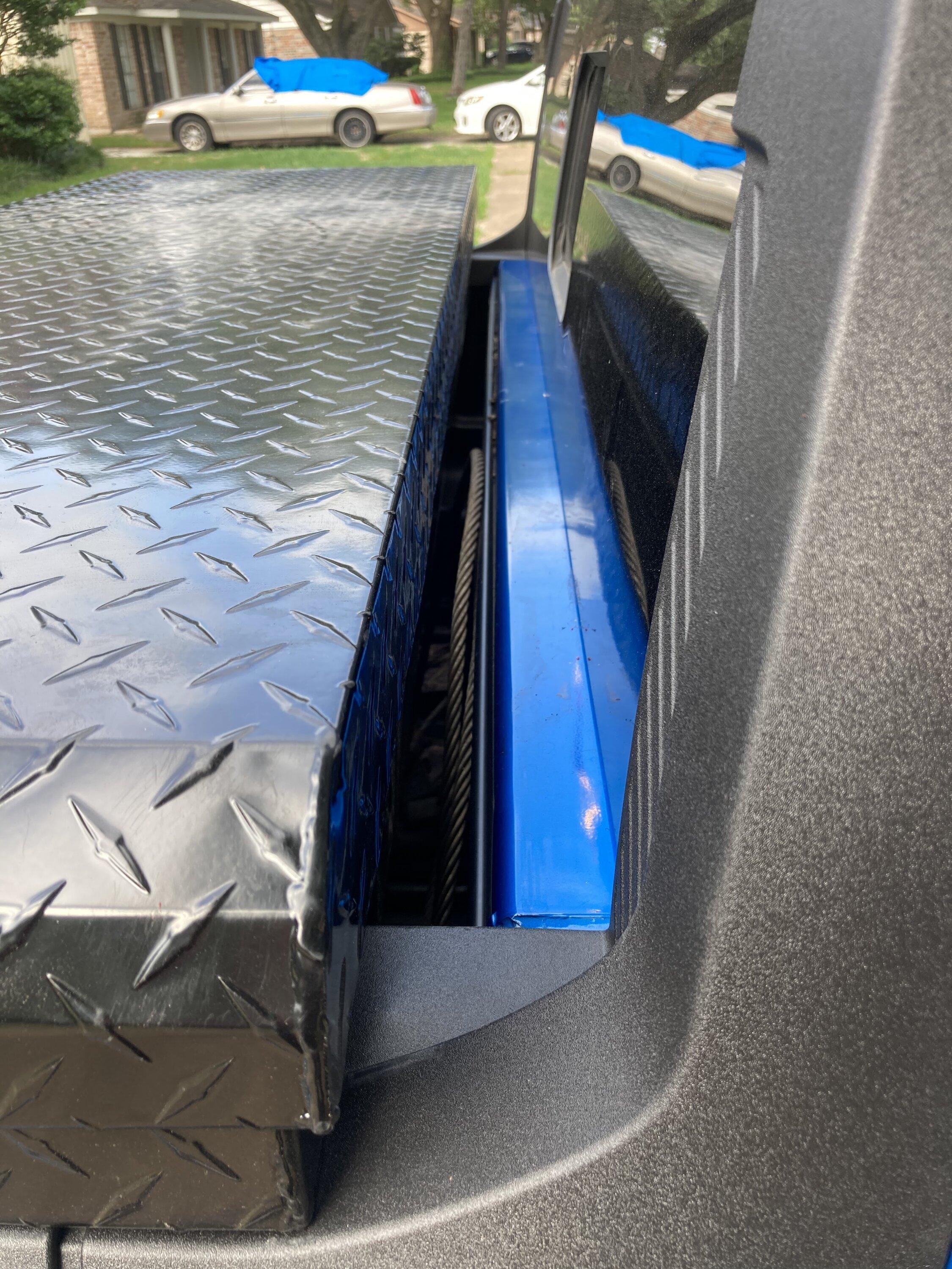

Then I can across this Husky box from Home Depot that fills out the bed much better and is a couple inches above the wheel wells, so I can slide a couple sheets of plywood underneath. For those reasons I prefer it. so I moved the chest to the neck of the bed and it sits down inside the bed nicely. It can be slid in and out as needed if it’s not loaded too heavy.

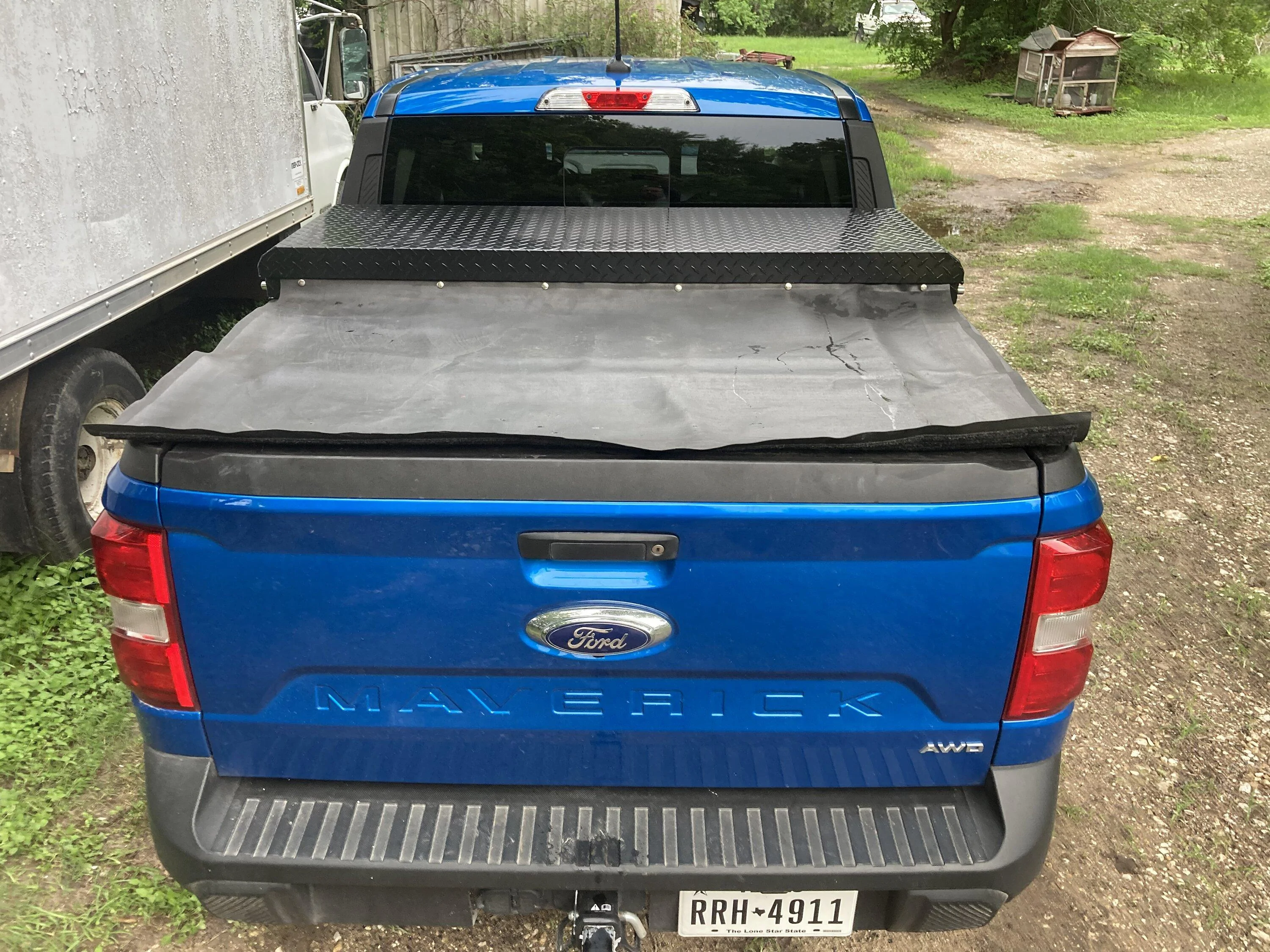

I started working on a cover after that.
I got a $20 3’x5’ floor mat from Home Depot that fits great. it’s texture works with Velcro so I put strips of Velcro (adhesive) on the bed rails to keep it down. Only problem is the edge on the box kept falling and it’s really hard to adjust its positioning while it’s sticking as soon as it touches down.
I moved to snaps. Still working on perfecting this as the snaps ripped through the mat. Any suggestions?

Maybe fender washer between snap head and mat. Or maybe thinner metal if fender washer too thick. Could be whole length of mate as you prefer?

good idea, I even thought about a piano hinge, but couldn't get it flat against diamond plate. So I got a piece of aluminum flat bar and new set of snaps and a new mat. I'll try drilling the flat bar and installing the new snaps through the aluminum and rubber mat and see if that stops the snaps from ripping through the rubber mats edge.

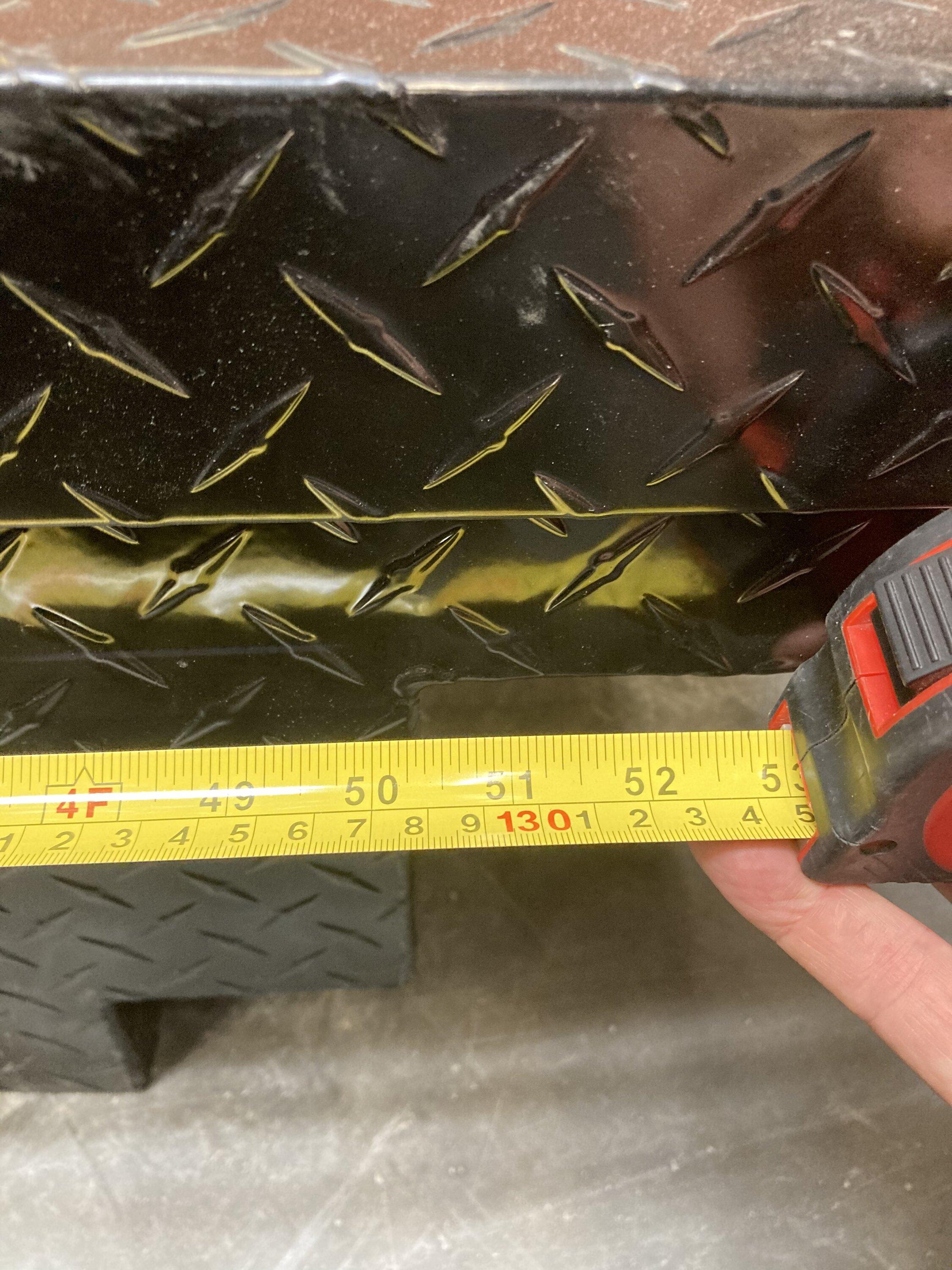

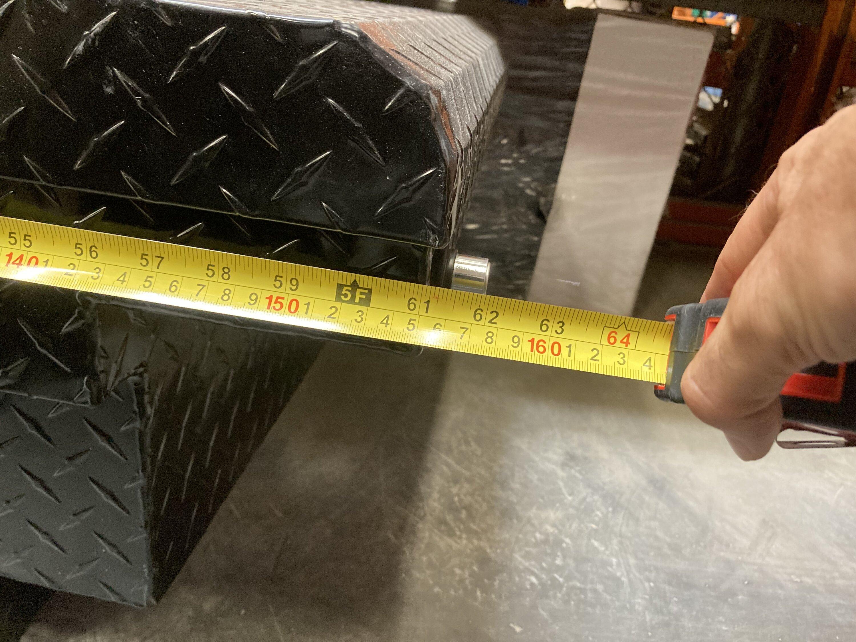

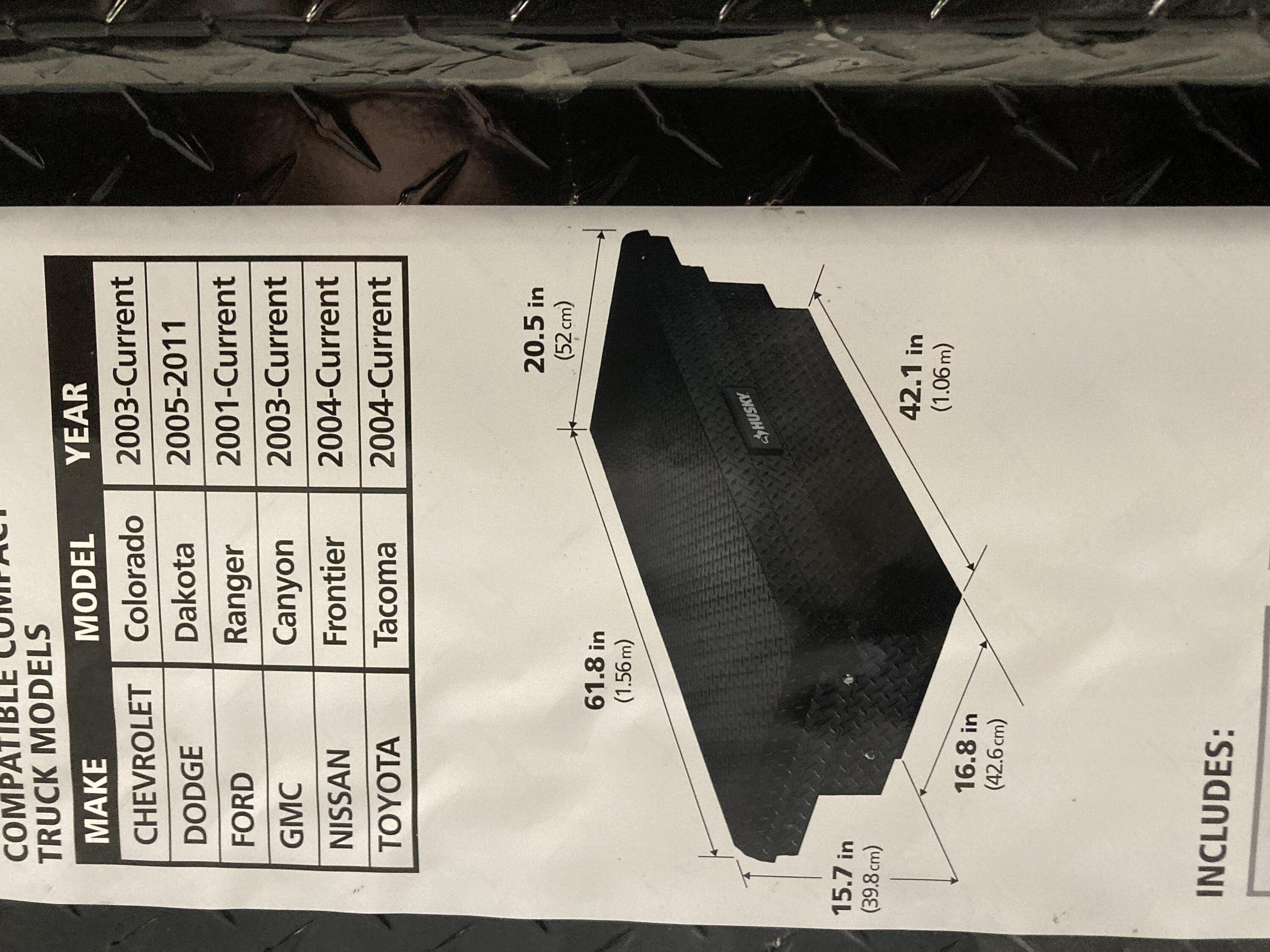

Husky 61.86 in. Matte Black Aluminum Low Profile Mid-Size Crossbed Truck Tool Box 102102-53-01 - The Home Depot $359 shown below
Tractor Supply 48 in. Chest Truck Tool Box, Textured Matte Black, 103408-52-01 at Tractor Supply Co.
This $350 one is in the pic of this box mounted in the bed over the wheel wells, screwed down to a 2x6 running under it to keep it from tipping over. I've used both by turning this one backwards and putting it in the back half of the bed just for more lockable storage.

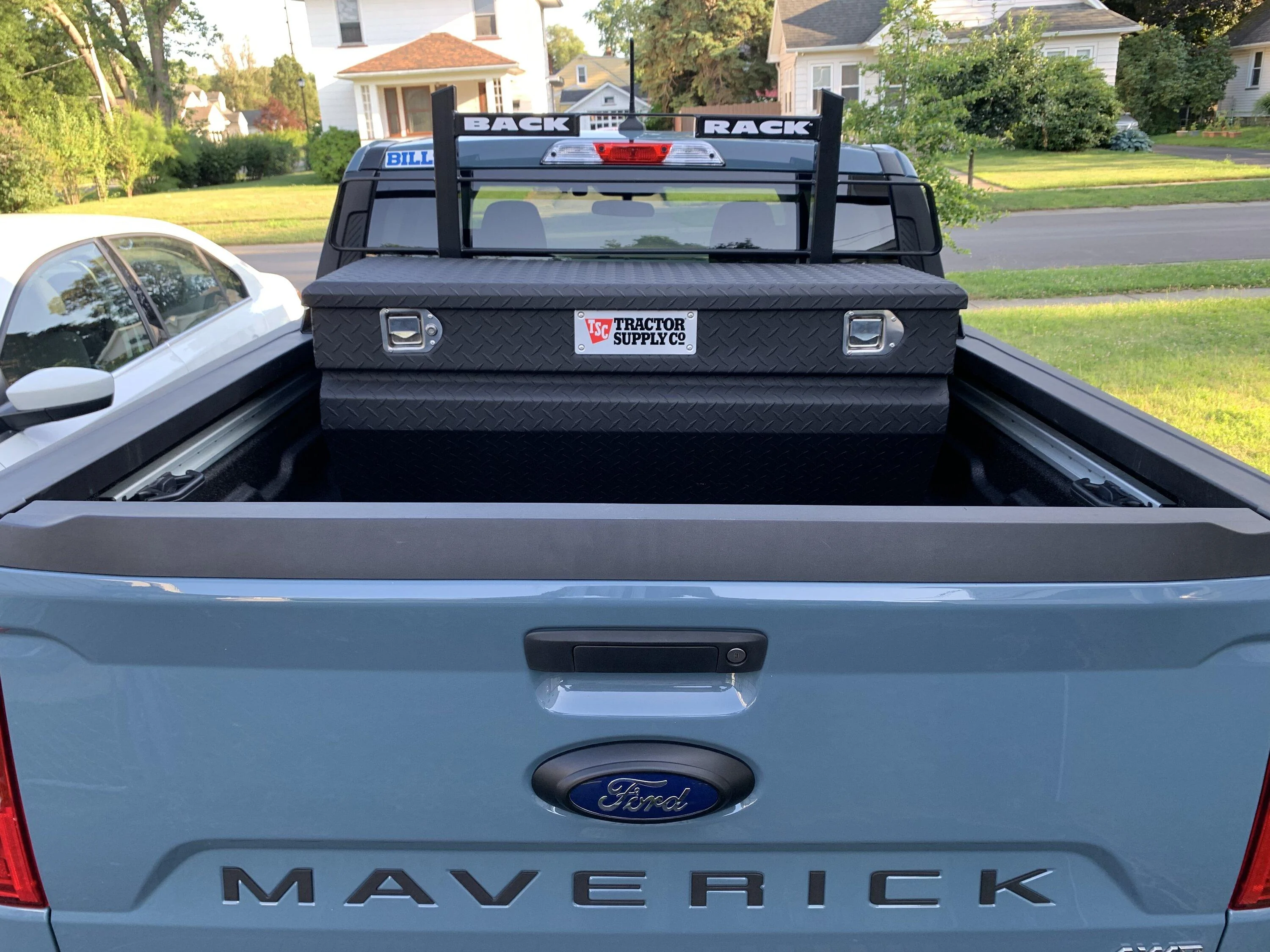

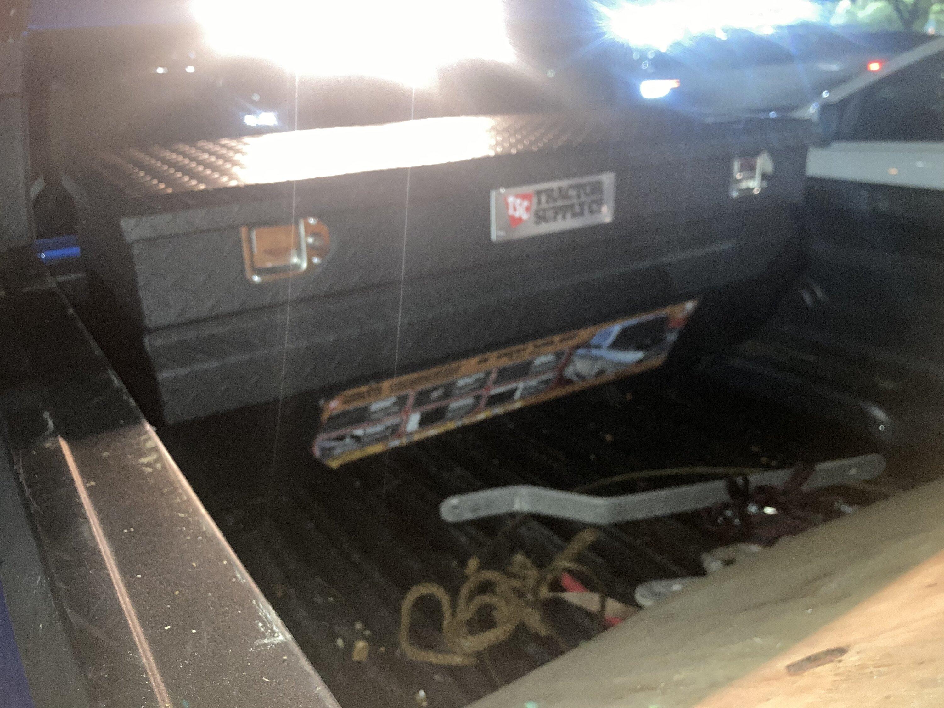

Here’s the Tractor Supply 48” tool chest. I built a hard cover to sandwich over the opening too.

How did you secure this chest to the bed? What size screw/bolt did you use? I’ve purchased this same chest and want to secure it using the predrilled holes that are inside the section a 2x6 sits in. I’m unsure what type of screw/bolt I need to effectively secure it to the bed frame with the 2x6 board on top of the bed liner.

I don't think I ever got around to screwing it down. You're right that screwing it to the 2"x6" wouldn't prevent anyone from picking it up. The 2"x6" didn't actually support the weight, the 48" tool chest rested on the wheel wells.
I can't tell you how much MORE I prefer the over the rail box I got from Home Depot by Husky. It has J-hooks to attach to the rails and can't get stolen. It also is better that the TSC chest because the Husky leaves a gap between the top of the wheel wells and the bottom of the tool box. So I can still slide 4'x8' sheets of lumber/sheetrock in between them all the way to the front of the bed.
If you haven't drilled the TSC tool chest yet, see if you can get a refund and buy the Husky from Home Depot.

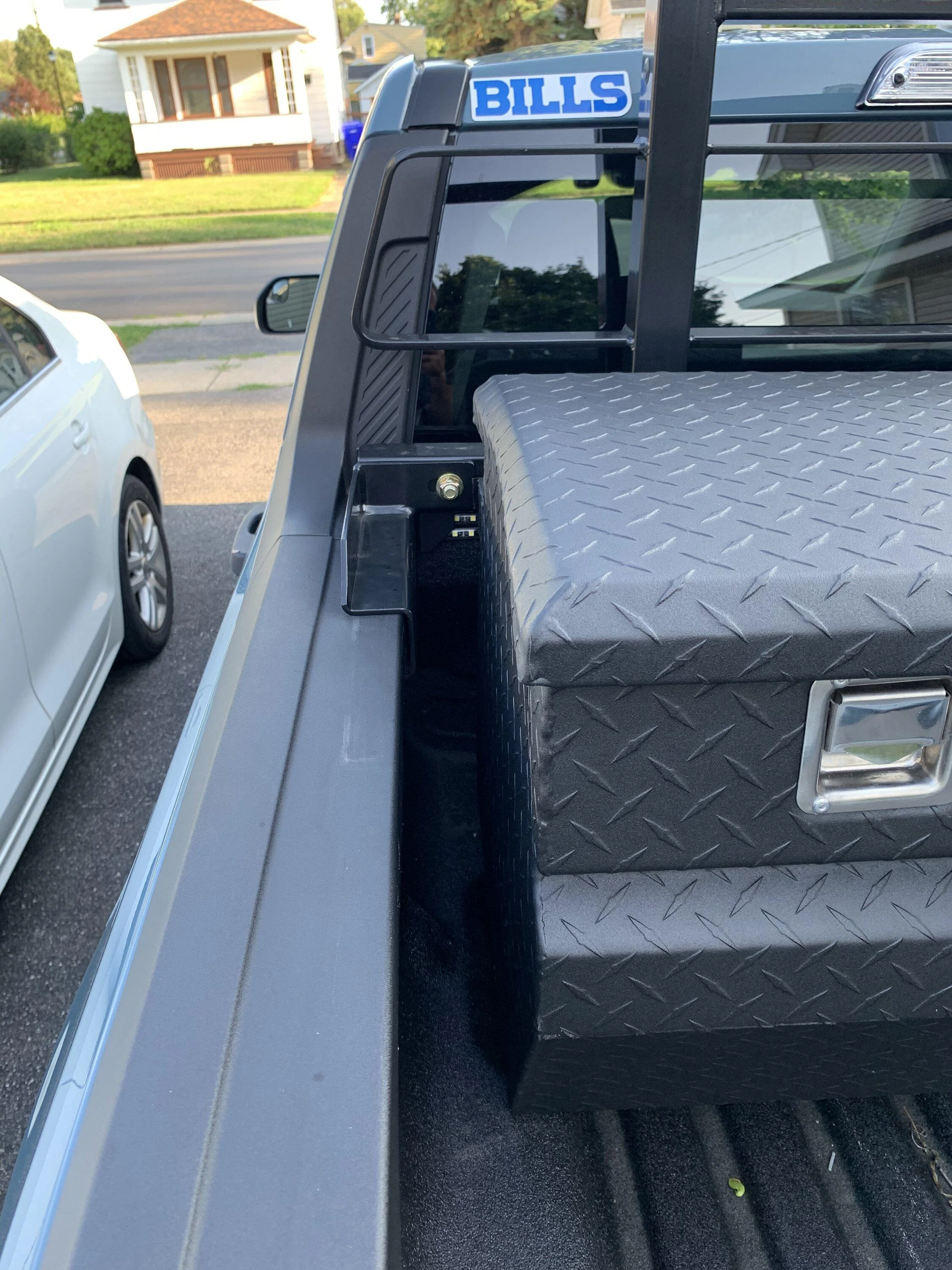

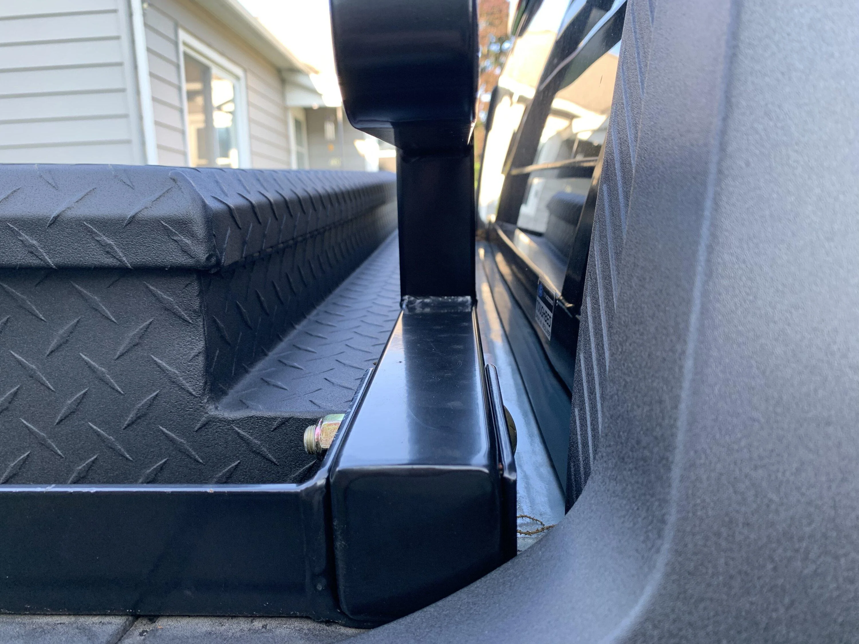

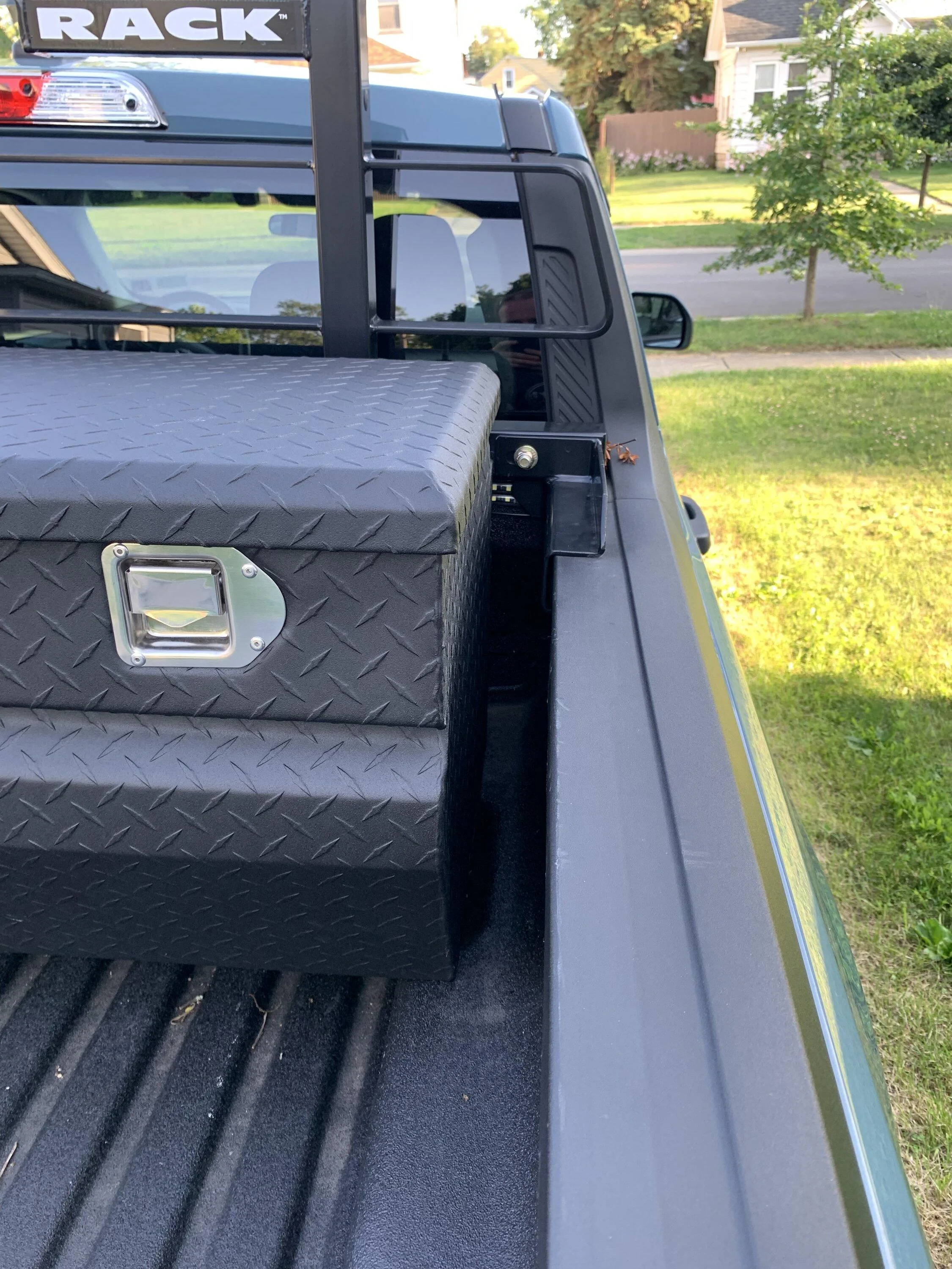

This wasn’t the particular headache rack I wanted, but it was the only one I could find with a guaranteed fit on the Maverick before purchasing (also the only black option available at the time) I was skeptical on this toolbox/backrack combo at first but it’s worked well so far. The extra length on the bolts under the 2x6 will eventually be a loading issue, but can always cut them down when the time comes.
Bolted each end of 2x6 to the truck bed through the existing wheel well holes - then put 3 bolts through bottom of tool chest to secure it to the 2x6. I would’ve preferred a slimmer profile toolbox to maximize load space, but I need tools/accessories locked and stored more than I need loading space.

That rack is perfect for leaning stuff forward like ladders. Nice find @GduB !
