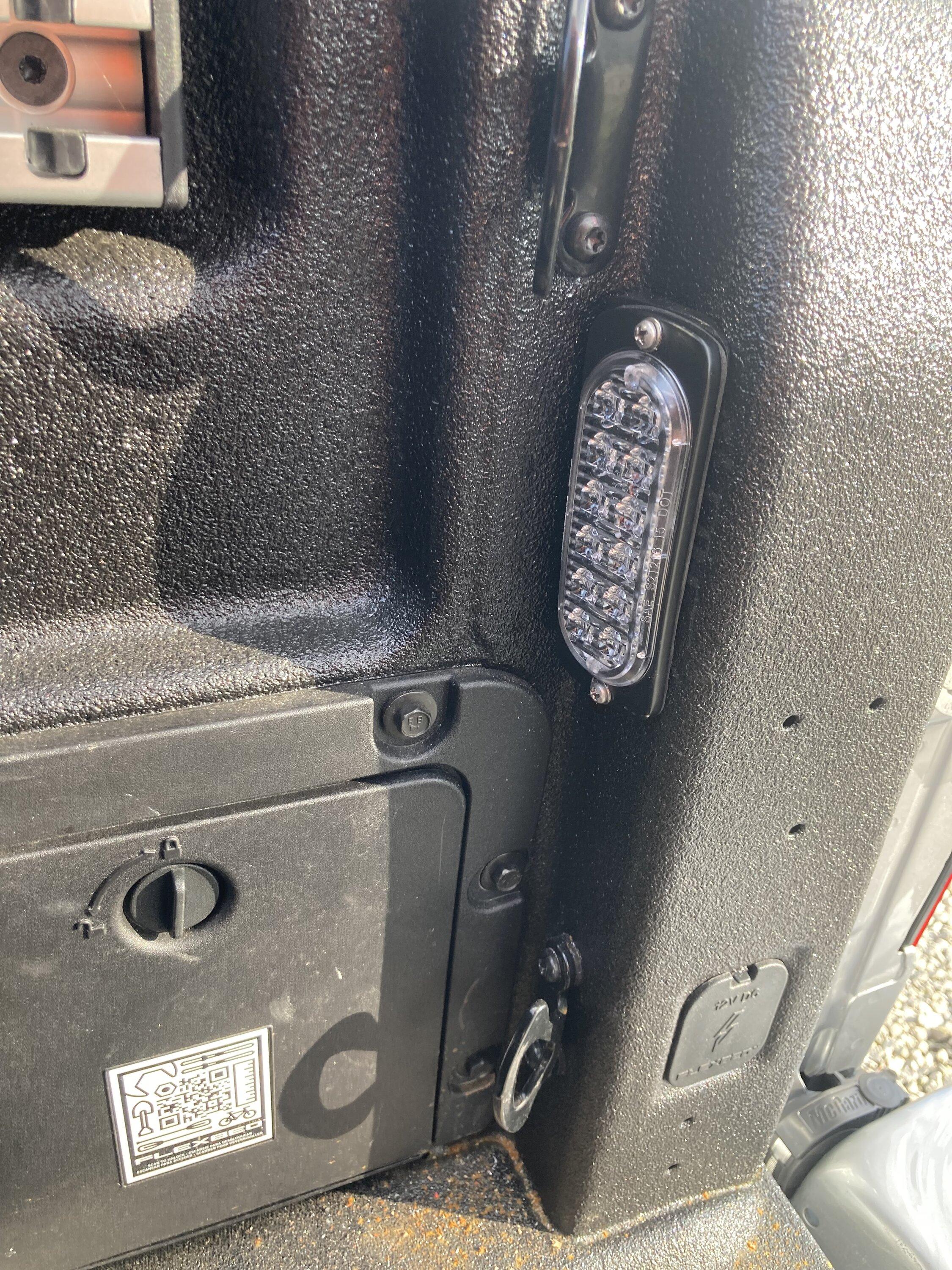

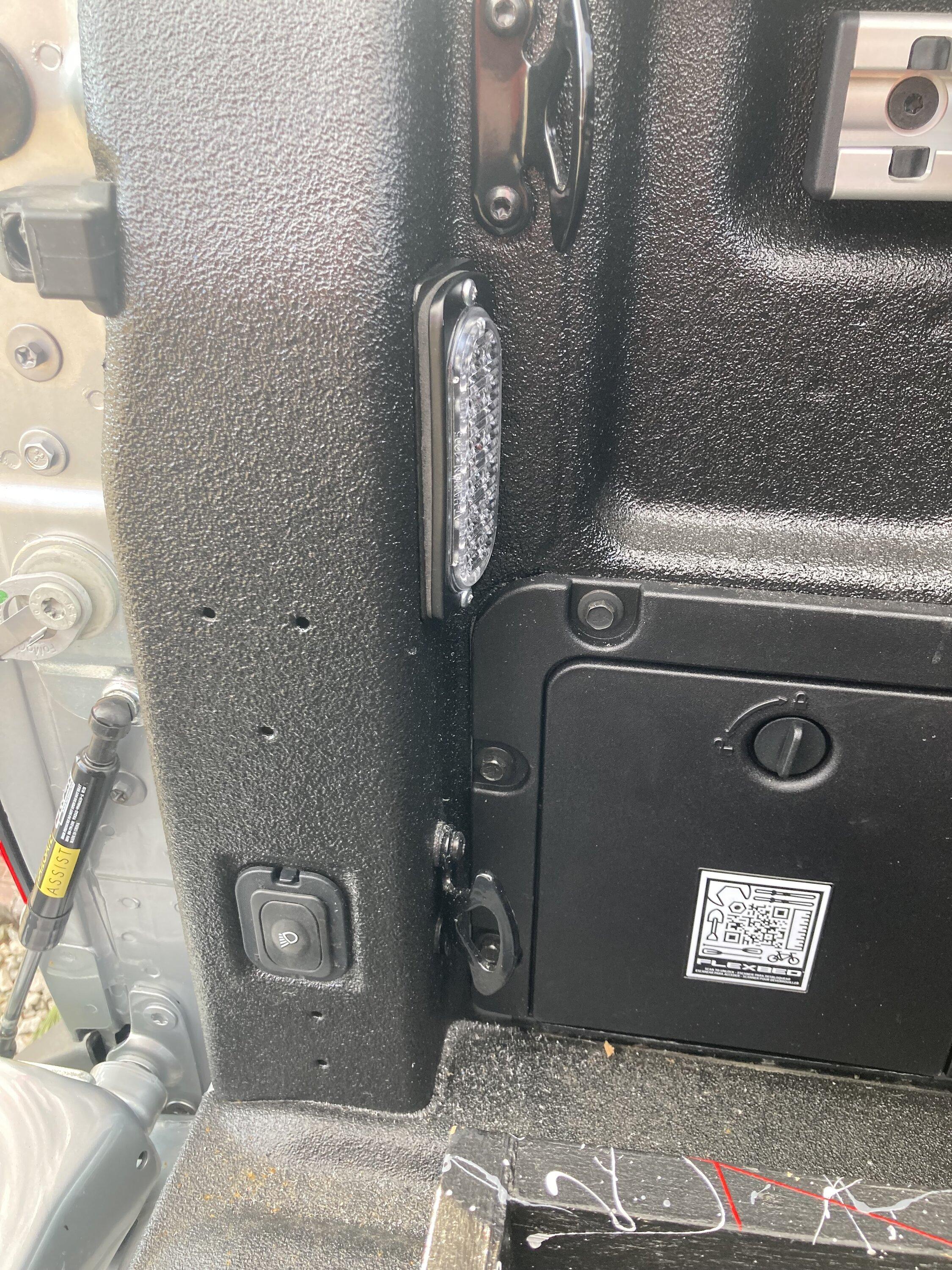

you have XL, XLT, or Lariat? Wondering if you have the OEM light/switch in the bed of the truck already? I have XLT with the OEM light/switch, and put in a bed cubby on the driver's side, so I lost the light. I used the OEM light and switch to run the bed lights I put in the bed, made it real simple, just plugged into the light wiring. Used the 12v pigtail that came with the truck. here is a link to the lights.

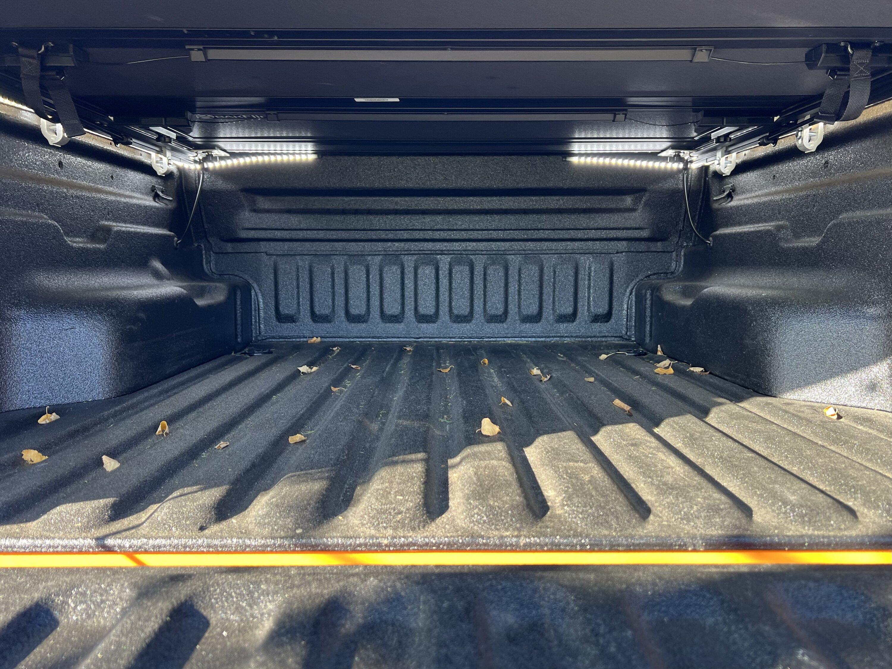

I fished the wire end from inside the bed through a convenient hole above the tail light. Having a spray-in bedliner and bed rails for Elevate Rack and a hard folding tonneau made affixing the strip light tape very slow going. I took my time and cleaned the surface as I moved to make sure I had good adhesion. When I got to the front of the bed, I chose not to cut the strip, but to continue to keep the strip intact.
I repeated the process on the passenger side and ran the connection underneath between the spare tire and bumper to the driver side wires. I then used the placed the shrinkwrap over the wires then used the solderstick to join the wiring to the pigtail and heated the shrinkwrap to finalize the connections.
Finally, I connected the pigtail to the Flexbed connector and started the truck and it worked!
